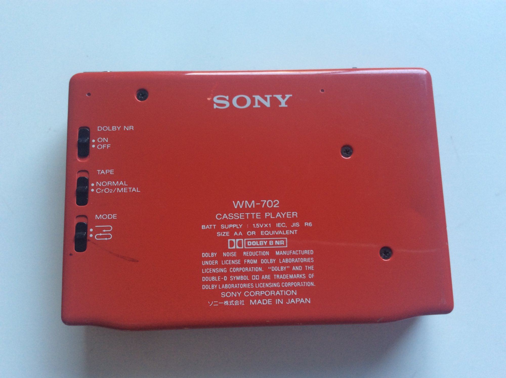

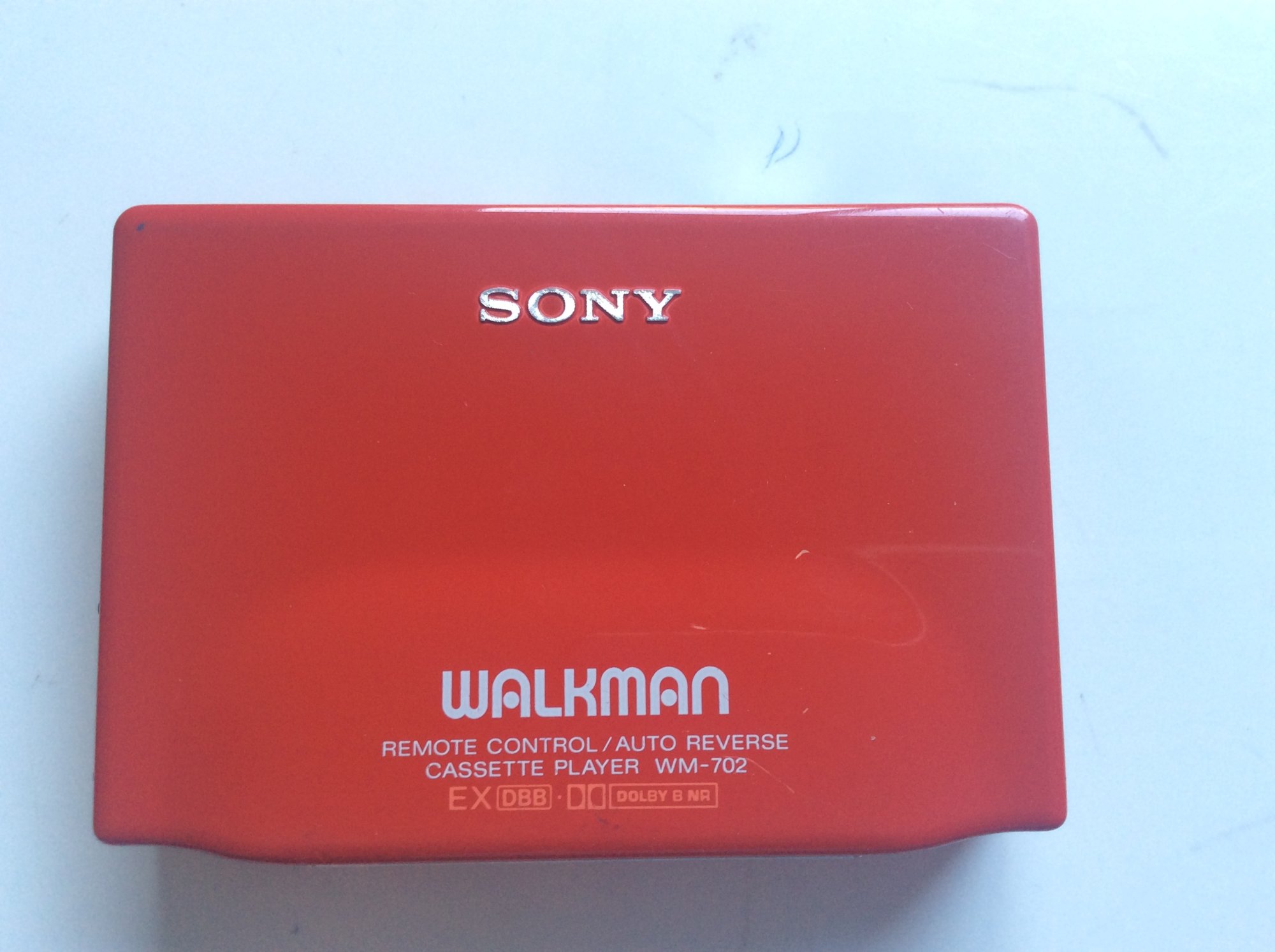

    I have just received a Sony WM -702 which I consider is an unusual find as the unit is a red one which is fully functional, It came with no accessories but I have these available when I can dig them out . It seems to be in full working order with some small dents on the back nd some others slight blemishes. Here are a couple of photos . Has anyone seen this colour before or have such a unit?

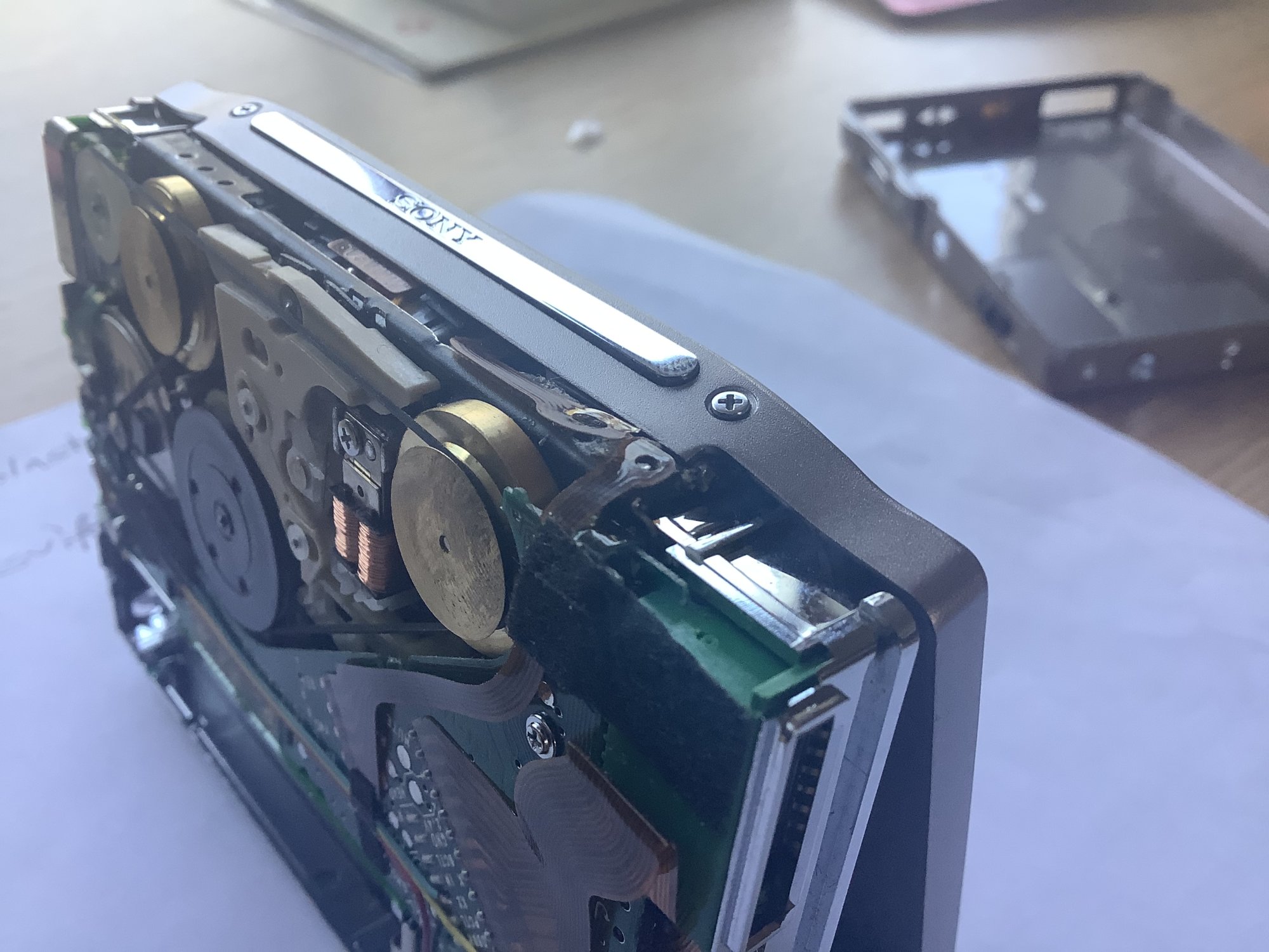

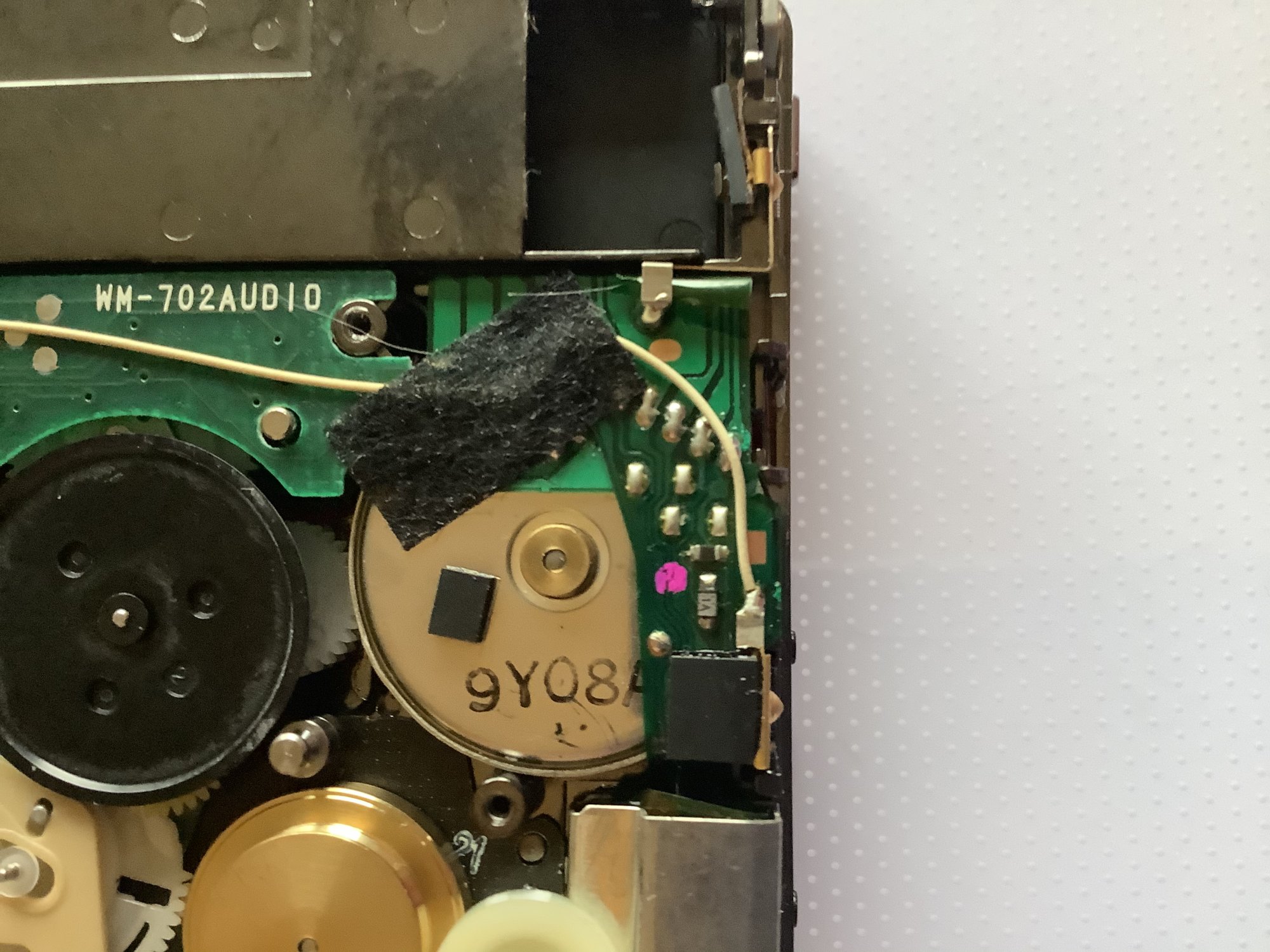

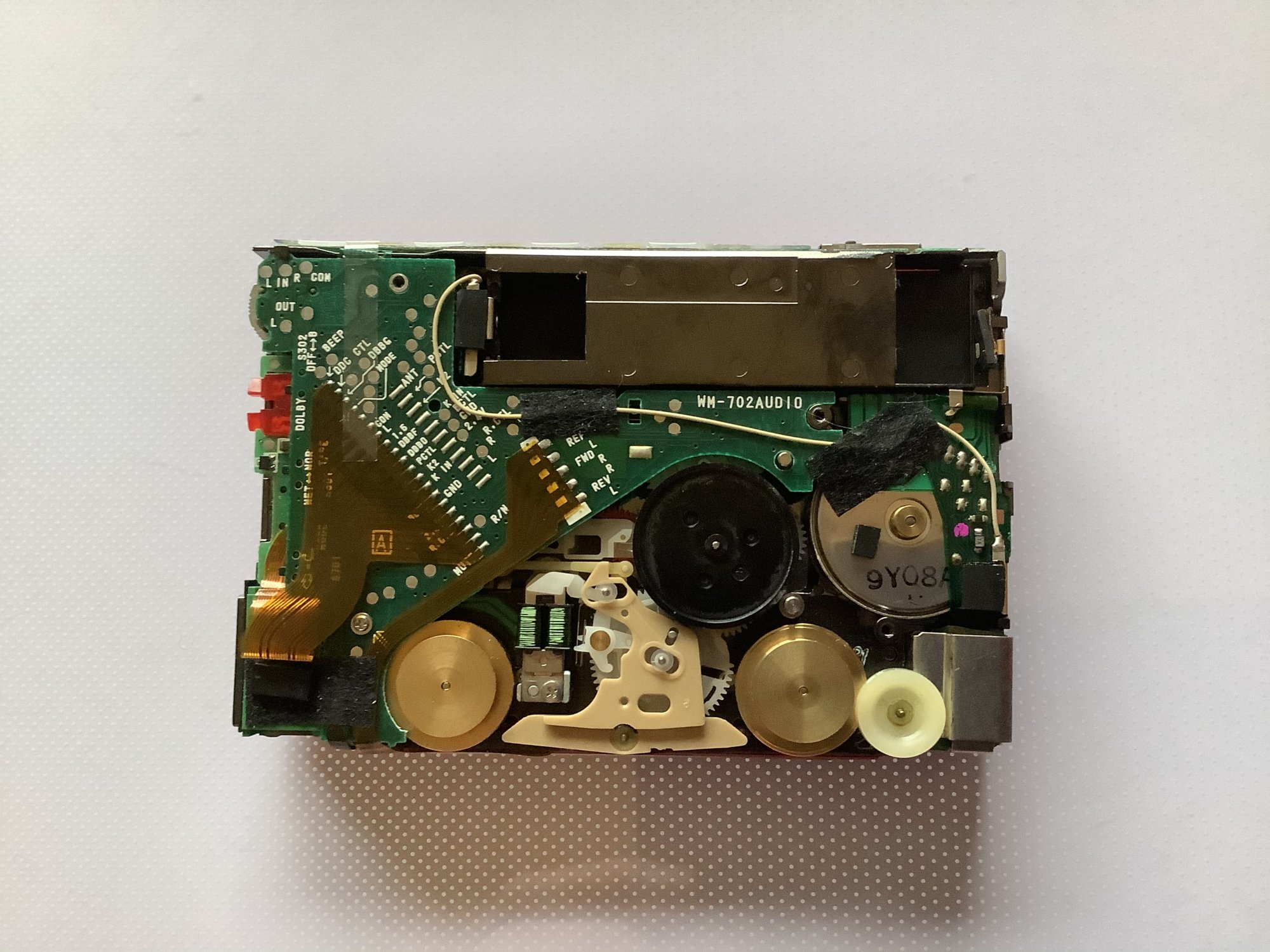

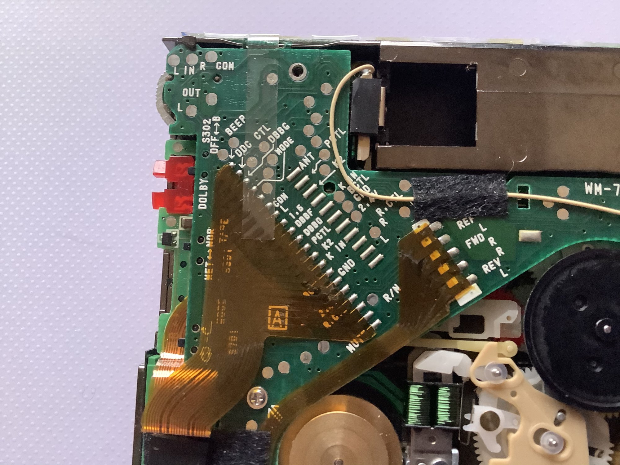

    I am not sure I am up to changing the capacitors . It was a leap of faith to open it up. At least the locking mechanism is not as bad as the 701c I am trying to rebels. See other link . The capacitors look pretty clean to me. Here Are 3 photos of inner unit Can you tell from it if they are Ok?
  5. Recaptcha
    Recaptcha Well-Known Member
    328
    Welp, I can't see any corrosion in the pictures, so that's good. The inside looks to be very clean.
    This unit doesn't have a 'green button', so most likely, it was before Sony started using those problematic capacitors, so I'd say (as long as the unit is working fine), you are good!
