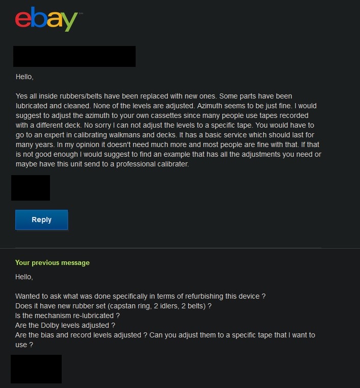

    Given the list is quite large as you can see, it is very important that when you buy such a device, you ask for what was done if you buy it serviced. Most sellers will not state or will make very vague statements.
    That of course does not mean the service isn't of good quality, but can imply for example Dolby levels, rec levels and bias were not adjusted. And I'm confident when I say most of the time these won't be adjusted.
    If you don't intend to use Dolby, it doesn't matter. On the other hand, doing the adjustments is not that complicated and only requires a calibration cassette and a TrueRMS multimeter (which most technicians should have anyway).
    However, given the Dolby C functionality, I would assume most will want to at least give it a try. And without proper calibration, the results will be very bad and you'll conclude Dolby NR technology is junk (which is not the case).
    If you want to use recording functionality, the calibration is also a must and it's not that hard to do in reality: it requires a function generator or a digital audio player/computer to generate some test tones, a blank cassette and a TrueRMS multimeter.
    Below, I will give you an example of an ebay conversation where I asked questions about a D6C listing. Note that the description of the item was completely missing any detail.
    I don't agree with the fact that levels not being adjusted is no big deal. If those were done correctly from the factory, then I would agree that doing an adjustment will only bring a good or very good to perfect.
    You should ask questions similar to what I have asked. An answer like this is honest and correct, although the seller could have listed the details in the description (not what wasn't done, but what was done).
