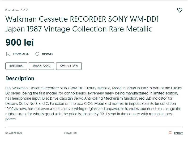

    I want to give you another example of a seller lying about his listing: The below printscreen is a red DD1 for sale at the equivalent of 180 euros. The walkman is in good to very good cosmetic condition, however the good part ends here.
    1. The seller states the unit is extremely rare and was manufactured in limited edition. Both of these statements are false, it's a model that is relatively common, even in red color (although the red color is indeed rarer than other colors).
    As for the limited edition statement, none of the walkmans in the DD series was a limited edition as far as I know.
    2. It's also to be noted that the DD1/DD10/DD11/DD22 are budget models, not having center gear type mechanism in order to reduce cost, the head and pinch roller mechanism were also simplified a lot.
    Specified wow&flutter on these is higher than the rest of DD range, so the luxury statement seems ridiculous to me.
    3. Seller states the unit has Dolby B and Dolby C, although the pictures clearly show the Dolby button with only ON and OFF position. DC2, DD9 and D6C are the only models from the range which feature Dolby C.
    When sending a message to the seller, he does admit the unit doesn't have Dolby C, meaning he's aware of lying and he is trying to fool people which are not familiar with these systems.
    4. He states the unit "works, but needs to change the rubber strap". When asking details about what he means by that, he admits the unit is actually not working at all, as the capstan and takeup reel are not rotating.
    5. Seller does not mention anything about the leaky capacitor symptoms. When I reveal to him details about all the problems these units have and parts cost, he offers to drop the price to 140 euros. I did not accept the offer.
    However, when asking him to remove the Dolby C and working condition in the description, nothing happens.
    The conclusion that you must draw from this is the following: always research details about a specific device before buying it. Know what features it has, what are the prices and how common or rare they really are.
    Sellers will always state that their devices are extremely rare, making some people think their device is so rare that they won't find another one like it. In my experience, this is never true, even the truly rare walkmans can be found if one is patient enough.
    Another aspect is you need to explain the seller that those devices need to be professionally serviced and the price of one in need of repair cannot be the same as a fully restored one.

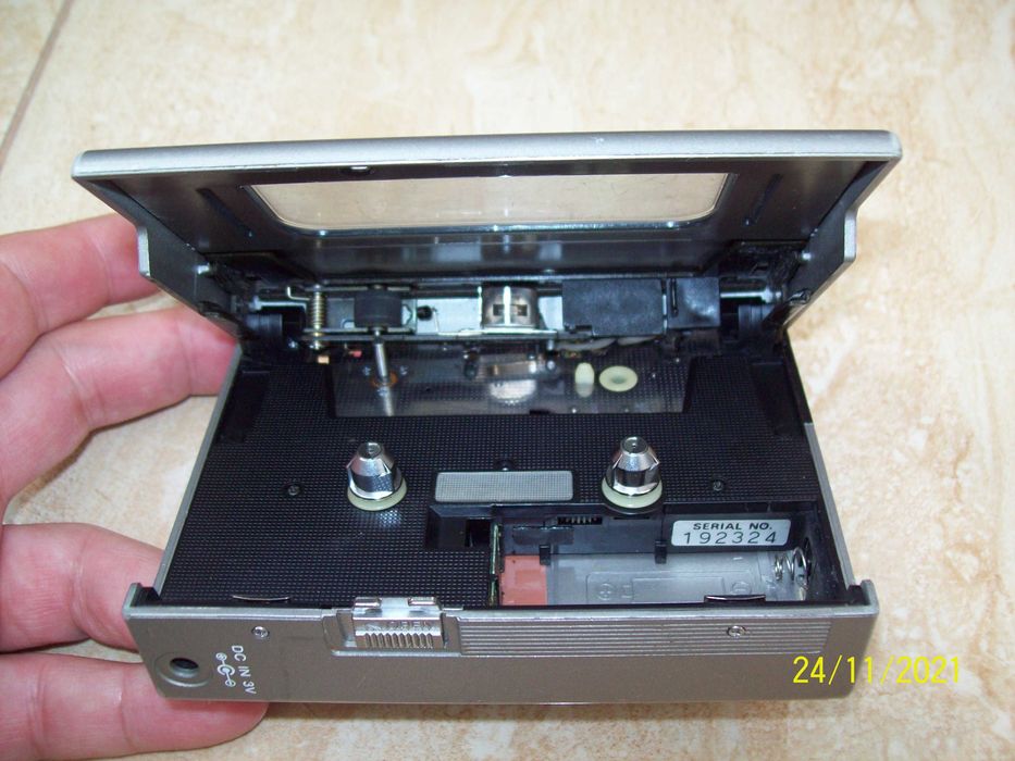

    Here I have yet another example: a WM-2 for sale at the equivalent of 120 euros. Seller claims the unit is working flawlessly, however the serial number in his pictures (535 188) indicates a broken center gear.
    The fact that there is no mention about the unit being repaired indicates the seller wants to hide the clicking sound and doesn't consider it a problem. Not to mention the belt is long gone in this device, so it is possible it's actually not working at all.
    In regard to the missing battery cover, a 3D printed one is available (which looks close to original): https://www.ebay.com/itm/133799930041. However the seller should substract the 25$ cost from the price.
    If you find yourself in such a situation, it's best to ask the seller more details like about the clicking sound, if it has been repaired (although in 99.99% of the cases the seller will state this).
    EDIT: It seems there is no clear correlation (at least I can't identify one at this point in time) between serial numbers and type of center gear used. Details here: https://stereo2go.com/forums/threads/sony-wm-2.7664/
    This means one should be even more careful when buying this unit, especially when the belt has not been replaced.
    Fortunately there is a simple way to test this (ask seller to do this): turn the takeup reel by hand a couple of full turns. Check for any notchiness in the rotation, indicating a break in the center gear.
    If the clutch slips and you're not able to rotate the center gear (when clutch does not slip, capstan should turn when you rotate takeup reel), it is very likely the center gear is stuck with the broken part engaged with the flywheel. This is an obvious indication of broken center gear.

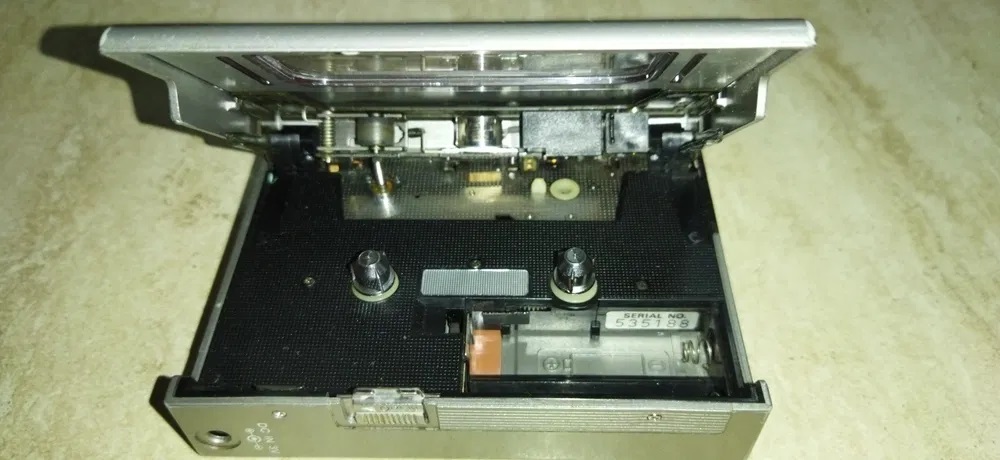

    Here I have another example of a WM-2 (seems there are a lot of these for sale), this time the ad reflecting an honest seller and a really low price (~44 euros). The battery cover is missing (as can be seen in pictures), although not part of the description.
    My opinion is this walkman is worth the price, but you have to add the cost of a new 3D printed battery door (20 euros), a potential new center gear (30 euros) and a new belt (5 euros).
    Seller does not say anything about motor running or not, so a new servo IC may also be needed (10 euros). It can be quickly seen that in a worst case scenario, the cost of parts alone exceeds the cost of the walkman itself.
    However, if you are going to pay someone else to do it, the cost will be significantly higher, so keep that in mind. In a best case scenario, only a new battery door and a new belt will be needed.
    EDIT: I also notice the azimuth screw seems to be tightened all the way (head tilted to the right). The pinch roller bracket must be checked in this case as well, as it could be bent: https://stereo2go.com/forums/threads/wm-dd-azimuth-instability.7590/

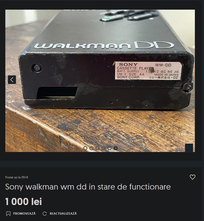

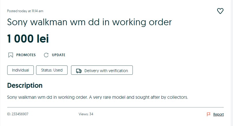

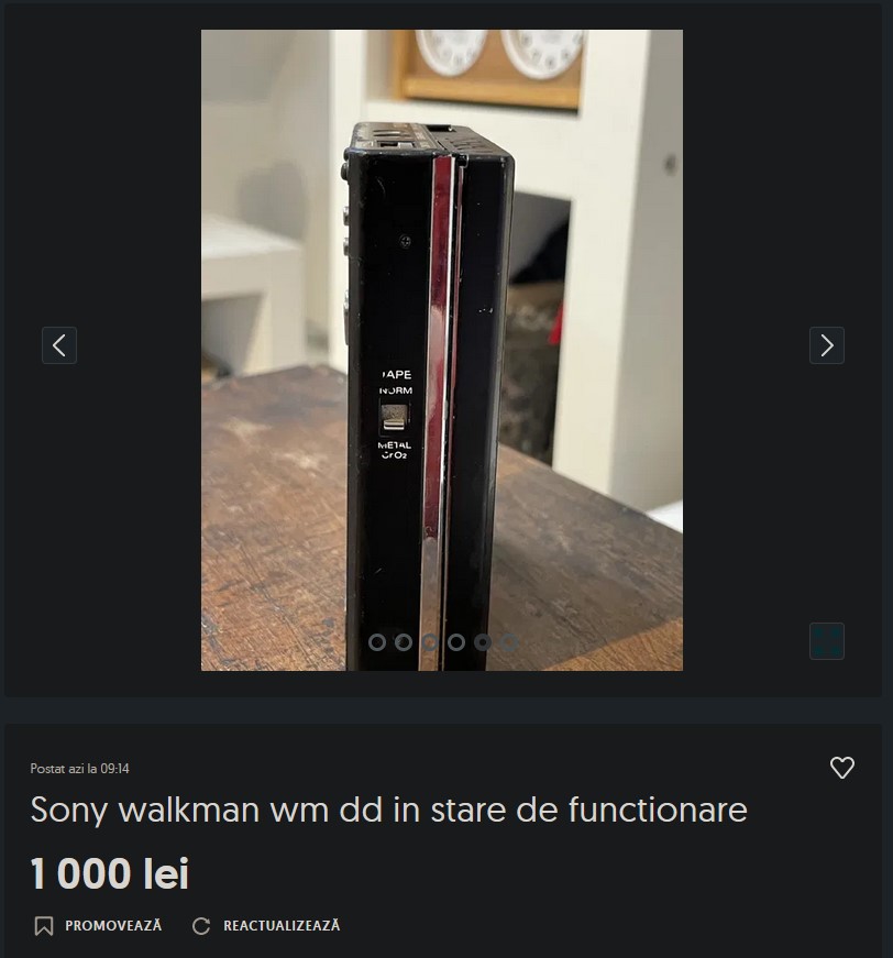

    Yet another example of a seller that tries to dupe people into thinking his junk WM-DD walkman is something that they will never find again, it's "very rare" and in "working condition".
    Please note he mentions nothing about a broken center gear (the tac-tac sound) or the missing battery cover that can be clearly seen it's missing.
    Price equivalent is ~200 euros. Way too much for a walkman that has the external case in absolute JUNK condition. And way too much for a local market, that's another aspect.
    I bought a better one (was sold for parts) at 10 euros last year, which is in much better condition that this one and I got it to work and kept it in my personal collection, as the cosmetic condition was decent enough.
    This particular unit is rarer than other models, but not really that rare. The device depicted is in my opinion a for-parts only unit.
