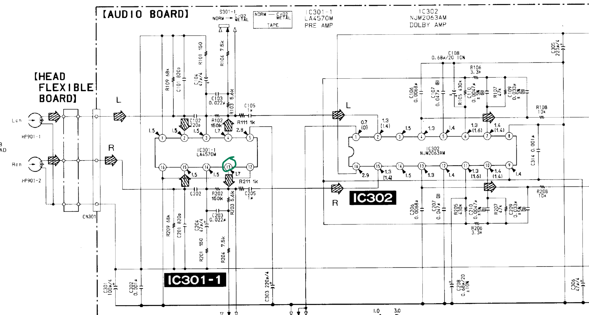

    I happen to complete the recap of this Sony WM DD11. Sound seems to be restored to back to its original loudness levels. But the sound in right channel is very faint and low at full setting.
    Can anyone please suggest possible fixes for this low sound?.
    I have attached a picture of the board before cap replacement.
  2. Valentin
    1,568
    Sound on R is faint and low only at full setting, but fine otherwise ?
    If so would measure the potentiometer resistance during a full rotation.
    The pot has 10kΩ, so you should see the resistance varying between ~10kΩ at minimum setting and 10-20Ω at maximum setting.

    Hi @Valentin the sound in R is low at all settings. Should I check for any resistors specifically to right channel sound?.

    Does the volume level vary (even a tiny bit) on R channel with different settings of the potentiometer ?

    Hi @Valentin , yes the volume does vary about 20% at from 0-10 steps setting. However the total audio volume level output at 1oth step is 20%. I checked this with and without cassette inserted in play mode.

    What I would check (assuming you don't have means to measure the signal at different points) are the following:
    - head connection and if the head itself is clean;
    - solder joints on the new capacitors;
    - damaged traces or vias near new capacitors (potentially affected by leakeage);
    - volume potentiometer resistance at max setting (see post #2);
    - headphone jack (both soldering and clean it);
