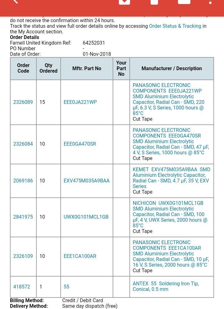

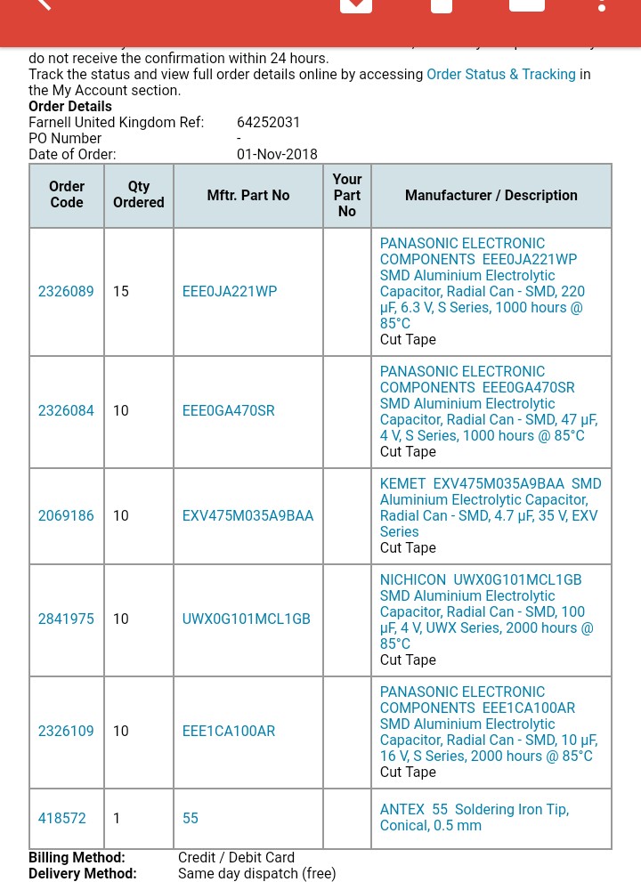

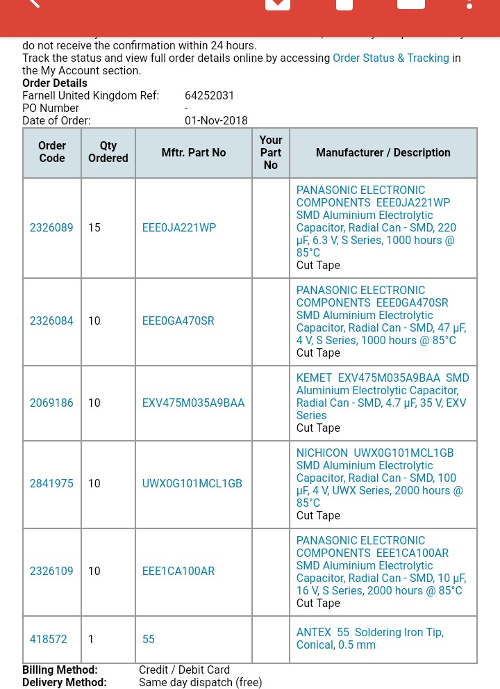

I'm actually recapping a dd11 right now! I got the components from Farnell in the UK Good luck with your project!
