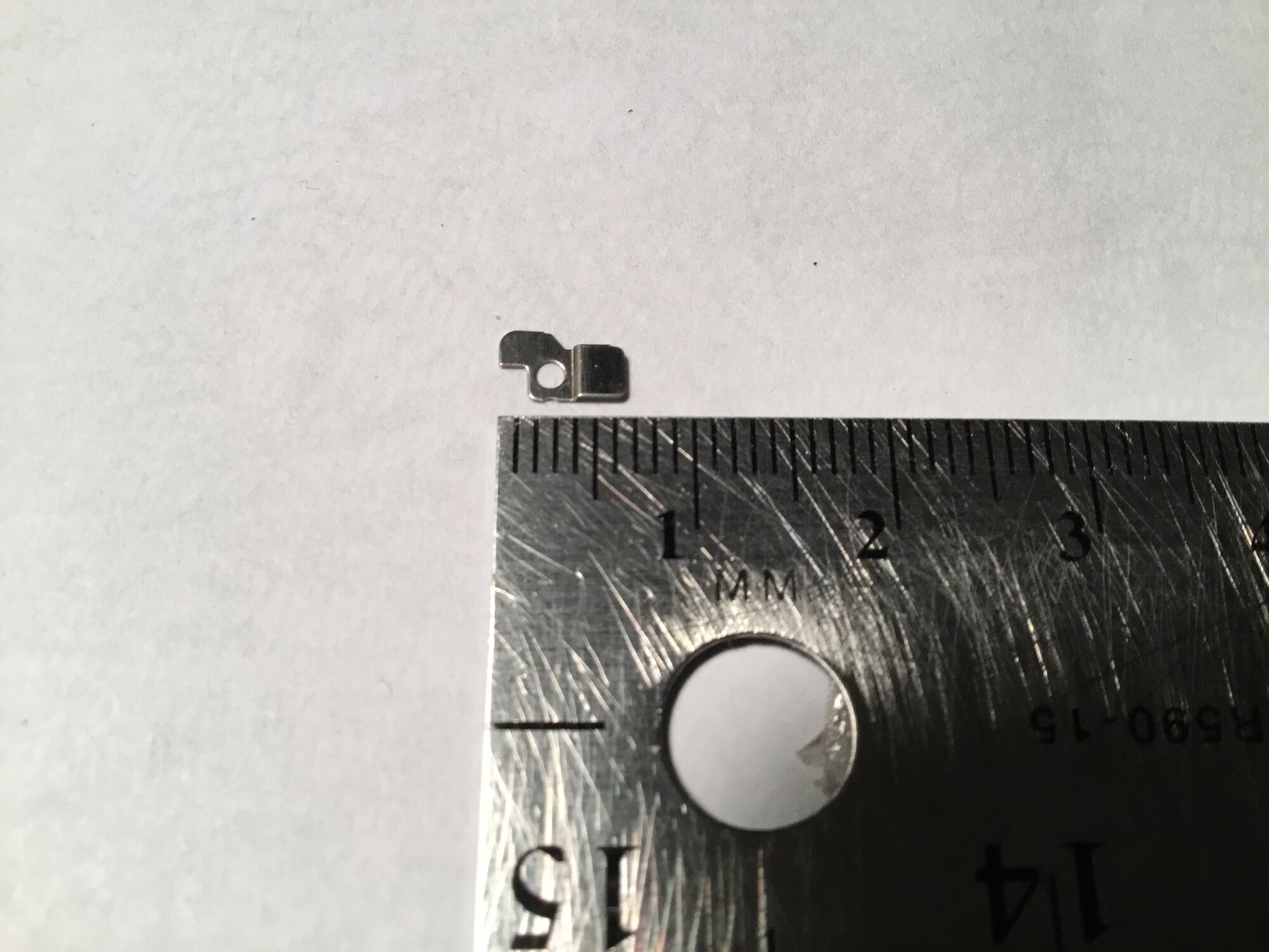

    Hello.
    I was putting a capstan tire on a WM-DD9 and after disassembling the forward play capstan clutch inside of the unit, I saw this part but cannot figure out from where it came. I closely checked the exploded part views/illustrations in the service manual, but could not identify it.
    Does anyone know what this part is/does if it’s from a WM-DD9?
    Thank you

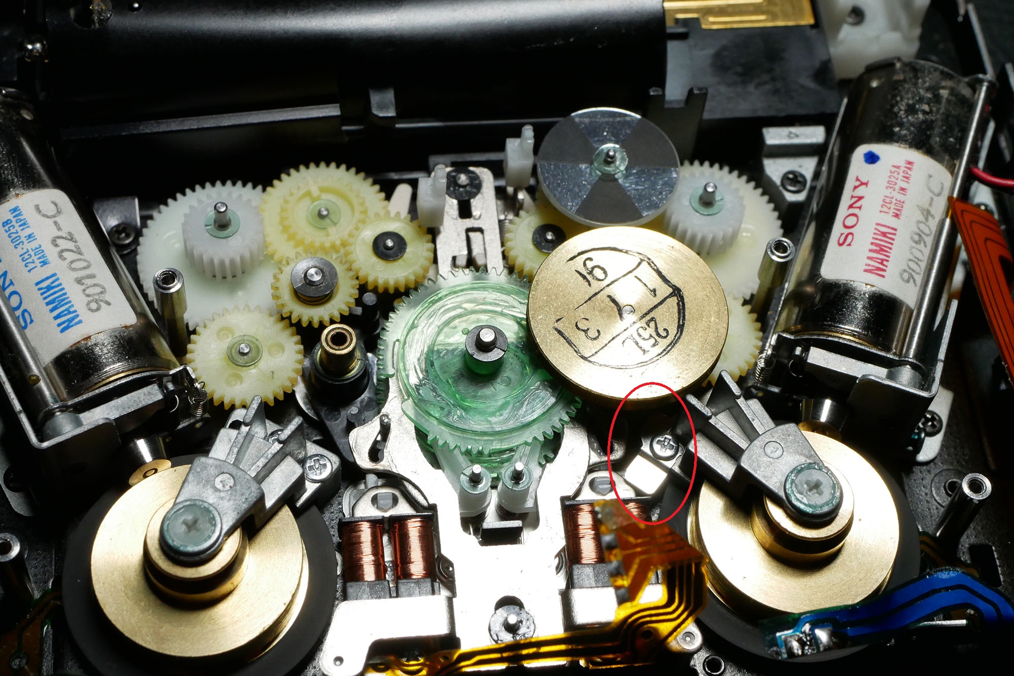

  2. Valentin
    1,699
    That part goes on the REV flywheel bracket, see picture attached.
  3. soundabout
    soundabout Member
    39
    New York
    Hey Valentin,
    Thank you very much for the feedback! It was a huge help as I could not figure out where that piece went on the DD9.
