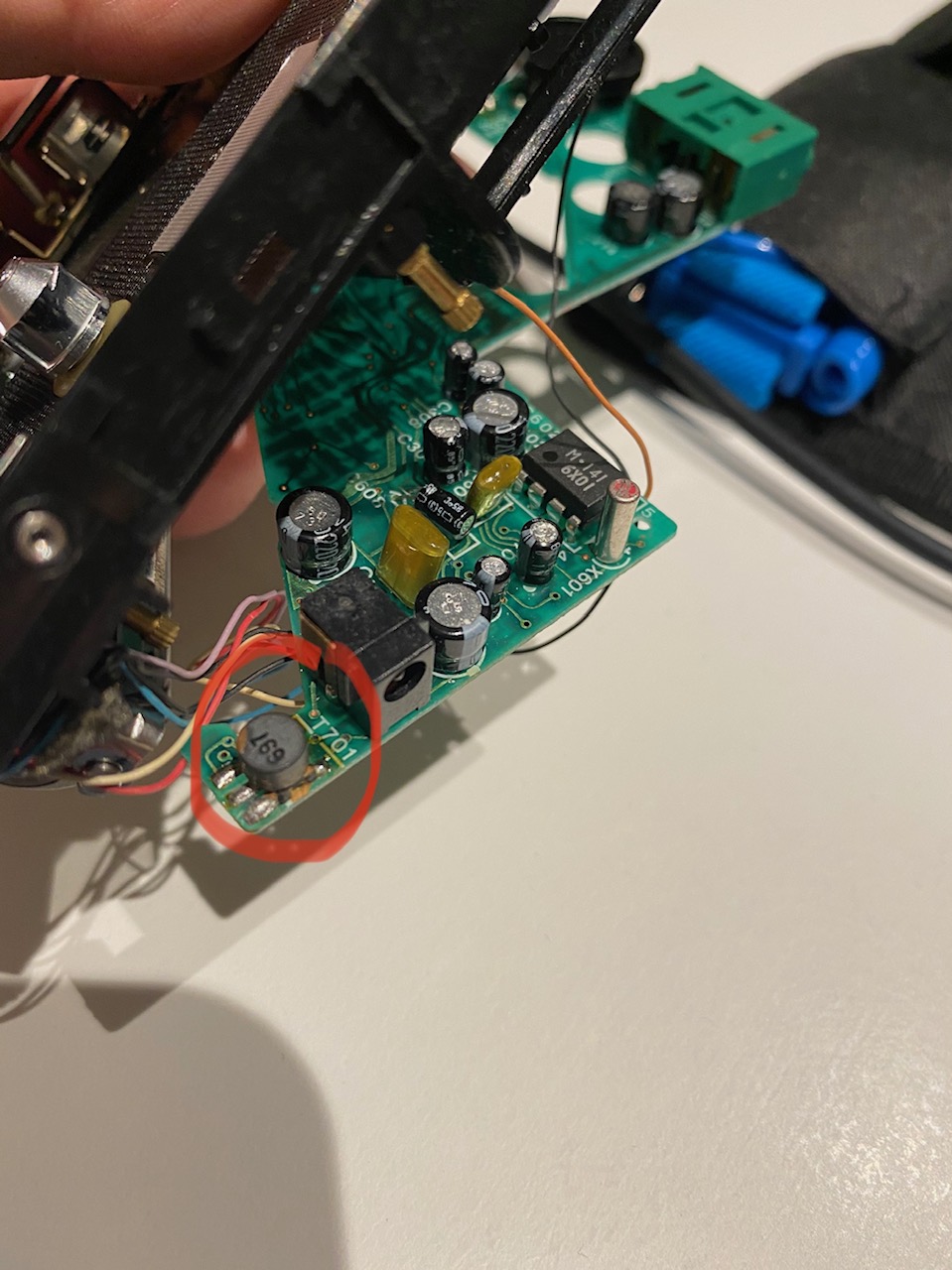

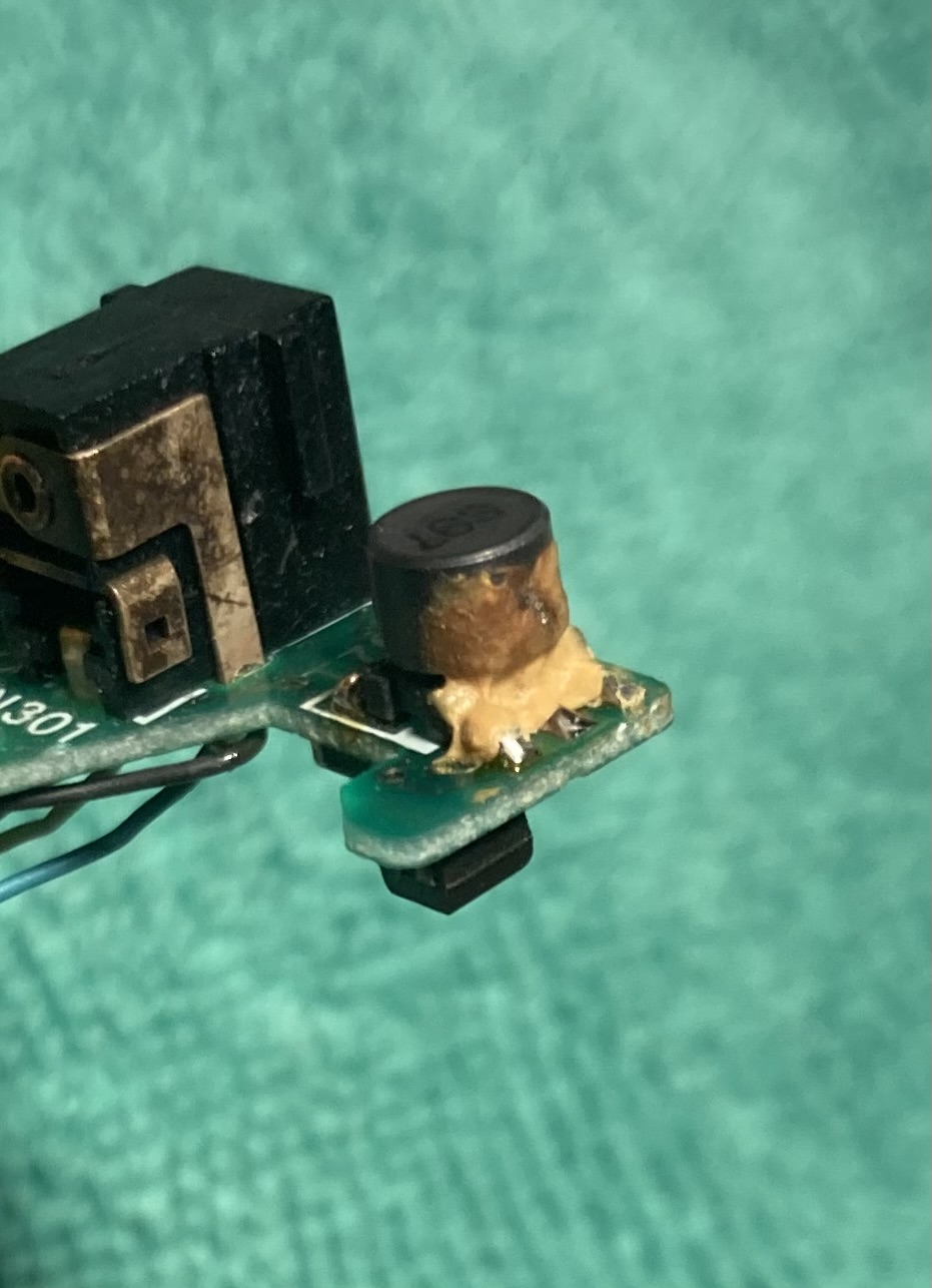

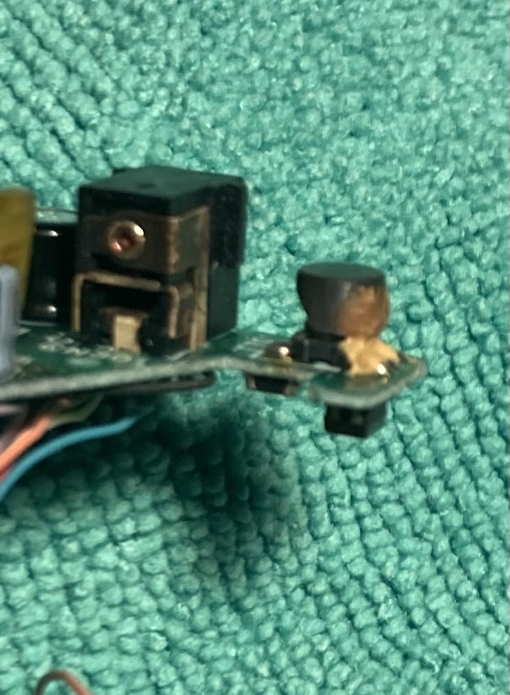

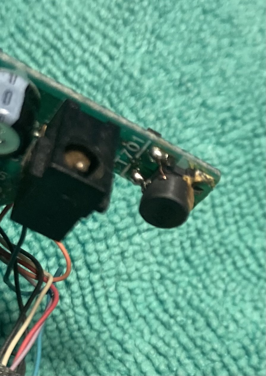

    Hello! I'm trying to fix Sony WM-DDIII. There is a broken part described in service manual as
    T701 1-447-697-00 TRANSFORMER, DC-DC CONVERTOR. Anyone knows where could I find/buy this part? Or maybe replace it with something else?

    Post in the "Gear you want" section. I recommend asking for a replacement PCB, as the chances of finding just that transformer are slim to none.
    And no, you can't replace it with something else, cause it's a custom made part.
    You may also look for a donor unit that has a different problem like:
    - missing mechanical parts;
    - case damaged/dented beyond repair (but not on the corner with transformer);
    - missing buttons and screws;
    For parts units are much cheaper than so-called "working ones". Put that in quote marks because all DDs will have a broken center gear, despite many sellers won't mention it.
