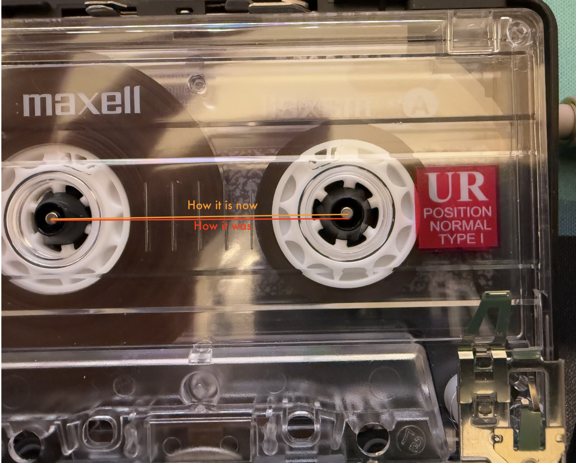

    I am now answering to myself It could be that I fixed it and I know what is wrong with it.
    For some reason, when the right reel was out of the centre (like it was kicked for a 0.2-0.3mm down right). So I removed the door and took a closer look, it appeared that the right axle fell off the axis. And when the right gear becomes take up reel, its getting harder and harder to spin because it spins a bit towards down.
    I just applied a bit of a force with a thumb to make it center and checked using a few tapes to make sure its perfectly centered.
    Now, no flashing battery light when rewinding the tape either side and no more this strange squeaking by the motor when rewinding this Maxell tape.
    I have checked with several tapes now so since take up works smoothly without slowing down, no more eating tape
    Congrats to myself :D
