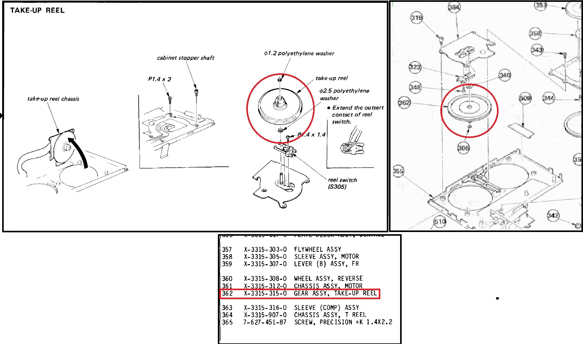

  5. Bob1123
    Bob1123 New Member
    5
    Dayton Ohio
    I couldn't get it disassembled enough for a great picture. I have attached some diagrams from the service manual and the part number. It's listed as X-3315-315-0 Gear Assy, Take-Up Reel.
  6. Boodokhan
    2,476
    This is exactly the one I mentioned. This gear is very common to crack in WM10/20/30/40, F10/20, WM-W800,
    The problem is the replacement walkman you want to find for parts, might have a broken wheel.
    Silver965 likes this.

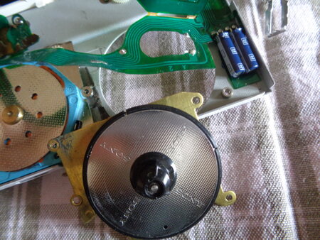

  7. Silver965
    Silver965 Well-Known Member
    715
    Torino
    If the situation you have is this you can only replace it

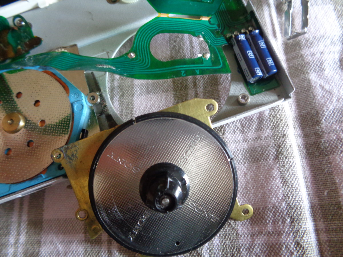

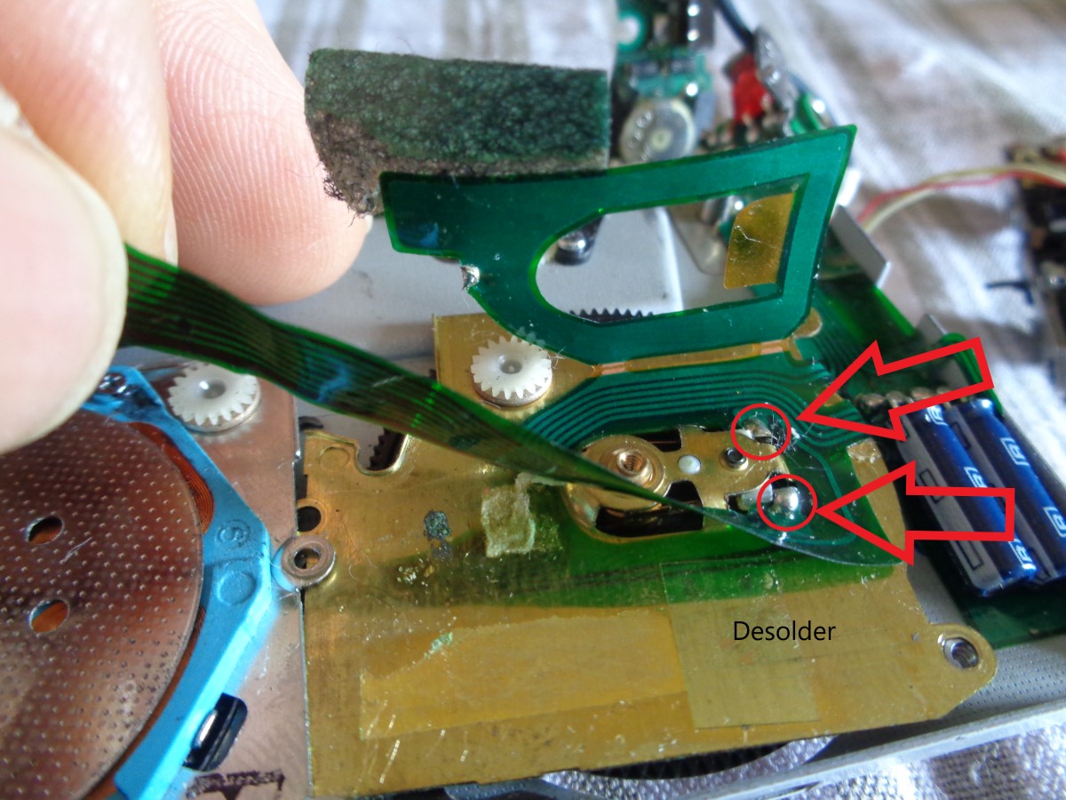

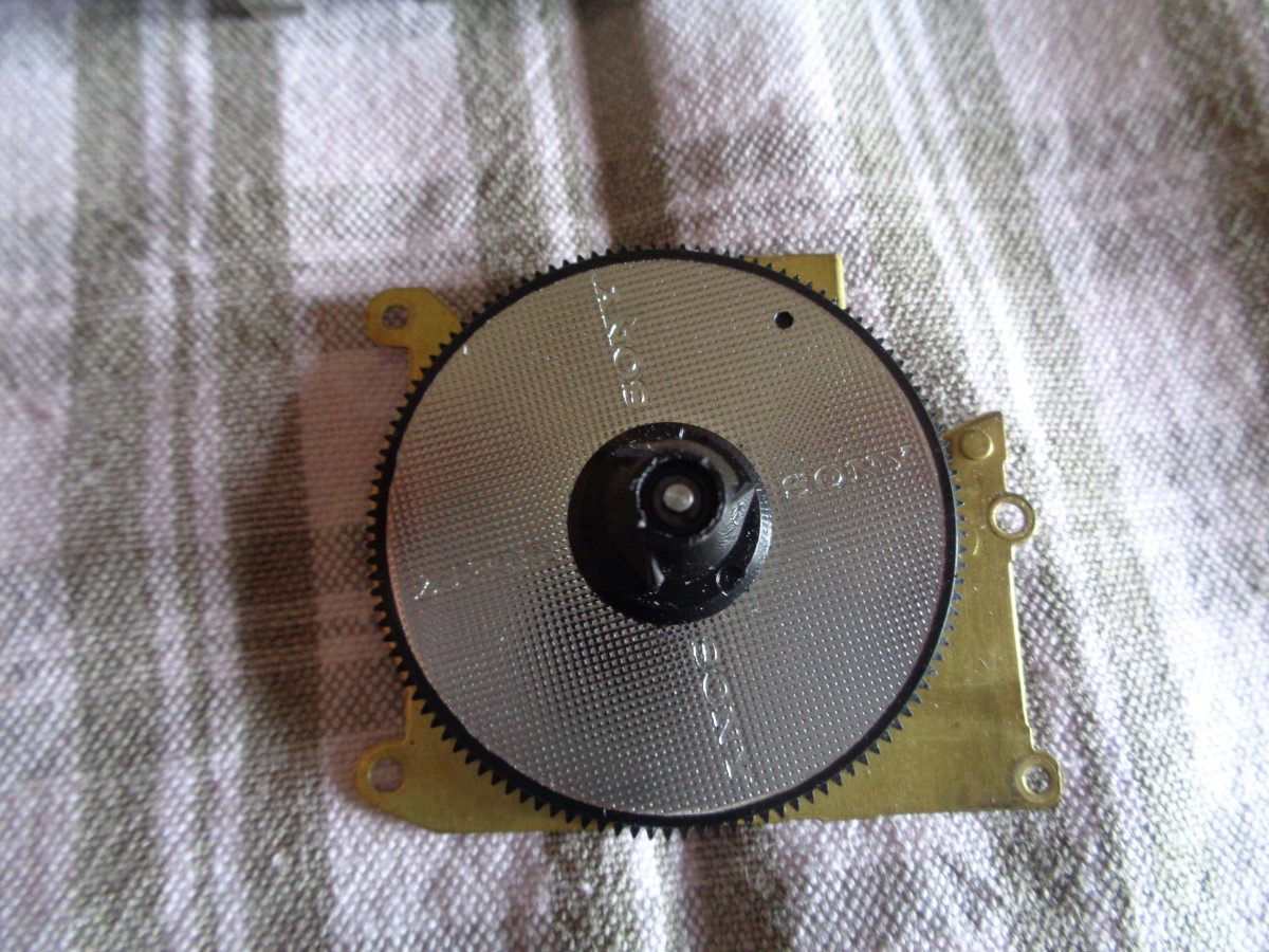

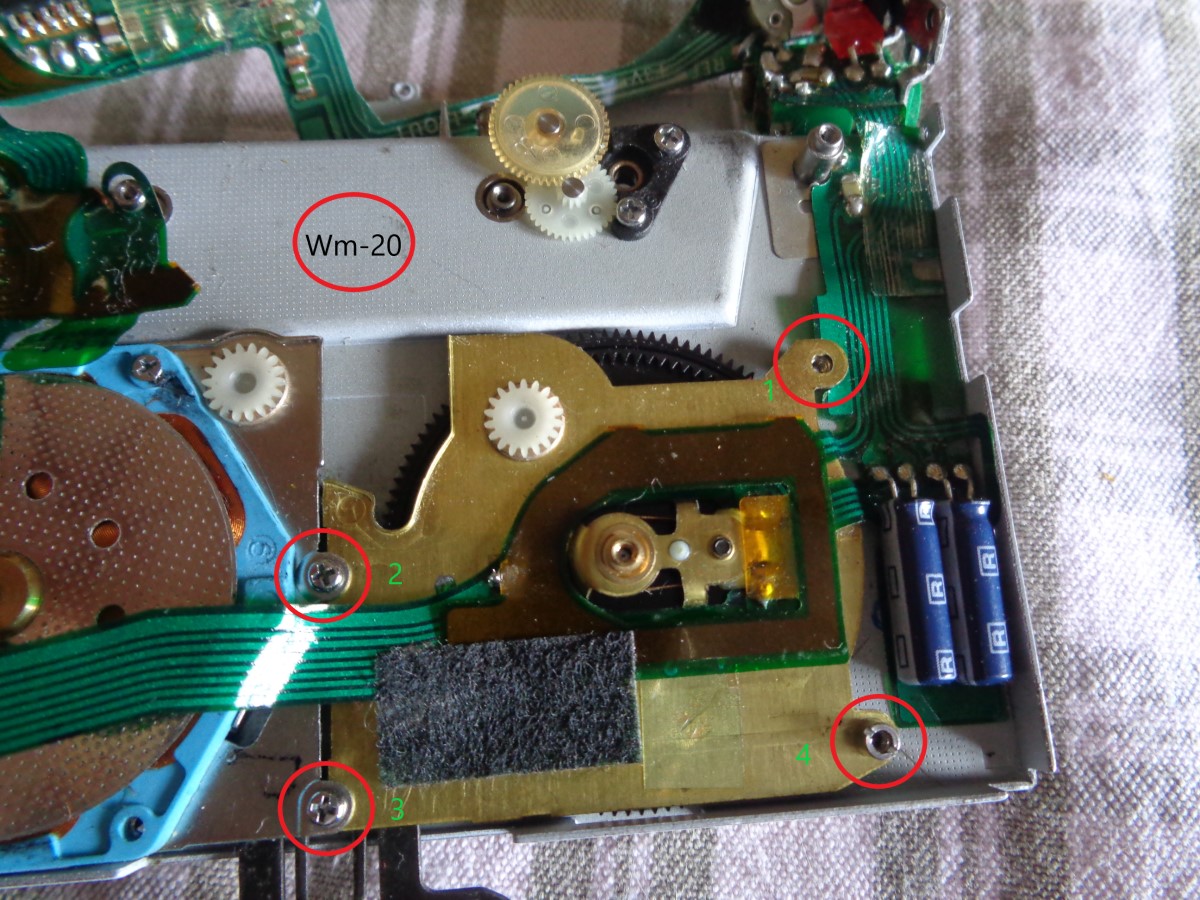

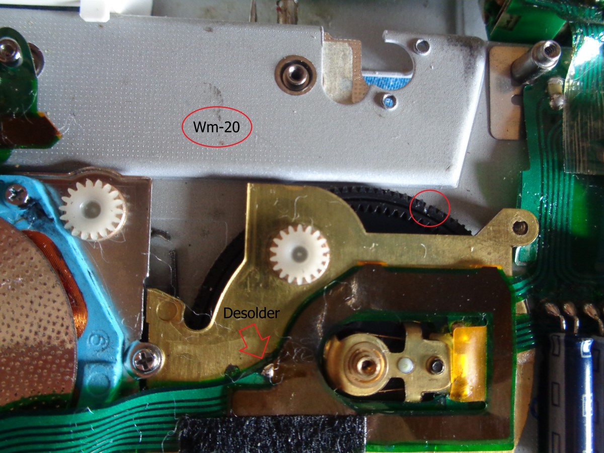

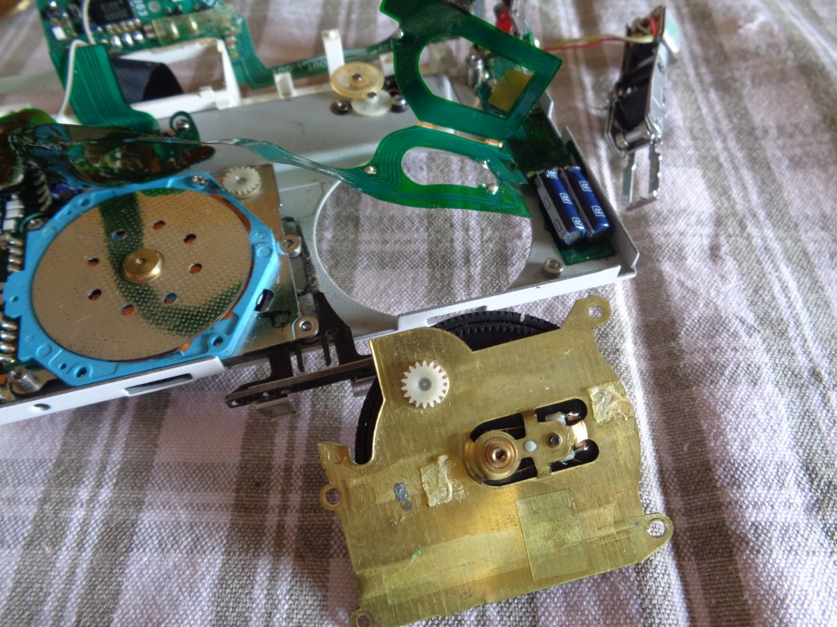

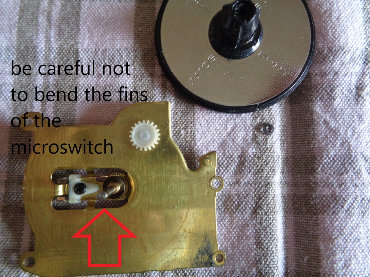

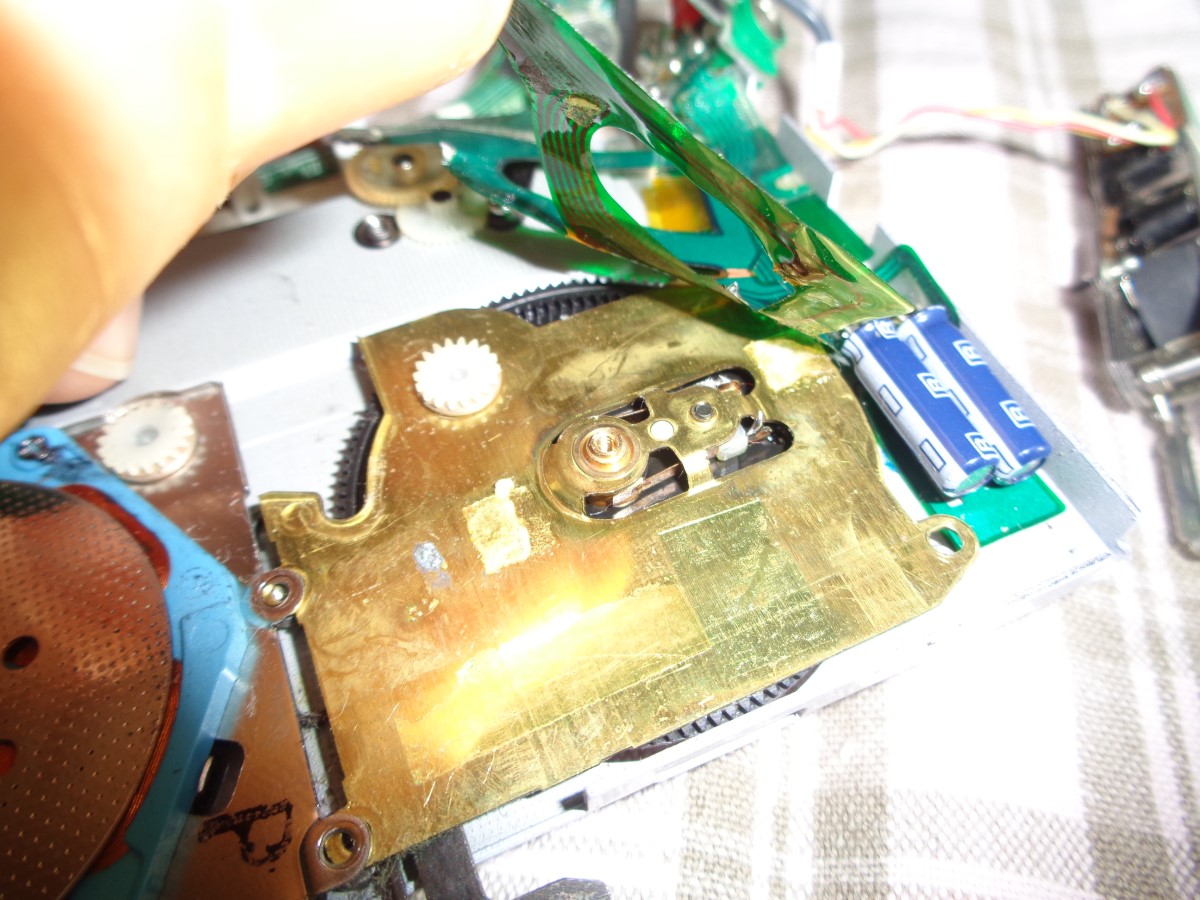

  9. Silver965
    715
    Torino
    this is a gear change done to a Wm-20 some time ago ... it should be similar to yours ... how to disassemble it reassemble a new one ... hope it will help you
