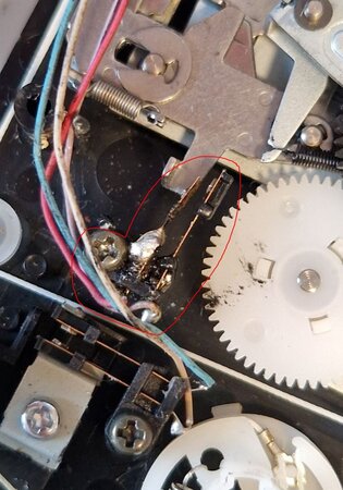

    Hi, I made an opsie while soldering the play/engage switch on my WM-F75 switch so now it's really unreliable.
    Does anyone know of a suitable replacement? See image (of destroyed switch).

    € 1,17 | 10PCS LSA-05-9G Factory direct 3pins Reset Mini Leaf Switch with Triangle
    https://a.aliexpress.com/_EIMjQrp
    Does not seem like a particularly special one, compare it with on of these, one should be at least adaptable.

    Awesome. Big thanks! I will use my small flamethrower in the future. And maybe change the tip on the soldering iron as it didn't perform as expected to say the least :)

    A good soldering iron with good quality tips, (not necessarily expensive) is mandatory wen working with old equipment.
    With my ts-100 I can keep the iron down to 290 degrees, solder still flows well and quickly, and this reduces a lot the chance of delaminating pcbs or melting stuff.
