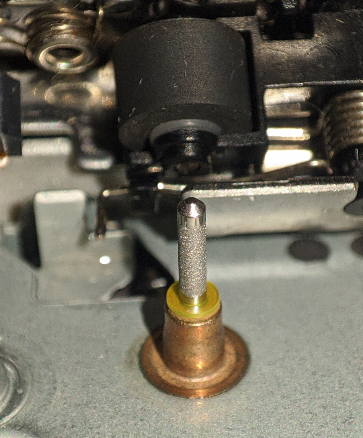

    @Valentin: Just tried to play a clear Case Tape with the door remove, like you suggested. I couldn't see any curling of the Tape but i noticed, when i was applying more pressure on the tape, more stable and clearer the Sound was, but only on Reverse Playback. It didn't matter much on FWD Playback.
    I made a macro Picture of the Reverse Capstan for you to take a look:

    I see, those capstans are the type that already have a deep roughening from the factory. The macro picture is a very good reference in this regard, so a potential capstan/roller issue can be excluded.
    The fact that when you press on the cassette the situation improves may indicate the cassette itself does not stay straight into the carriage. There should be some metal springs in the carriage itself and
    also one on the back of the cassette (where recording tabs are located). Double check that those are keeping the cassette firmly in place (and also not on an angle) when the door is in closed position.
    Something mechanically bent (carriage, frame) can't be excluded.

    UPDATE: With @Valentin 's valuable help and Advice i checked some things out and realized the Reverse Pinch Roller wasn't perfectly aligned to the capstan. By flipping the Pinch Roller, the alignment became much better and Sound Quality became somewhat better. Then i grabbed my EX-678 and compared the Quality on it and saw a pattern. On Reverse, the Treble Levels on it are also slightly lower in Comparison to Forward Playback!
