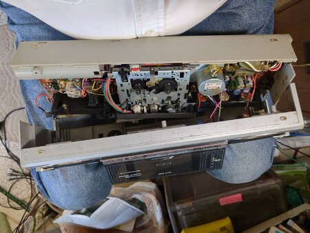

    Ac and Mike and headphones input end

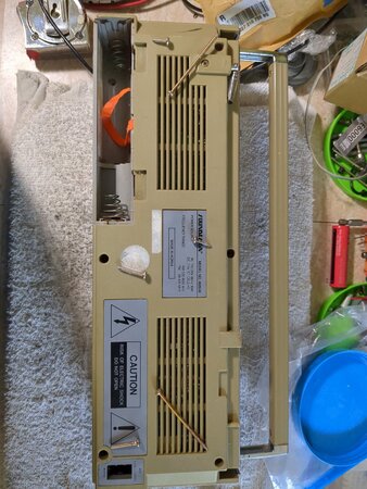

    The screws as they come out are all different lengths. Therefore, here's a picture so you know which ones go in which hole as they're pointed to the hole they came from.

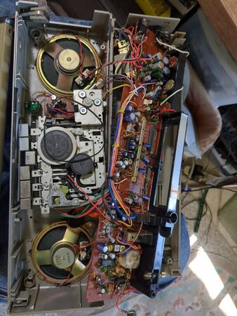

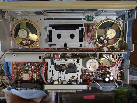

    You must remove all the knobs and open the cassette deck door before you can pry the bottom from the back off so it starts looking like this so you can remove the back cover because all of the electronics stay with the back and not with the front.
    Opening looks like that
    Just above the motor. There's a three-wire pin to remove for the power level indicator which is just a push on pull-off thing but there are other speaker. Wires are soldered in place so you have to work with this with the speakers attached unless you unsoldered the speakers.
    Then after you remove two screws from the cassette deck and two screws from either side of the main board, then you can remove the main board and flip it over and remove three more screws from the back side. Two are through the circuit board and one is grounded to the circuit board and then you can get to this point. Pull out the cassette deck, flop it over and remove the belt as it doesn't have any plate covering the belt and then clean everything. Deoxit everything. Clean the recording bar switch clean everything electronic that music goes through that can move, rotate or otherwise and put it all back together. And then you're done like I will be soon course no this one. It needs an antenna so I have to go find one. If you look at my beginning pictures this one just has a nub.
