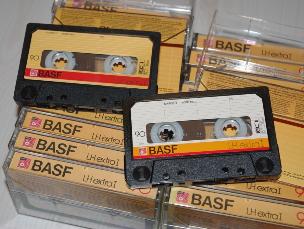

  10. Valentin
    1,529
    I bought about 15 BASF LH extra I last year and almost all of them have this problem. In the batch I bought there were 2 types, one with white sticker, one with yellow sticker.
    From the white ones, not a single one could be saved. I tried cleaning the tape with the shell opened and fast forwarding with no success.
    Most of them started squeeling at the end and shedded a lot of oxide on the head and pinch roller.
    One particular thing that could be seen on the tape itself were periodic vertical discoloration lines (strips of darker brown followed by lighter brown).
    However, the yellow ones were mostly ok, except for one or two. I remember reading here or on tapeheads that there was a problem with the tape forumulation on this model,
    as many people experienced this problem even back in the day.
    I was disappointed, as they were pretty good in terms of sound quality.

  11. Silverera
    Silverera Active Member
    392
    MEL
    These BASF tapes I remember from the early 1970's and they left a lot of brown gunk on tape heads and pinch rollers. They had a special series for the 1972 Munich Olympics and these were as bad. I don't recall them sticking but I stopped using them assuming the residue left behind was not good for my equipment. It's a pity really as they have a great retro look and feel in your attached picture.
  12. Valentin
    1,529
    It is a pity indeed. I ended up not using them at all, not even the yellow ones because I fear the tape could damage the heads in my units. In BASFs of this vintage, the security mechanism can also play a role in degrading the tape, if the cassette was used without removing it.
    I remember seeing a video on YouTube with a sealead FerroChrom cassette in which just fast-forwarding it shedded the entire oxide of the tape and left just the pastic base. The second one that was opened in the same video had its SM removed and did not have the problem.
