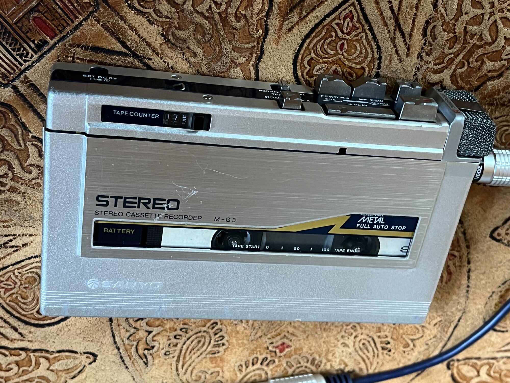

    Beginning this year I stumbled on a unique Walkman, the Sanyo mr-s1, the Japanese version of the m-g3.
    It's a relatively unknown Walkman from 1982, mentioned only once in the old forums by @ao and @Walkgirl if i recall correctly.
    The one I own is unusual for different reasons; it has a Toyota logo (possibly an executive gift) and I got it from France. How a Japanese Walkman ended up in France is an interesting thought exercise.
    I really want to get this Walkman sounding it's best, as the machine in question is rather unique in my opinion.

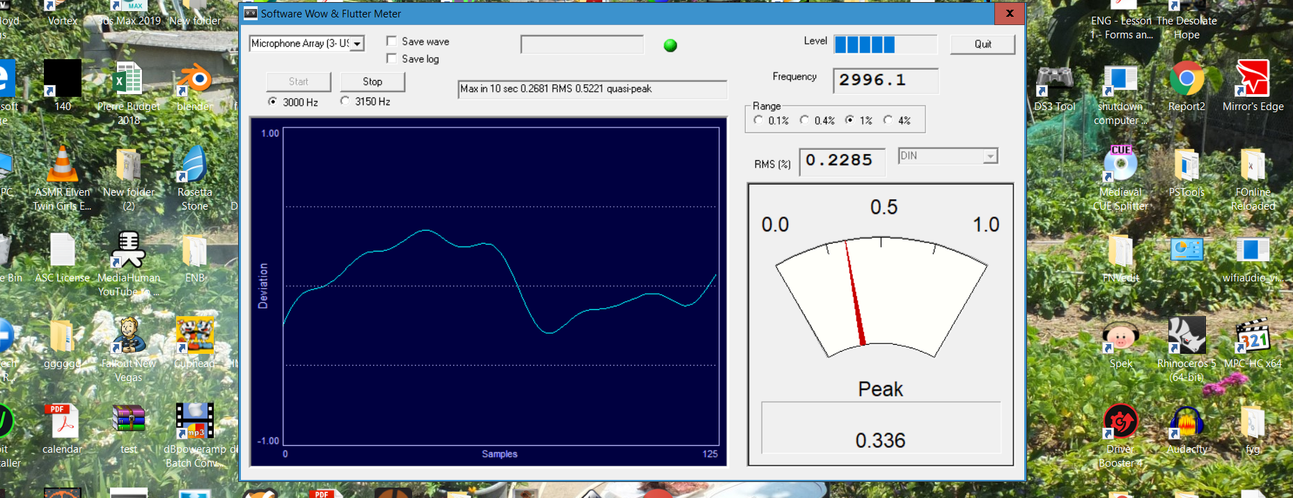

    With the stock machine as is, the wow and flutter is unimpressive, being worse than the Sony tps-72 (0.219rms according to @walkman archive's article).
    However if I can find the right replacement belt, clean and re-grease/lubricate all the gears/pulley , and re-cap everything, then I think this machine has alot of potential.

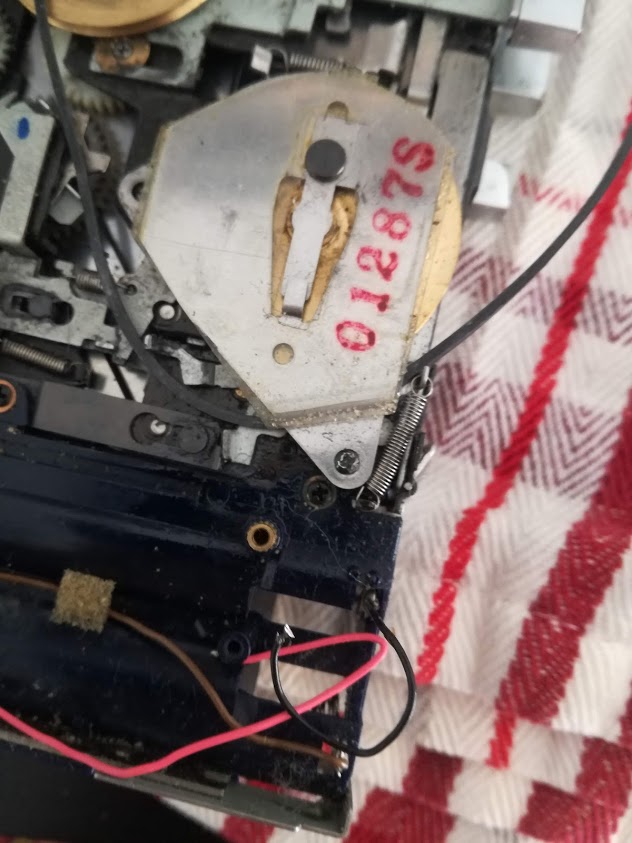

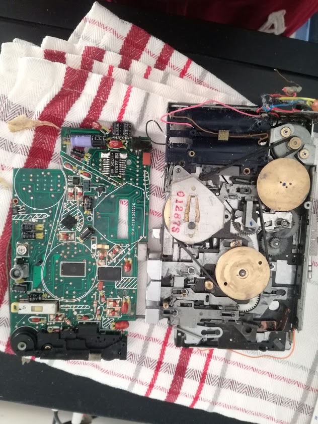

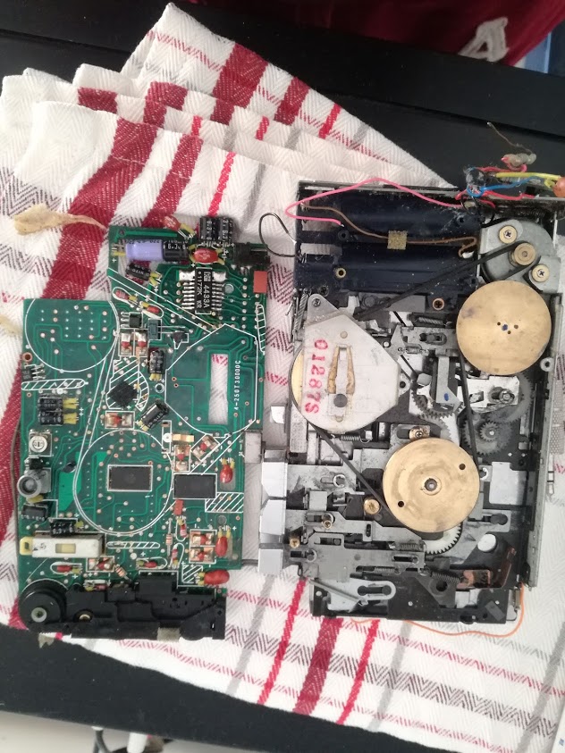

    So opened up one of the two units I own. The non working one.
    The one that had been sitting on my desk semi-disassembled since December.
    It's the more banged up of the two that I own, got that one from the marktplats.

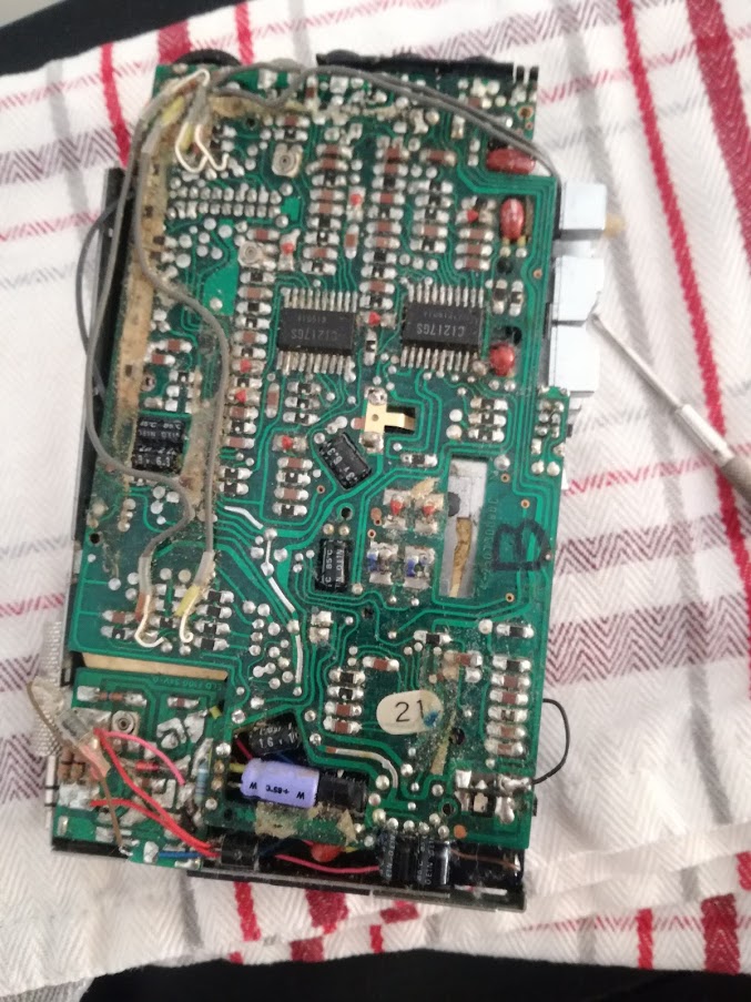

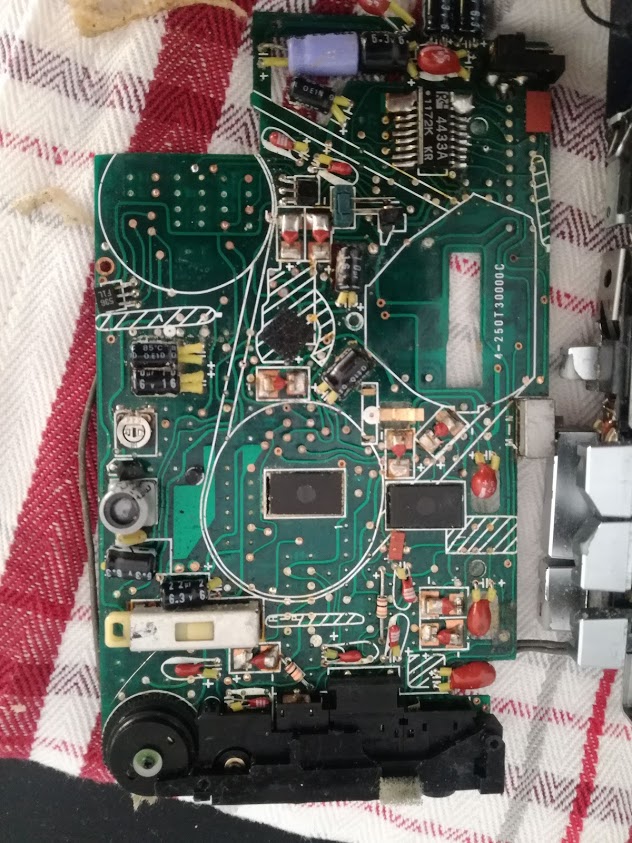

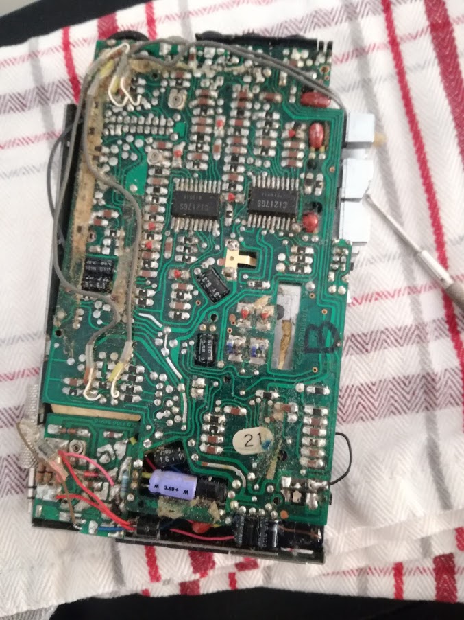

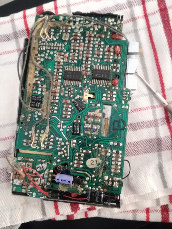

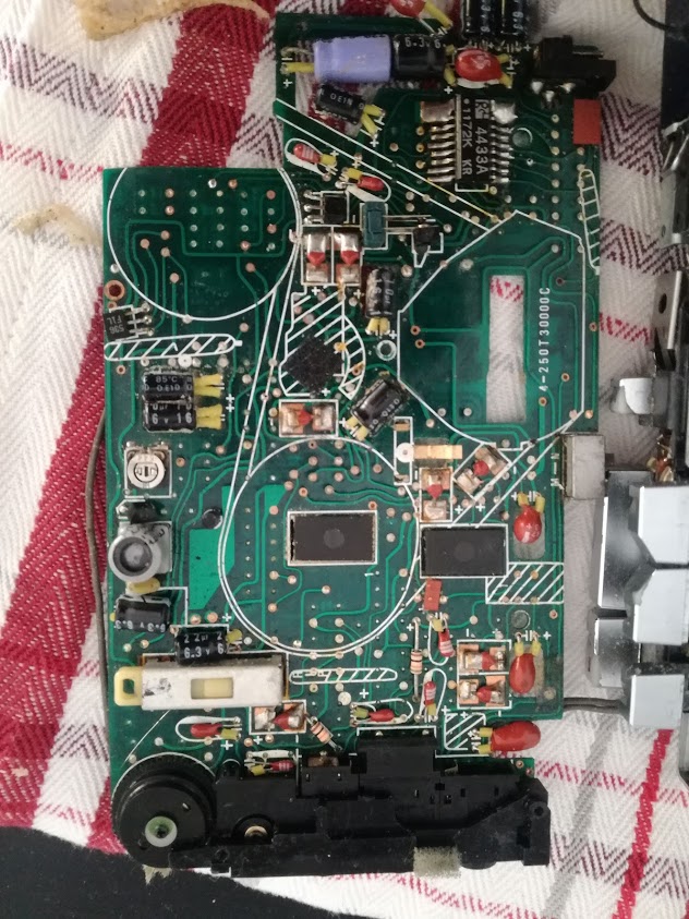

    what's sticking out is the motor control pcb.

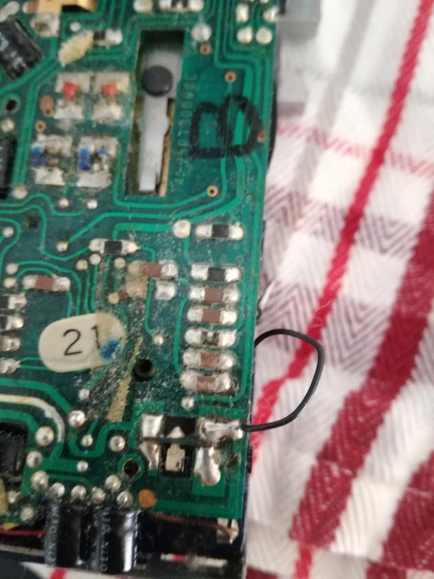

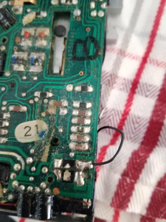

    Flipping it over, we start by unsoldering the pcb as instructed in the service manual.
    As you can observe, the PCB was filthy:

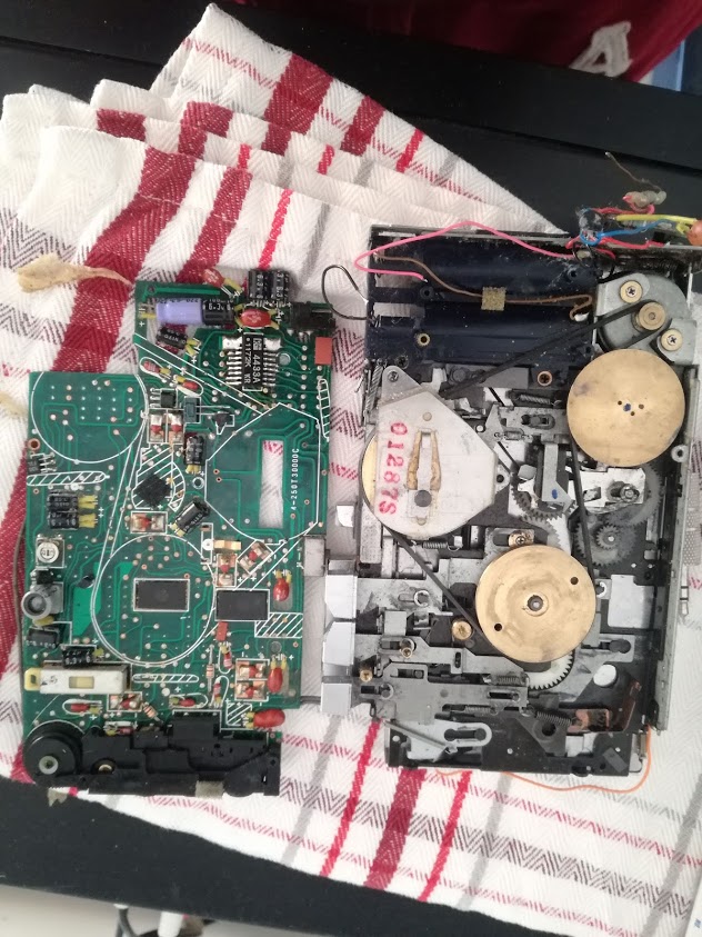

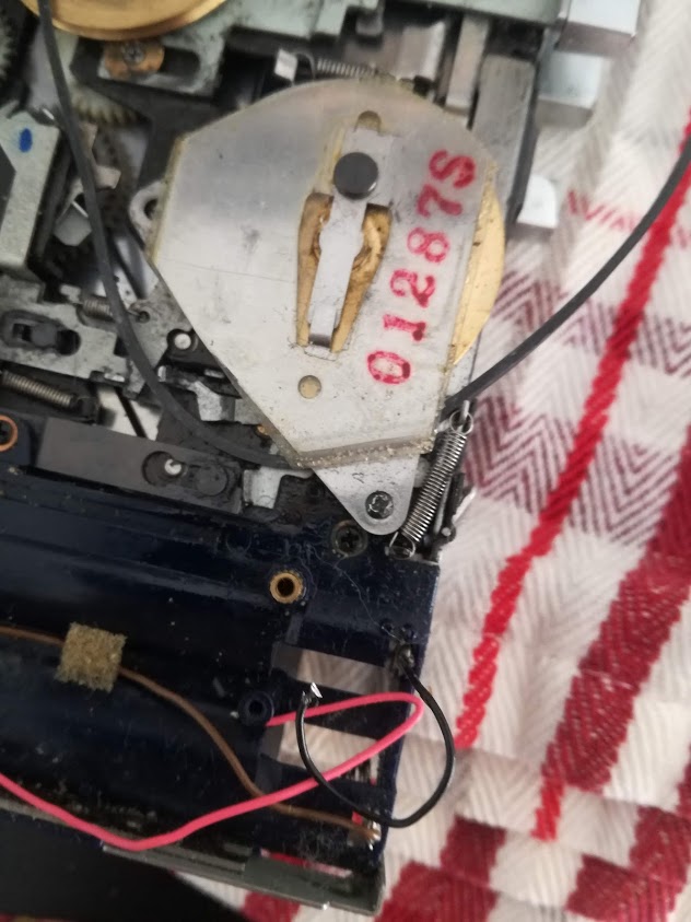

    Removing the PCB we can see the mechanism, it is evidently high quality; three brass flywheels, all metal components, a good amount of capacitors.

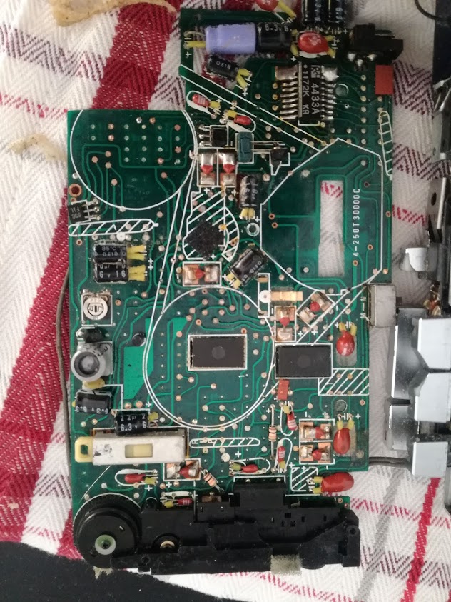

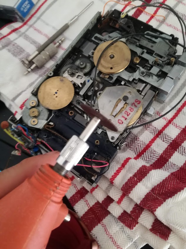

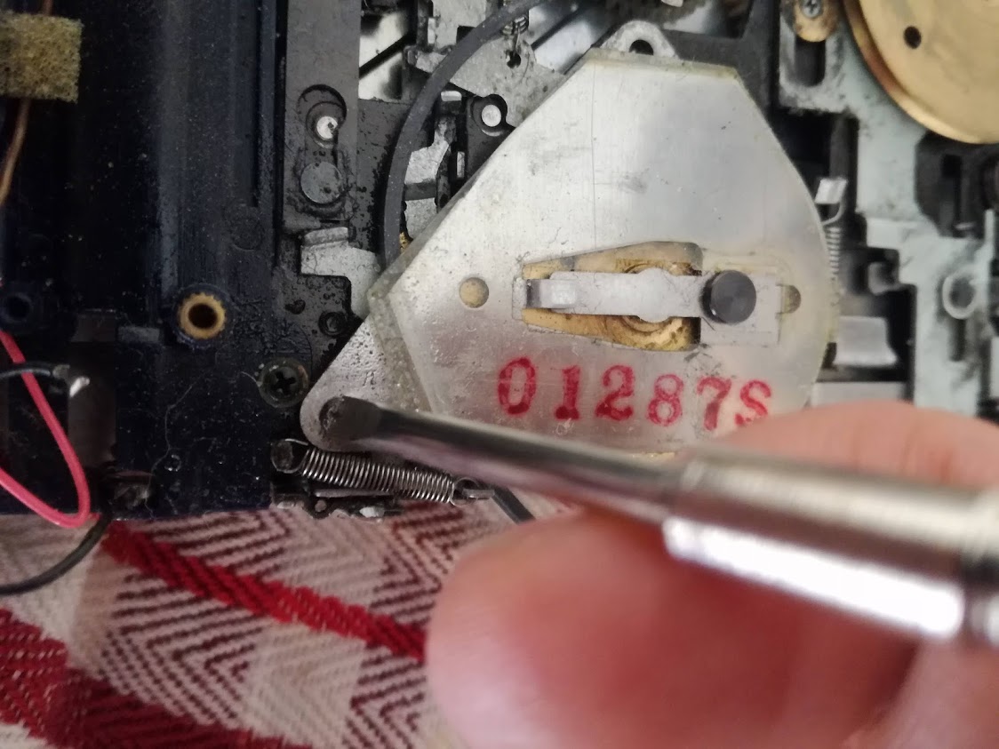

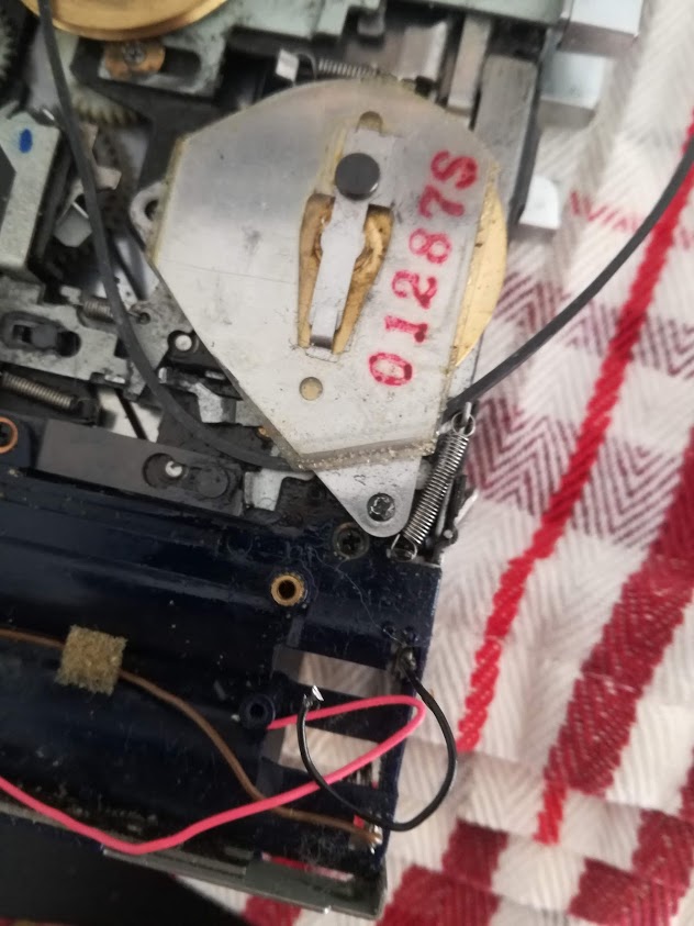

    Next the pcb was properly unsoldered, then dumped in a bowl of soapy water, Followed by being baked for 4-5 minutes in my oven at 60 celsius.

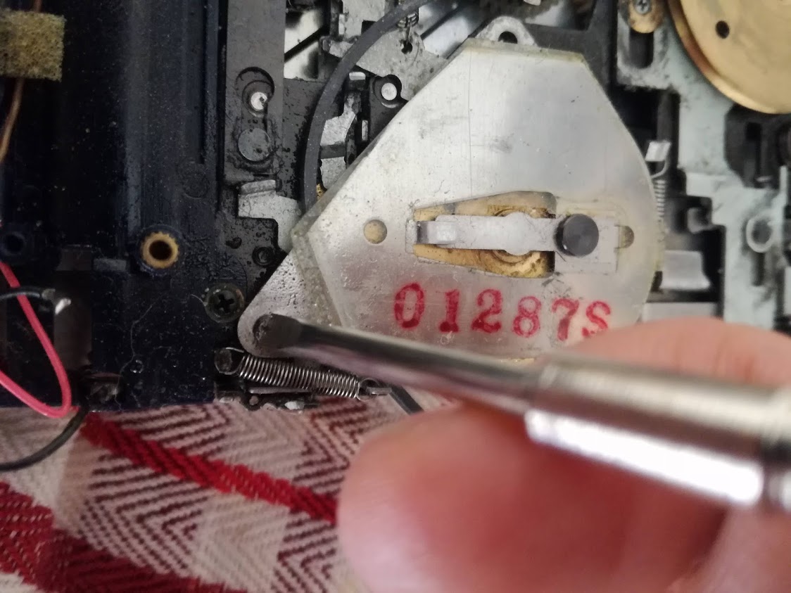

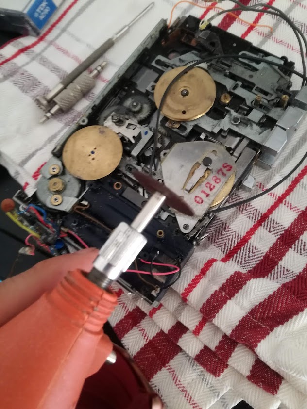

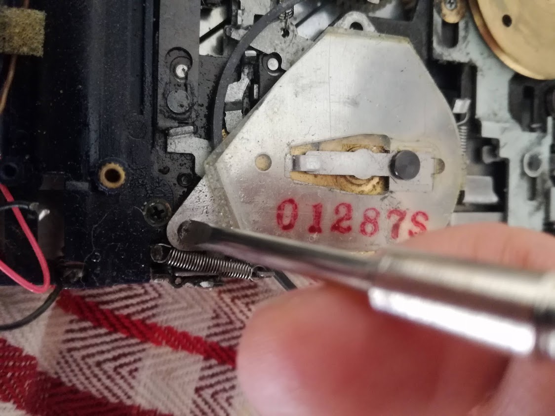

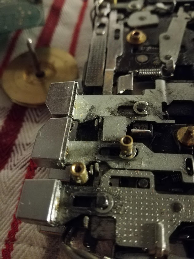

    To get to the mechanism I had to remove a guard cover to one of the flywheels, of course a stripped screw just had to appear. my dremel magically turned that stubborn screw into a philips flathead.

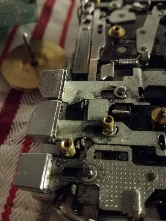

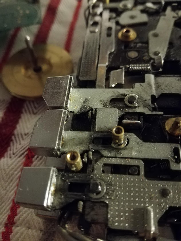

    Also was able to fix the problem i previously had where the buttons wouldn't stay down.
    As you can see, the mechanism at work
