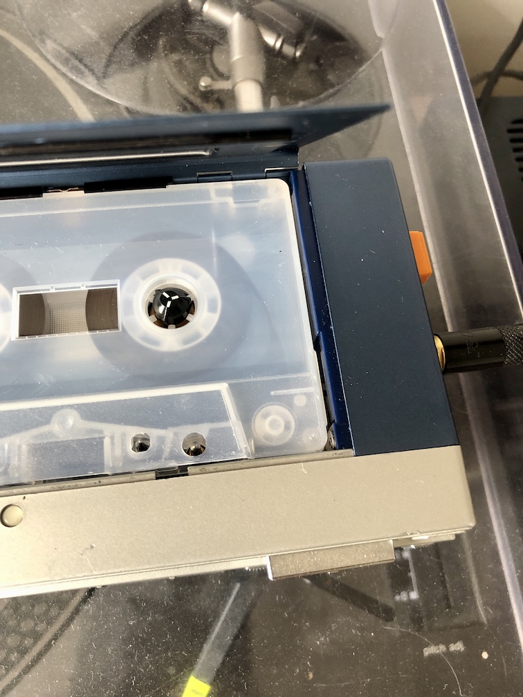

    I have tried with different tape length and the problem starts at the end of the tape when the tape increases at the take-up side no matter which tape length. After a few super proper cleaning it can play the whole tape, but in the end, the take up spindle starts to show sign of stopping, even though it doesn't fully stop. Just realised that I did not replace the pinch roller, how big impact could that have in this case? But it looks like the pinch roller pulling the tape perfectly while the take up reel does not. tps-l2.jpg :)

    The pinch roller is very important .
    Also I would check if the driving belt of
    take up spindle is tight enough .
    Looks like the spindle slower than it should be .
    regards

    The pinch roller is very important to sound quality, but problems with it would not usually result in the described symptoms.
    The problem appearing near the end of tape points to the spindle slipping due to lack of torque, so it's most likely an issue with the internal mechanism.
    You must check to see where things in the mechanism start to slip where/when it shouldn't.

    After checking the internal mechanism while playing the last part of an cassette I could see that the problem was between the idler tire and plastic part it connects to. There must have been som oil/grease there after the repair because after a proper cleaning the machine works like a charm. Many many thanks for all your help, so happy to have this piece working perfect again.
