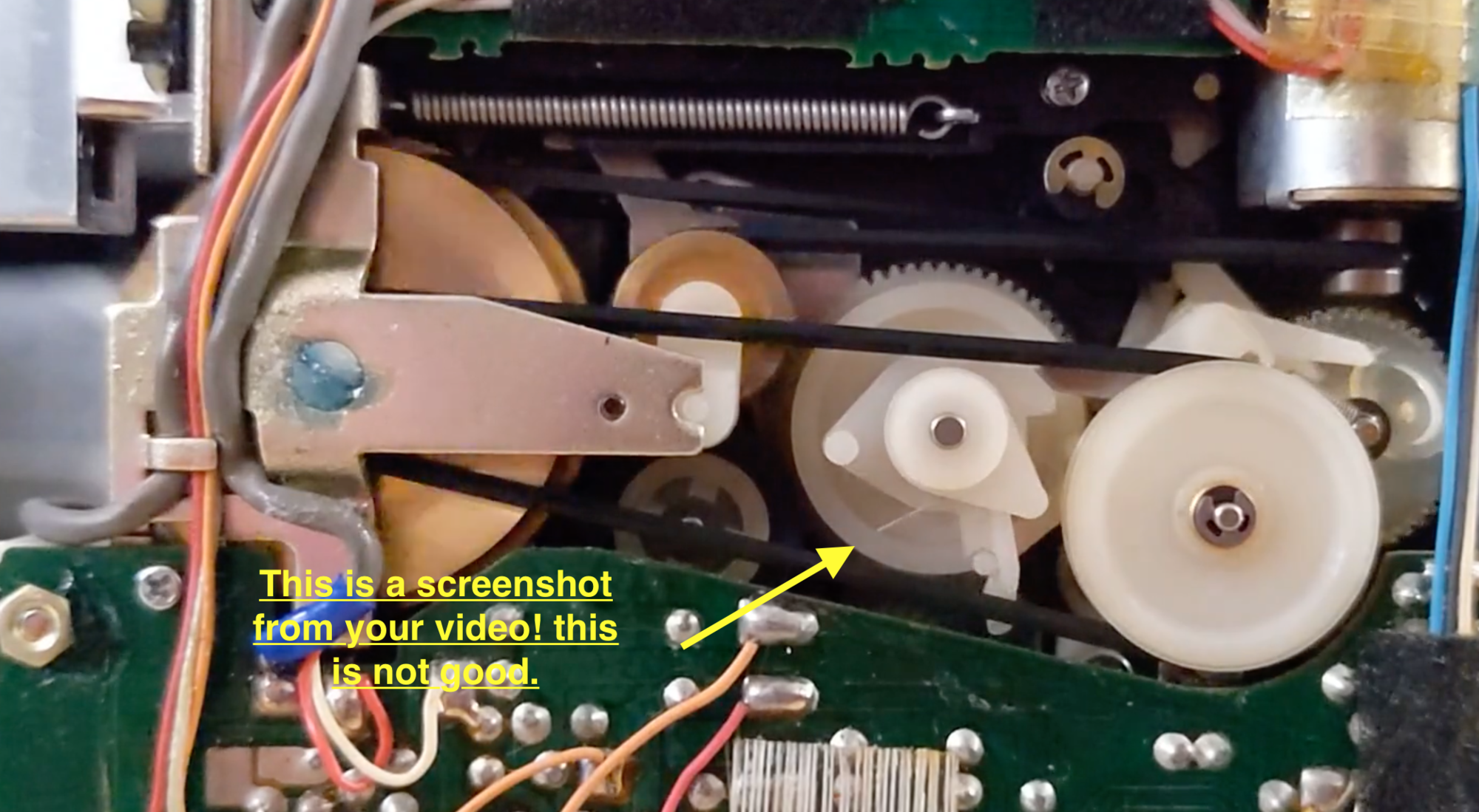

    Recently acquired a nice TPS-L2. The device wasn't in too bad a condition. Belts were still intact, but naturally had kept their form and started to glue to the motor shaft, and pulleys. I have replaced the belts, and cleaned the motor pulley, and other components the belts utilise, and have a Walkman that now plays.
    I made a few mistakes, initially I hadn't realised the spring for the auto stop mechanism had unhooked itself, but have that working again now. What I am finding at the moment is that the play speed varies. First I thought the AA batteries I had may be naff, so bought fresh new batteries as the ones prior had been in a drawer for a few years. I'm still getting an inconsistent play speed though, but it's not consistent enough, or intime with the mechanism. And having put the device back together following the re-attachment of the auto stop spring, I am noting that playback will slightly slow for a while, then all of a sudden, it's like it suddenly frees up and it's back to normal playback speed. Not seeing anything interfere with the drivetrain, and the duration of the slowness doesn't match with the RPM of the mechanism.
    If it's left off for a while, it can also be a bit sluggish, so perhaps this could be cap related and I'll need to strip it right down to check each capacitor?
    I suspect this is normal, but movement can also affect the play speed sometimes, like the inertia has an affect (note: not sudden jolts, but say, rotating the device can cause a wobble).
    I'd love to get this in a better working condition if possible. So look forward to your help.
    He's a short video I took of the mechanism out of the casing before I fixed the auto-stop. I might record another to try and catch the issue which may be helpful.

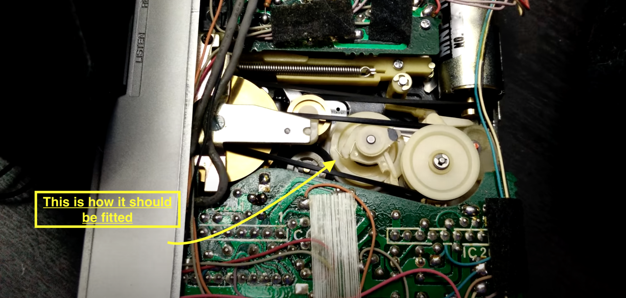

    I think you might be starting to look at the spring in the autostop mechanism.
    Valentin likes this.

    @tomtom87 yes, I did spot that when I noticed auto-stop no longer worked. It's fixed. What you see there is the spring had jumped over the plastic peg and rotated so it was back to front. The spring is still fine and the auto-stop mechanism still works. Furthermore, I reposted this on the Walkman thread which has had input from Valentin, and so far things are okay. I suspect the motor may need a clean as after a while of use it starts to struggle again but if you leave it and come back to it it's fine again.
