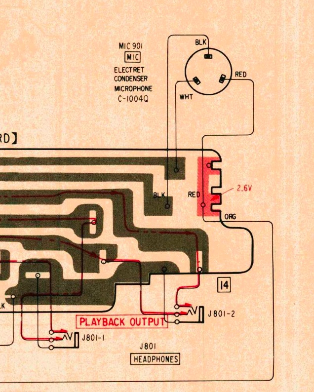

  13. davebush
    davebush Active Member
    163
    Sunny Blackpool. UK
    diagram
