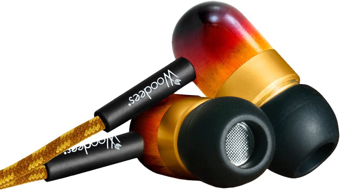

I had this same with Woodees IEM: h/p cord was so microphonic that any tap or even scratch against T-shirt was heard loud'n'clear
In this case it happens when I tap the Walkman The earphones I use or Headphones don't affect it in any way Very curious issue,doesn't affect much tbh but it's just there
