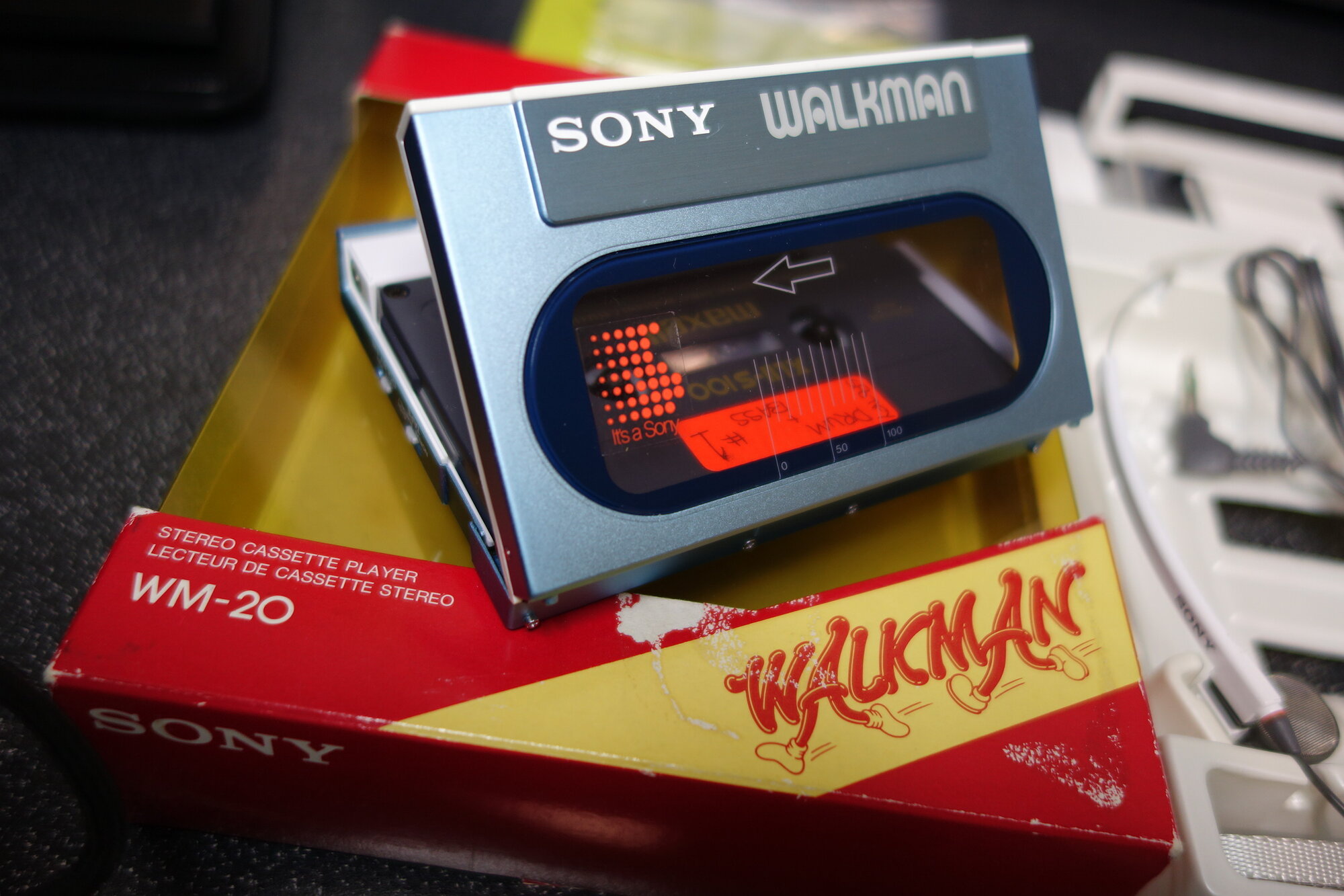

    I need your advice before buying a WM-10. What do you think about the noise while Fast Forward and Fast reverse of this very nice WM-20 here ?
    (at time 2,36)
    Also, the FF and REW does not stop directy but gradually when pressing stop as you can notice in this video.
    Are these things serious problems or just minor ?
    Thank you again for your help !!

    The device looks good overall, seems like the takeup reel ring gear is not cracked I cannot hear the typical tac-tac sound.
    The fact that motor doesn't stop immediately is normal on these devices.
    The FF and REW noise is caused by the intermediate pulley gear not making perfect contact with the reel ring gears.
    The metal on metal noise when unit is stopped is caused by the same pulley making contact with the back cover.
    This pulley has play in its shaft and the tension in the belt makes it sit at an angle not straight.
    It's a common problem on these models and fixing it is very involved, not exactly what I would call a DIY job.
    Fixing this issue implies removing the flywheel/capstan assy and the buttons mechanism which also contains the pulley.
    Then the bracket on which the pulley is mounted will need to be bent in the opposite direction the belt is tensioning it.
    It's pretty tricky to get it perfect and something I wouldn't recommend doing unless you are confident you can do it.
    The capstan retainer can be lost very easily if not careful and it will also wear if taken apart too many times.
    The service manual states it should be replaced every time it's removed, but that's impossible nowadays.
    In time, using the device like this may create wear on the gear teeth, so ideally you should minimize using FF and REW.
    The walkman works nice overall and I would go for it if the price is good.
