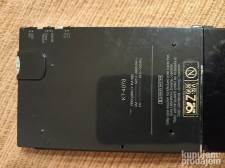

  3. George
    George New Member
    24
    Serbia

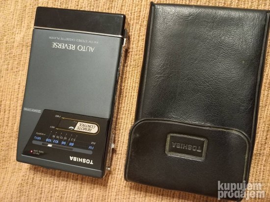

    Yes it is KT-4078 with radio.
  4. George
    George New Member
    24
    Serbia
    Here it is.
  5. Valentin
    1,493
    Thanks for sharing the pictures, I have never seen this one before.
    Please add some pictures from the inside to this thread when you do change the belt, so we can have a reference of its dimension. You can also measure its diameter.

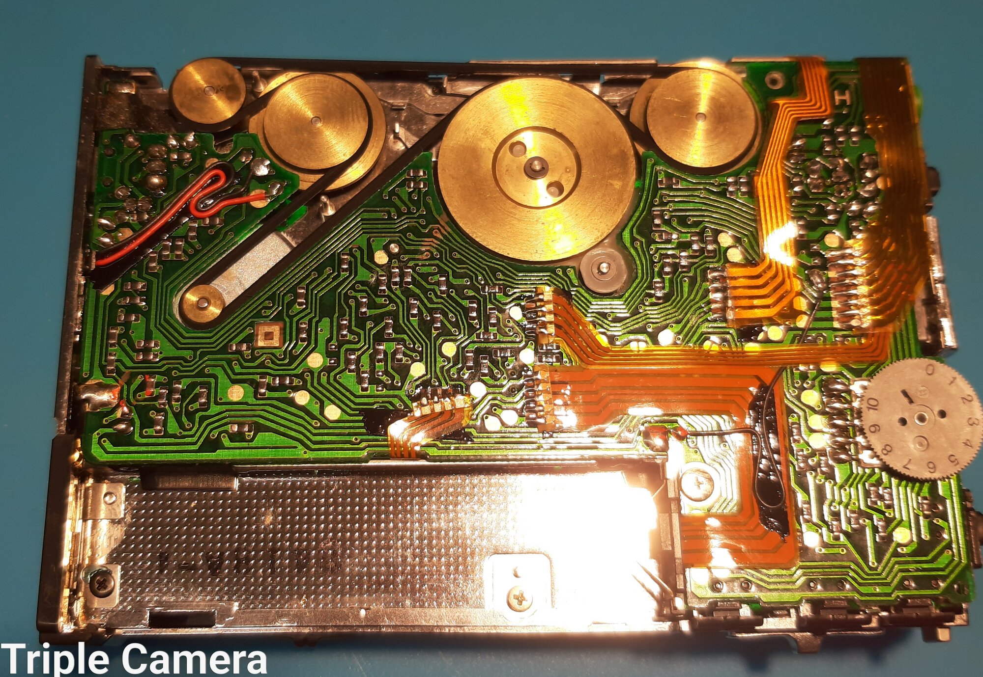

    Here is mechanism.
    Pulley far left is moving pulley.
    it accepts smaller diameter belts .
    Mine is 68mm .
    But i will get something like 70,73...
    It is 0.8mm thick
