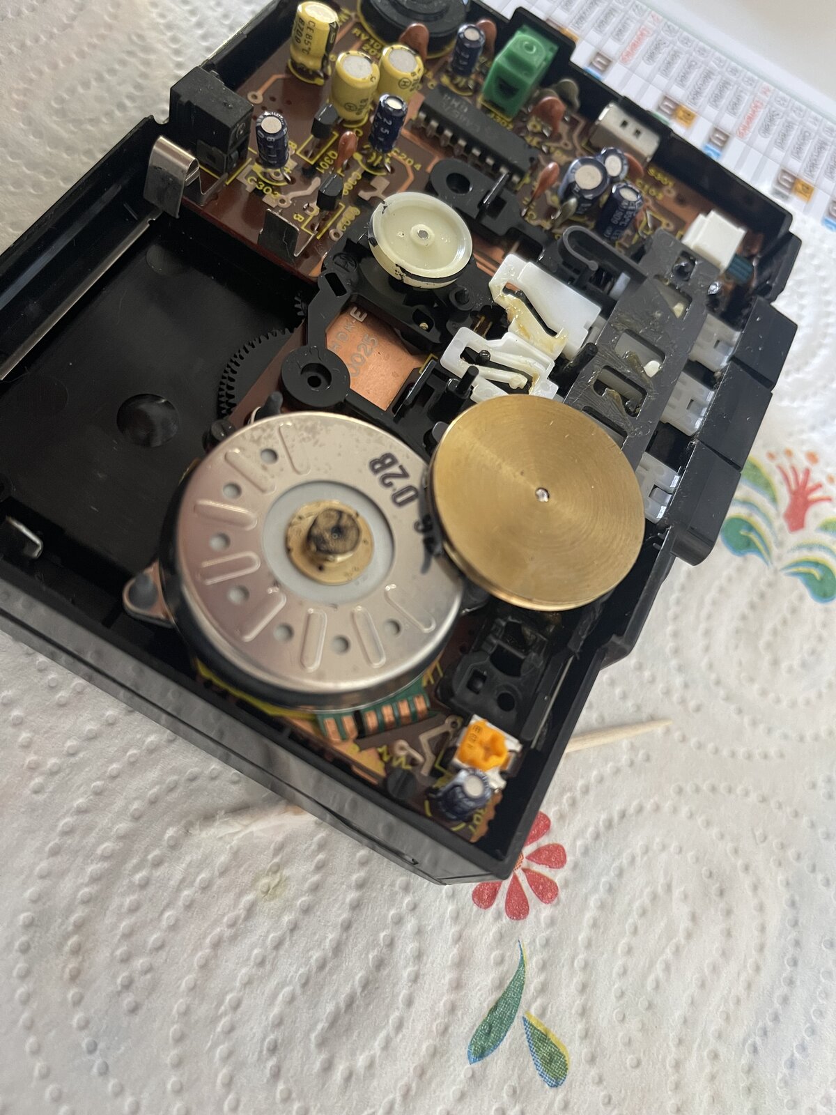

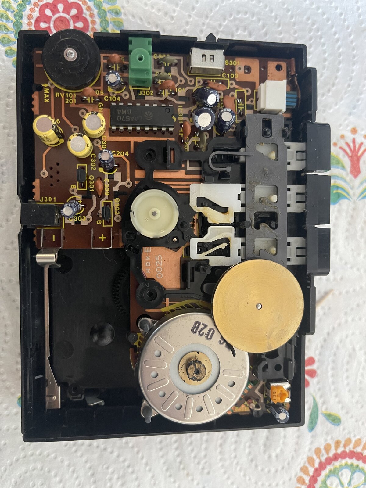

    I got a wm 31 and when I opened it the belts were melted, but the motor is not spinning, what can it be?
    How can I check if motor is done? It spins freely when manually rotated, it fells like electricity doesn't get to it[​IMG] [​IMG]

  3. Gene Wiseman
    Gene Wiseman New Member
    17
    NE Oklahoma
    I bet the service manual would show you where to connect voltage to the motor directly. I would guess it would probably be 2 of those copper looking places on that ribbon at the motor. I am guessing though. I wouldn't put voltage to anything unless I was sure.

  5. Gene Wiseman
    17
    NE Oklahoma
    It looks like the power goes straight to speed adjustment and from there to the motor. It's the red line on the schematic on page 6. I don't know how hard that is to follow on the actual board is but a bet an ohm meter would tell you. I am an old horseshoer and a knife maker. You probably need to get more qualified opinions than mine.

  6. Valentin
    1,568
    Looking at the schematic, it's obvious the entire motor servo circuit is inside the motor apart from R307, R308 adn RV301.
    Most likely problem is one (or more) of the 4 connections to the motor is open circuit.
    Motor servo could also be faulty if unit has been powered with reversed polarity, but that's unlikely to have happened.

  7. Mornings84
    Mornings84 New Member
    6
    New york
    Hi! I got a multimeter today and I was checking if the motor was getting power, while I was doing that it started working! I don’t know how but now it’s working when I press play, I now ordered the new belts and waiting for them

  8. Rudy Rodriguez
    Rudy Rodriguez Member
    54
    Tucson, AZ
    Maybe your multimeter probe pushed on a dry solder joint?

  9. Gene Wiseman
    17
    NE Oklahoma
    That sounds like the most likely scenario to me. Finding it to fix it might be tricky now that it's working.
  10. radiorich
    radiorich Active Member
    176
    Washington state
    Mornings84,
    One thing while you have that unit apart you should get some really light oil I like using Zoom turbine oil it will help that motor to last longer and yes it could been just bad connection I have a digital microscope that I use .
