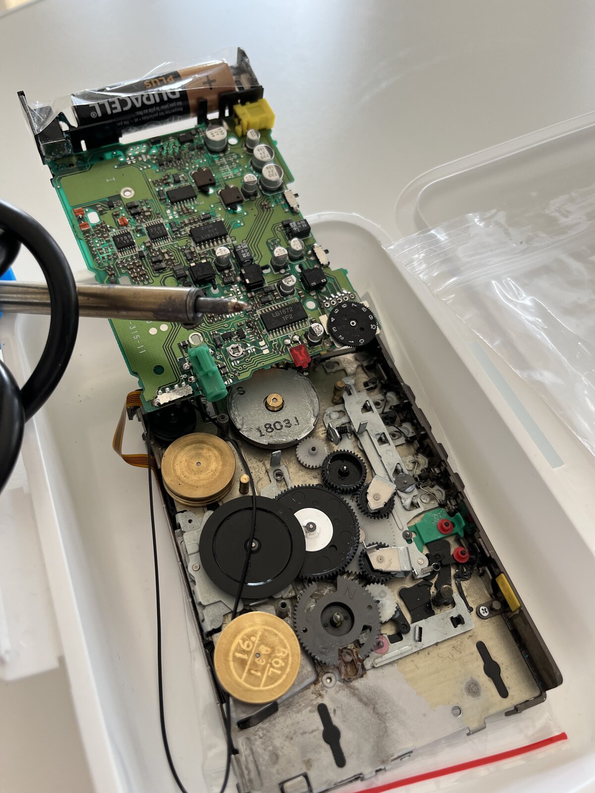

  5. MarcoDB
    MarcoDB New Member
    10
    Austria
    Hello friends,
    I am still pondering how to replace the motor drive capacitors with my limited equipment and skills. I have a very basic 15w soldering iron with a too large tip, but I can buy a thinner tip or sharpen my tip. I also have a hot air gun with digital temp setting that should reach 300-350°C. However, I fear that I will melt surrounding components such as the volume wheel or red LED light. Accessing the cap pins, especially for the cap near the volume wheel, seems quite challenging. Is it possible to use something like a needle or steel wire connected to the soldering iron to heat the cap pins? I guess it will be hard to reach sufficient temperature in this way.
    Maybe I am over concerned but I do not want to do damage.
    Do you have any recommendations?

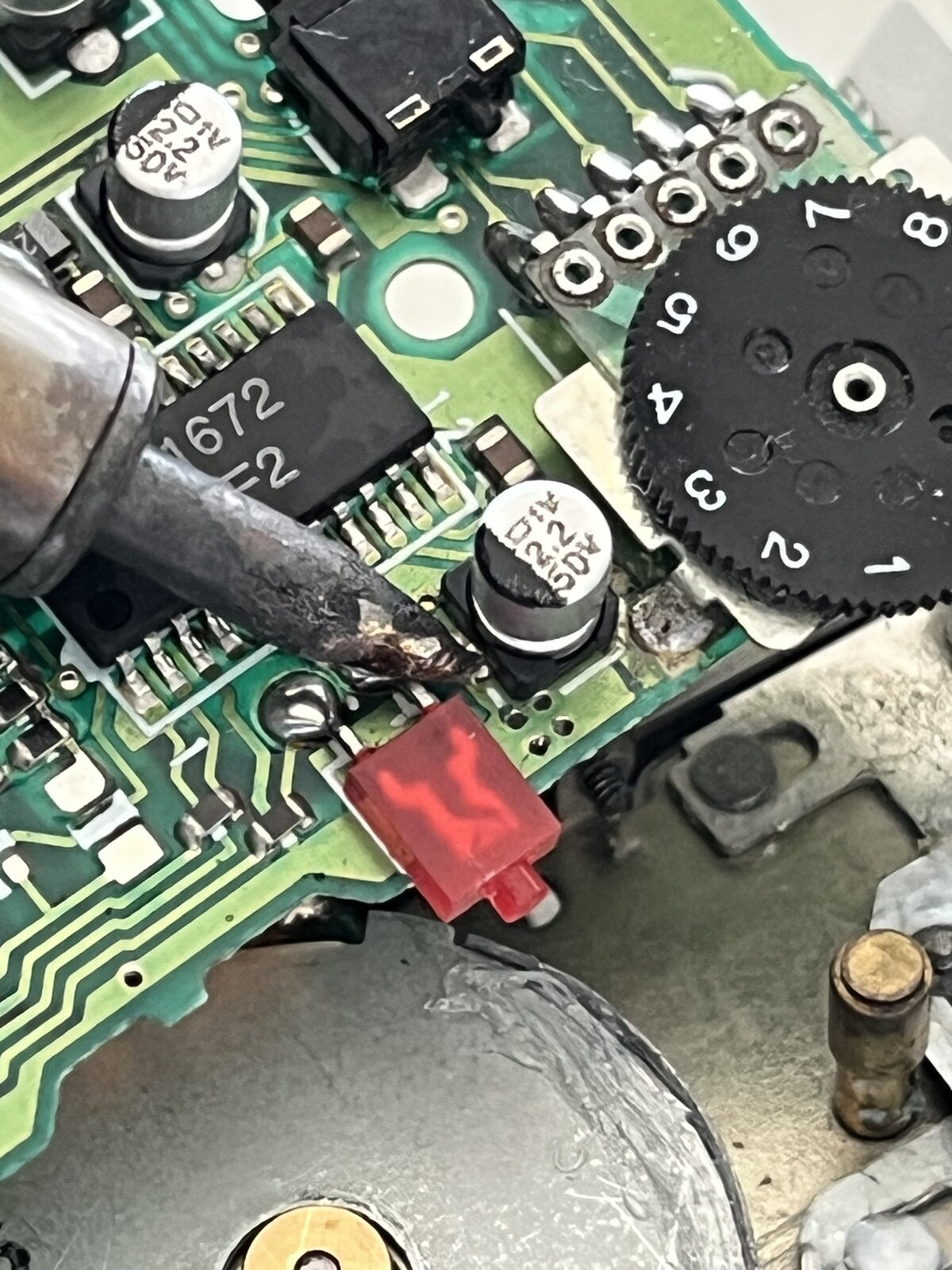

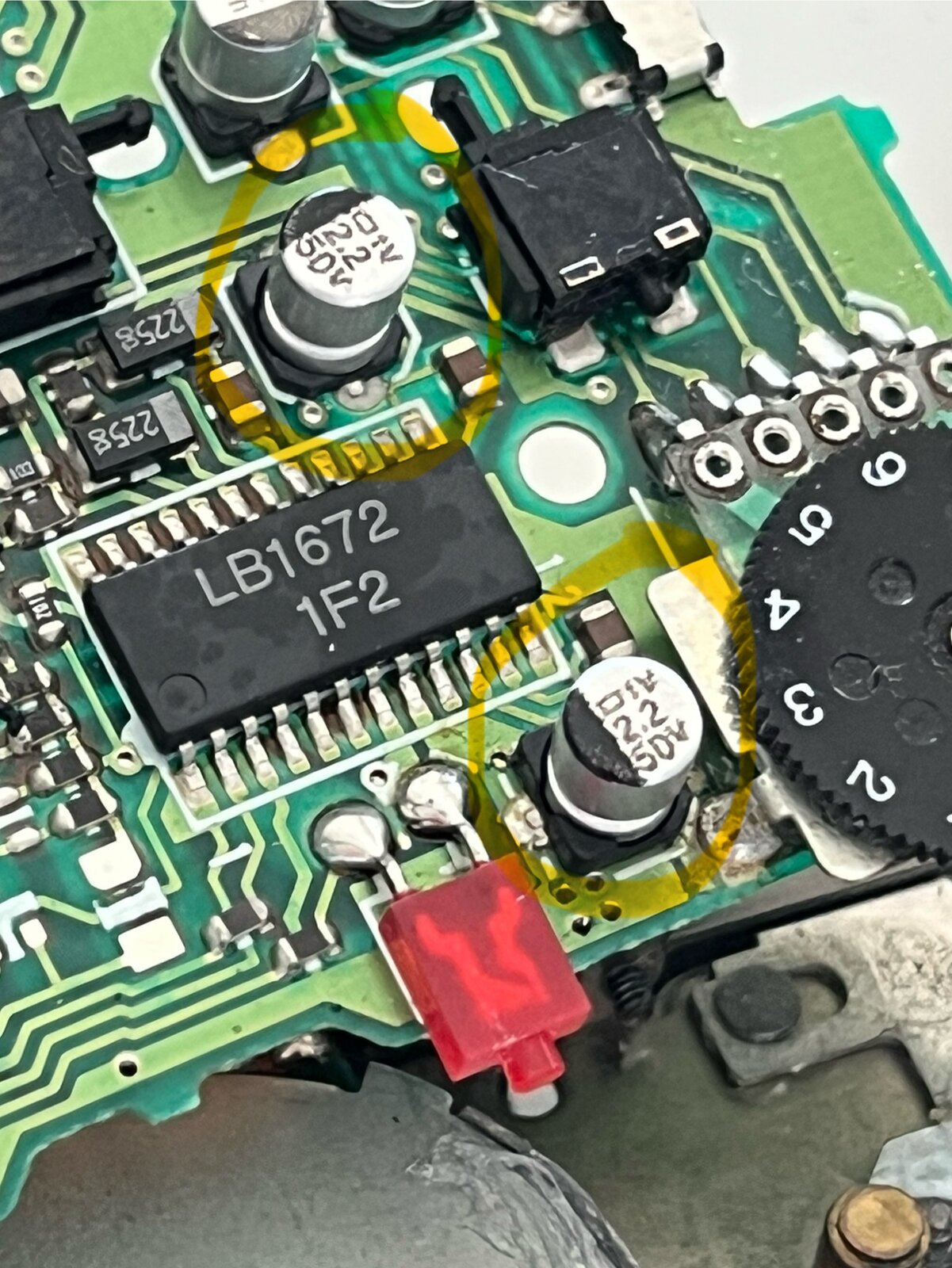

  8. MarcoDB
    MarcoDB New Member
    10
    Austria
    Hello,

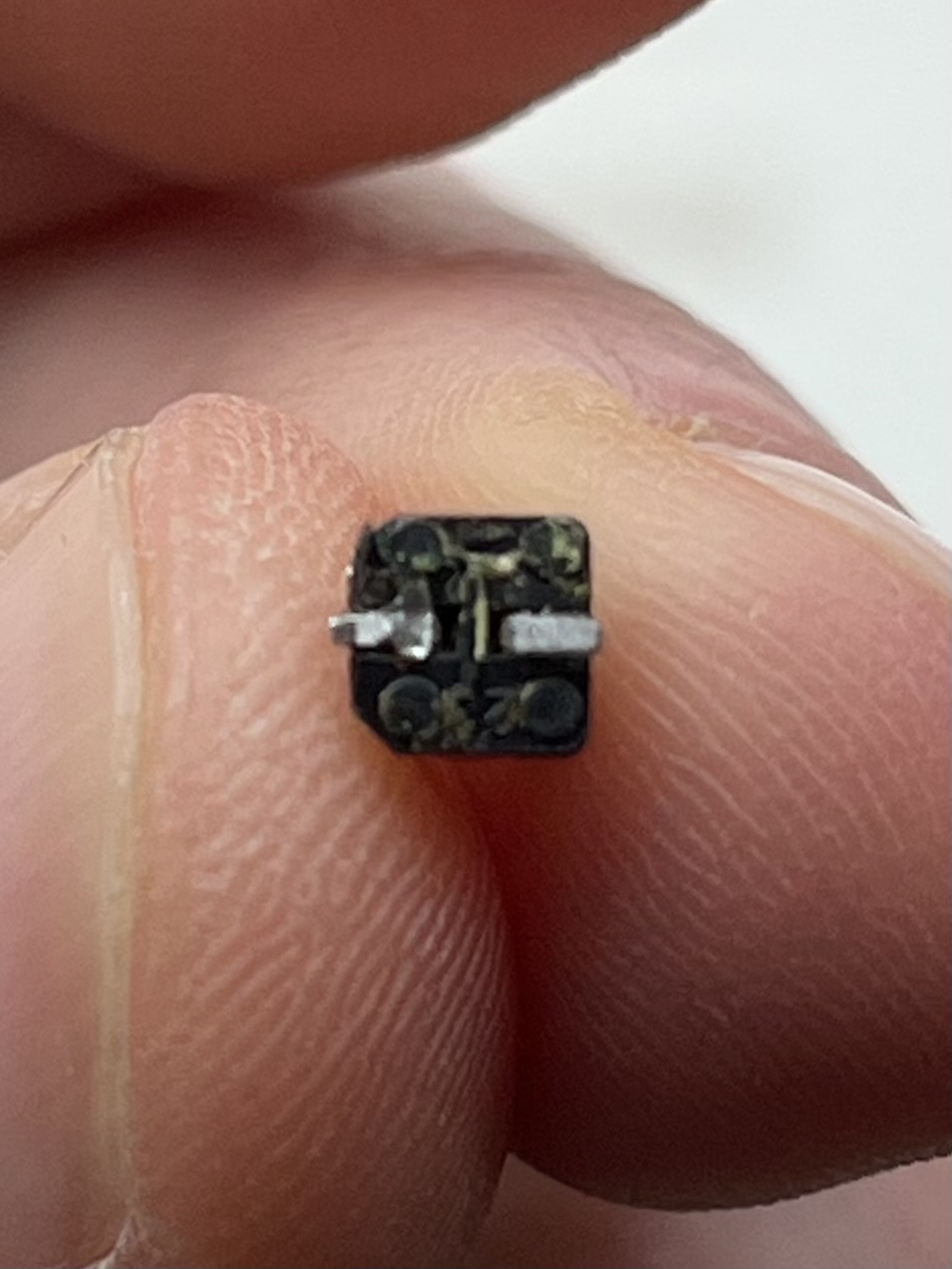

    I procured a proper soldering station and could remove the two caps close to the motor servo IC. One opened up when pulling it, the other is still ok. Now, I have further questions for you:

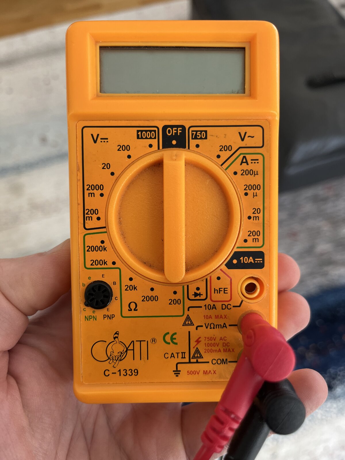

    -I only have a basic electric tester (see picture) which as far as I know has no specific mode to test capacitors. I wanted to check the cap that I desoldered, is there a way to test it without a specific capacitor tester?
    -Without a way to test for good or bad capacitors, shall I in any case desolder and replace all electrolytic capacitors on the board? I am lazy :) If so, where do you recommend to buy new caps? I am in Austria.
    Thanks for your support, this repair is much more work than I thought but it is quite good for learning.
  9. Valentin
    1,615
    Given these models are known for having problems with capacitors, think it's a good idea to replace all capacitors including the 2 x 22uF@4V sitting on one side.
    Caps you can buy at any electronics parts distributors, but being in Austria I would try TME first since shipping will be cheaper.
    If you want easy soldering, I also recommend going for SMD tantalums instead of the electrolytics, in the smallest footprint you can find at TME (for most smaller ones it will be 1206).
    The 330uF@2V you're likely to only find in tantalum version and with 4V rating, but the 4V tantalums are smaller than the original 2V so this won't be a problem.
    MarcoDB likes this.

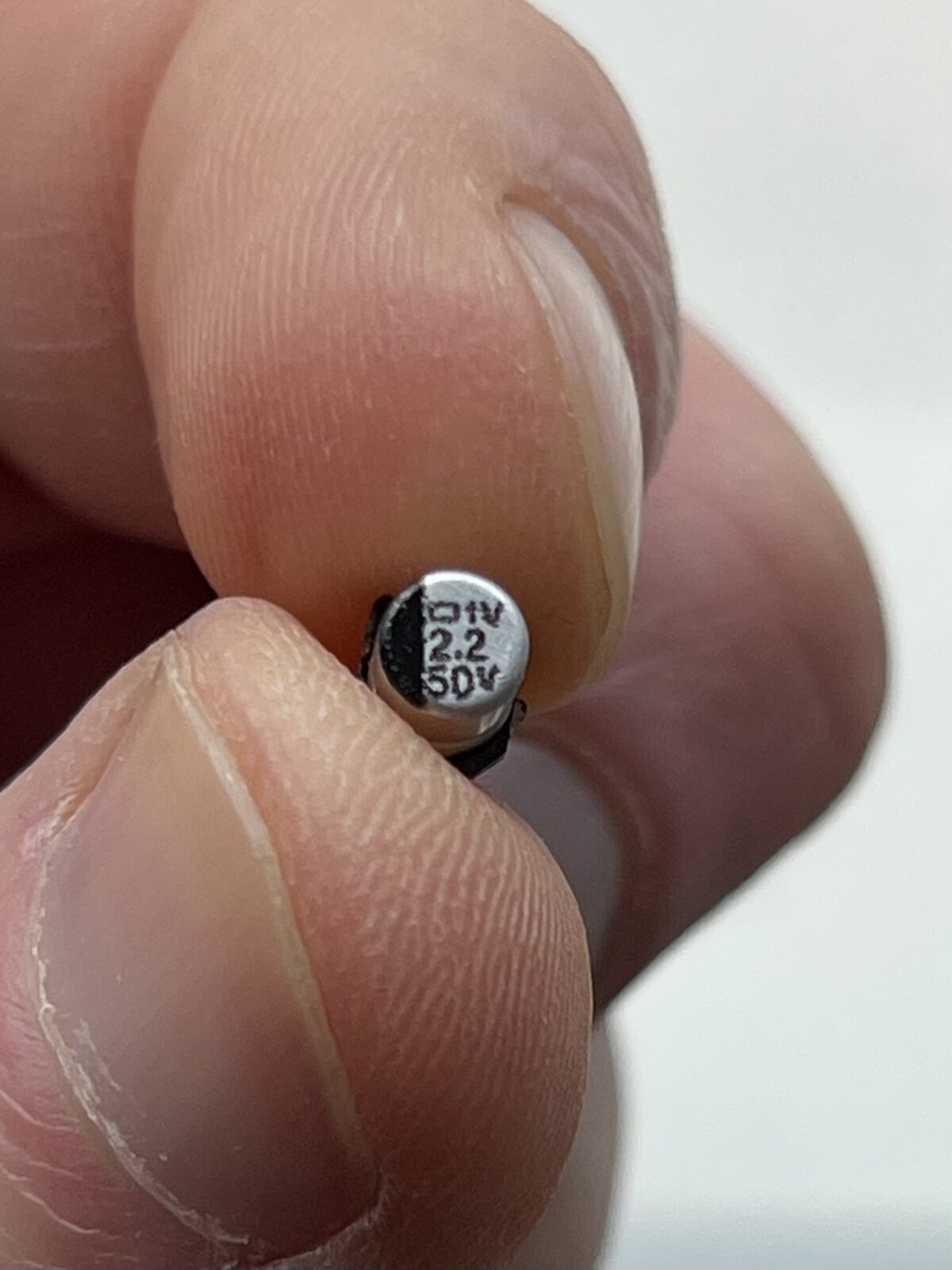

  11. MarcoDB
    MarcoDB New Member
    10
    Austria

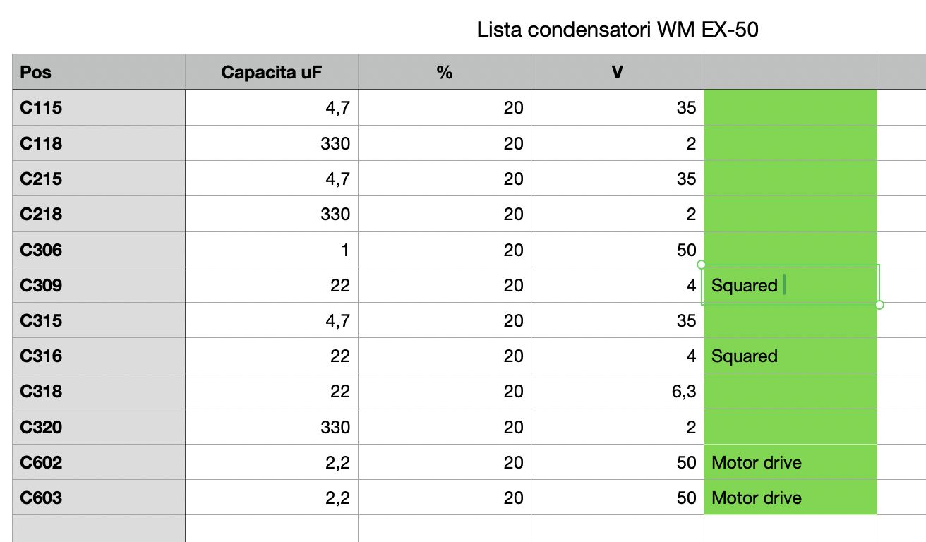

    Hello,
    I am sorry to bother again but may I ask if the list of capacitors to be replaced is correct? I think my list should include all the cylindrical electrolitics, plus the two 22uF@4V that are squared and mounted on one side.
    I just want to be sure before I go and order them:

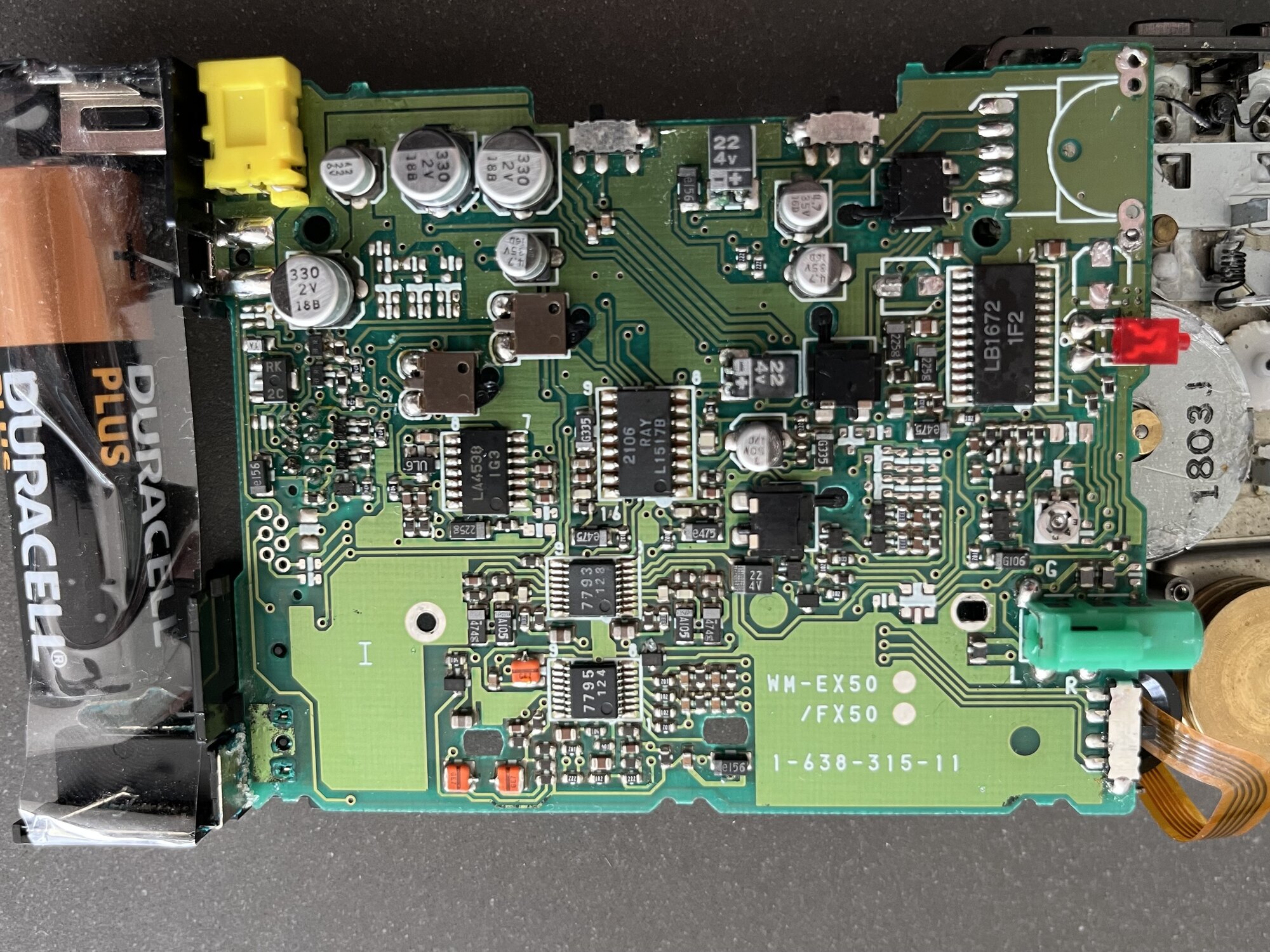

  12. Valentin
    1,615
    Looking at the board you have:
    - 330uF (3pcs)
    - 22uF (3pcs - 1 round + 2 flat)
    - 4.7uF (3pcs)
    - 2.2uF (2pcs)
    - 1uF (1pcs)
    If you go for SMD tantalums instead of electrolytics, you can replace all 3 x 22uF with same tantalum.
    Go for the smallest you can find, 1206 package if tantalums.
