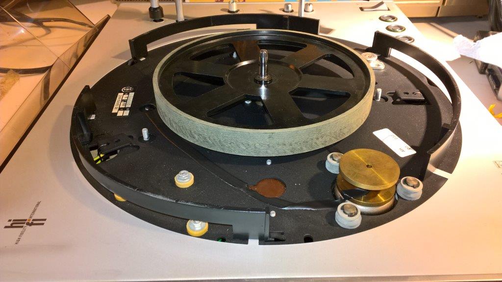

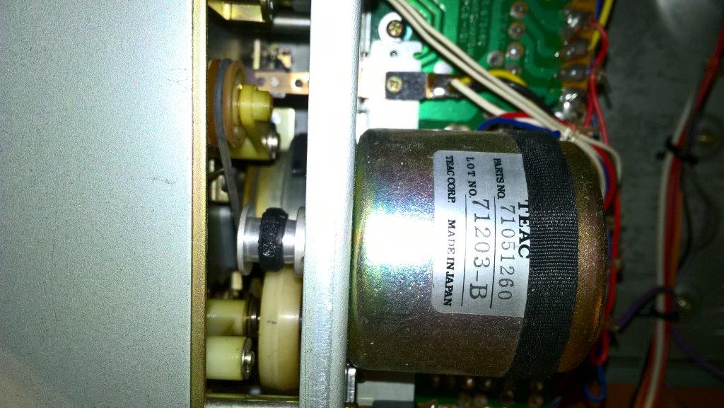

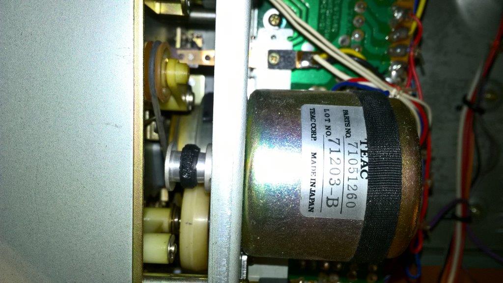

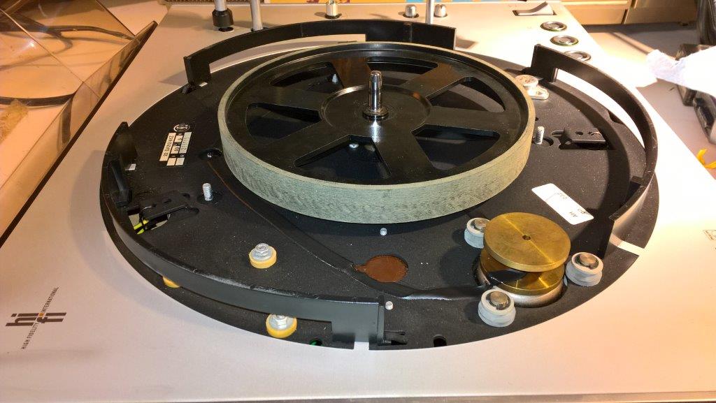

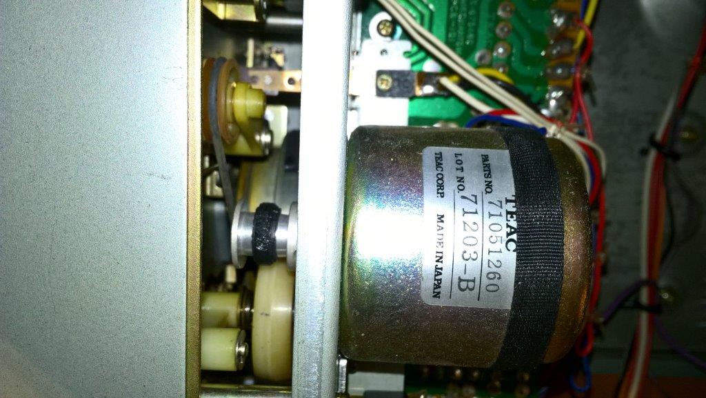

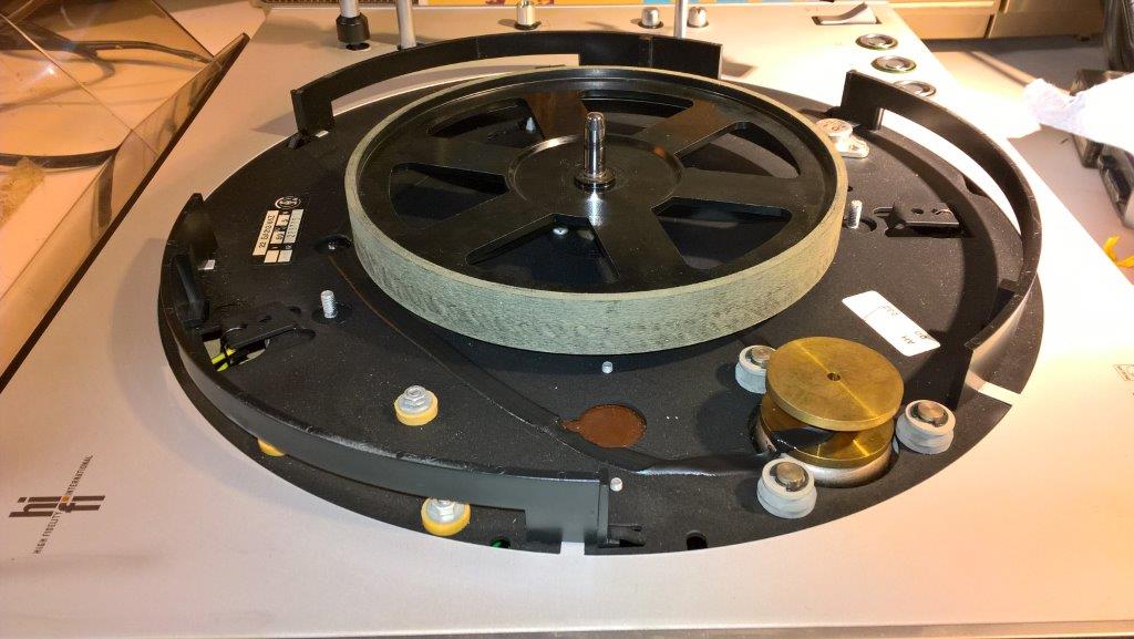

    I bought a small stack of gear recently and I was refreshing it with my usual treatment of DeOxit, Belts, and a good scrubbing. This Stack was kind of cool, a TEAC A103 Tape Deck, A JVC Plastic Turntable (kinda nice compared to Technics), a really old Harmon Kardon 330B Receiver and a beautiful little Phillips 212 Turntable.
    I might have turned them back but I saw another Phillips 212 a couple months ago and I really loved the look of it, it's so 1970's in a cool way and I kind of wanted one since seeing it in the flesh and this work out great. I know some of you are saying....Mister X, you hate Phillips ever since your 32" TV blew up 366 days after you got it and the warranty only was good for a year, this was a little different.
    I expect most of this old gear to need work so I usually buy without checking it out closely. They did tell me the Teac A103 needed a belt but everything else worked. Yes the A103 needs a belt, I didn't want to do it tonight but one of the guys on AudioKarma posted that there's only four screws to get to the belt. Out in the shop it looked like a major job.
    The Phillips 212 didn't have a plug on the back, luckily it was on the inside and I screwed it back in. It's a weird connector with a flat blade and a vertical blade. I took a couple of hot wires and it seems to work fine, I just need to find the adaptor.
    These are both going to need belts but it was fun being inside of them and checking out 1970's finest mid-range.

    What's the deal with the power cord, It's out in the shop but I think it has two blades, one is perpendicular to the other? Does it have a proprietary cord?
  10. nickelindimer
    nickelindimer Active Member
    415
    Chicagoland
    Well that's an odd one... and to be honest, I don't recall having such an issue with it. It sounds as if you got ahold of a foreign version, and the cord is proprietary to the country it sold in. Which brings the question: What language are the labels in?
