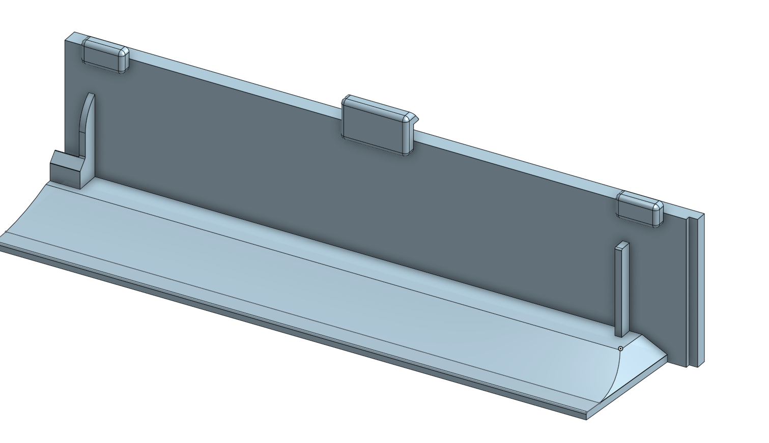

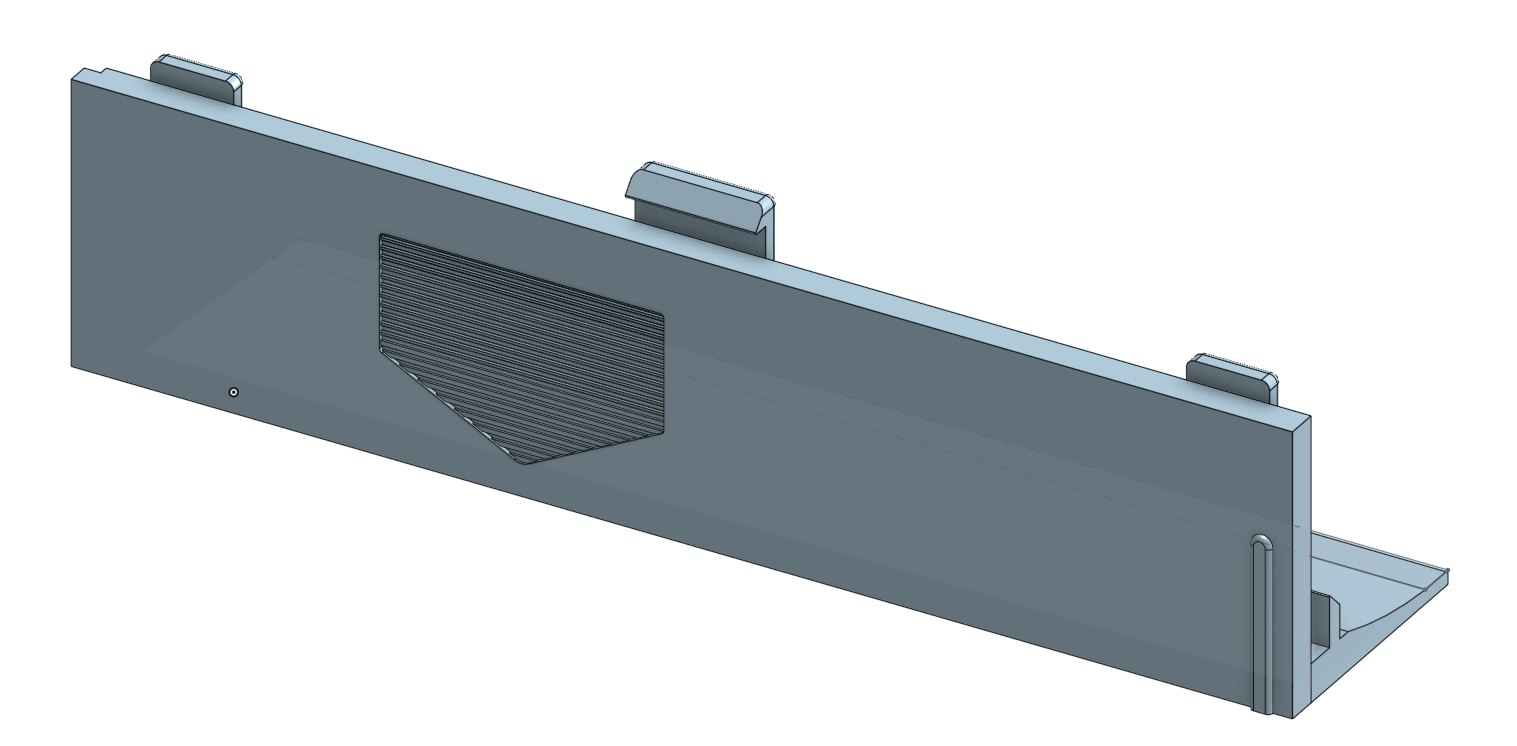

    WM-F10 ii battery cover

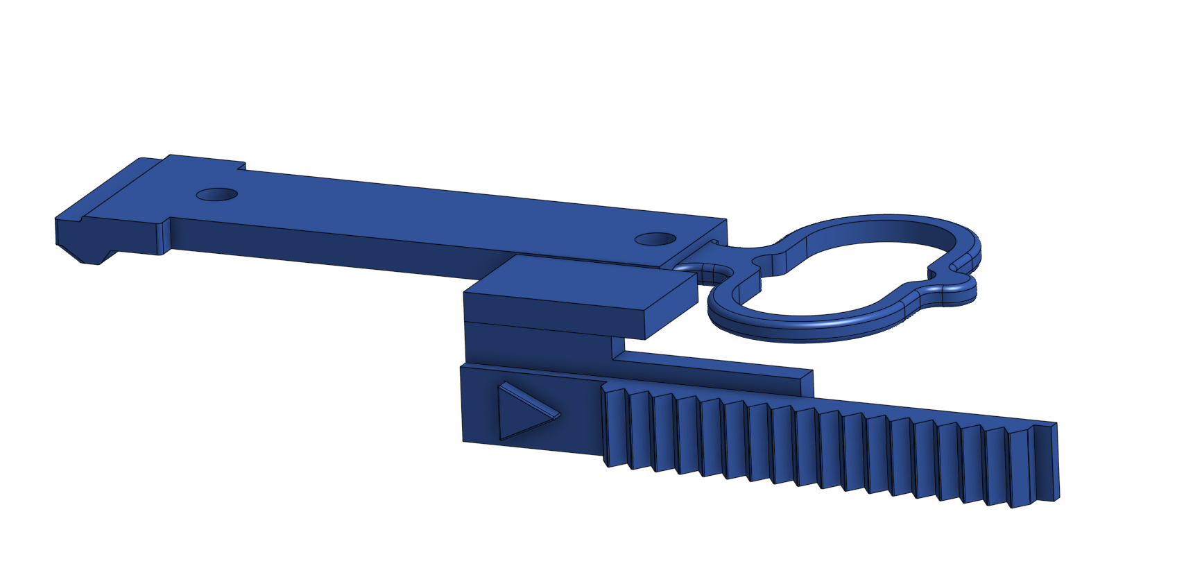

    That annoying spring latch thing that usually breaks in the F10-F20/10-20 door covers
    And as for unfinished parts
    Take up reel replacement since they commonly break, planning to print it in 2 pieces, then it can be glued on either side
    though depending how it works out, thats subject to change

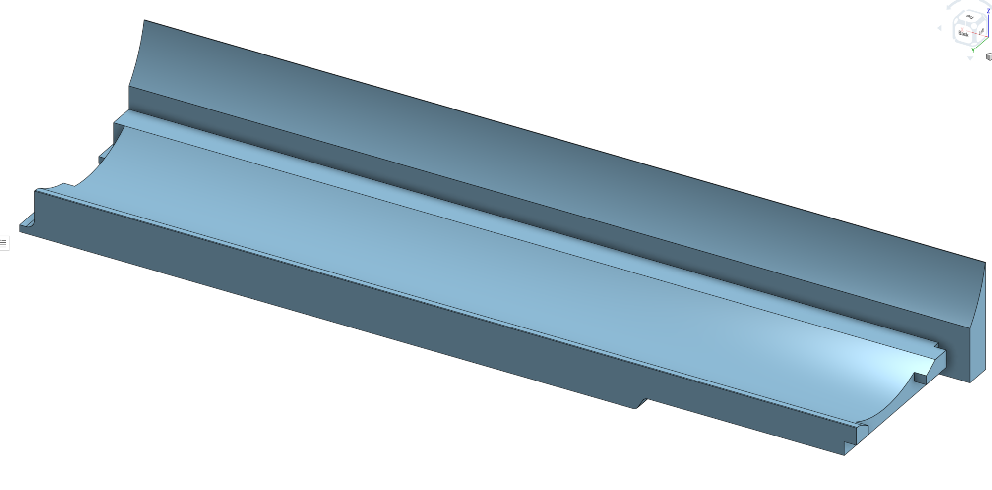

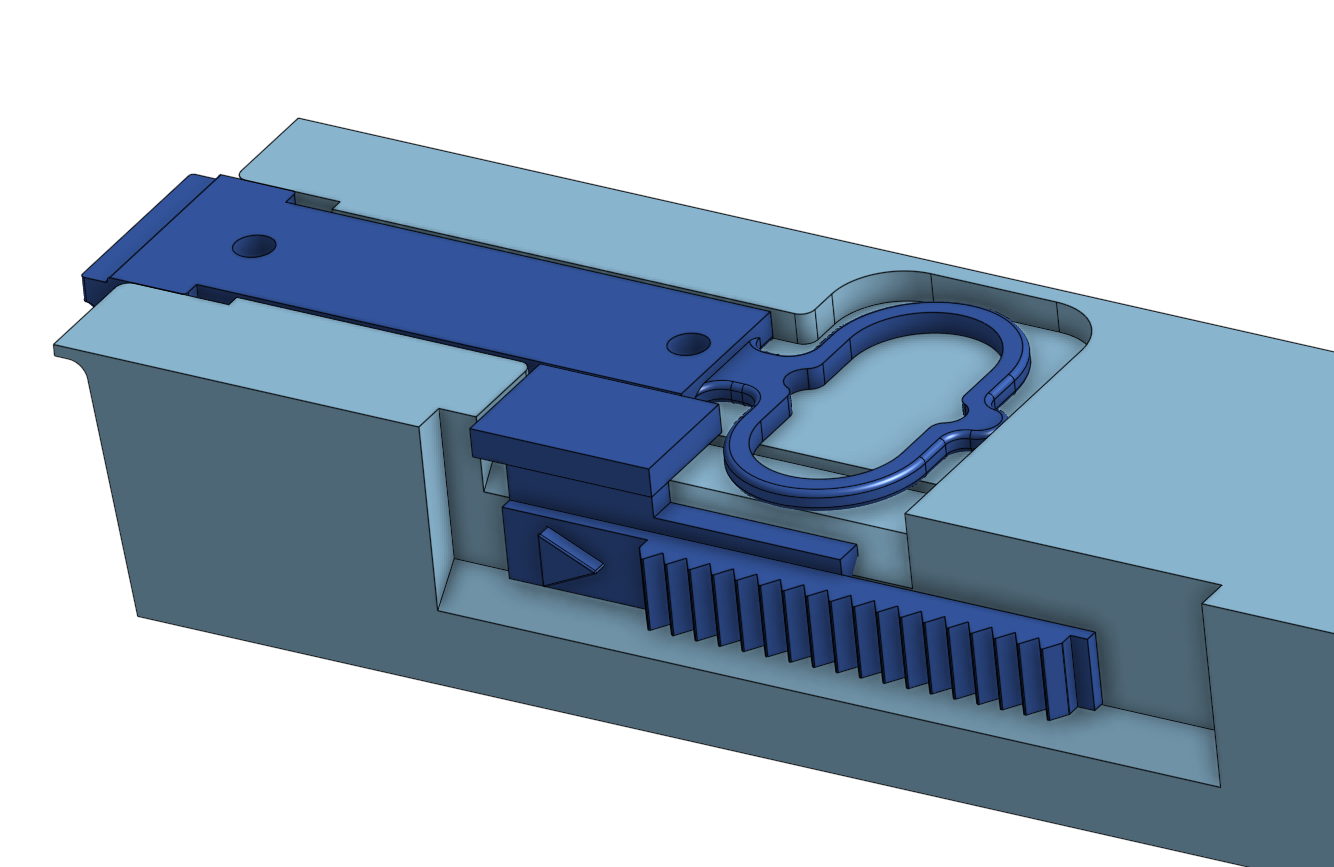

    and lastly, as im working on the F10/F20 door currently this is a model of the bottom piece im almost finished with, think im going to wind up remaking this one later on as i think some of the measurements are slightly off
    *edit, tried to update the F20 door piece using imgur link, and it seemed to not format right, not sure why there are 2 attachments of the old image below now, but im going to post it separately below

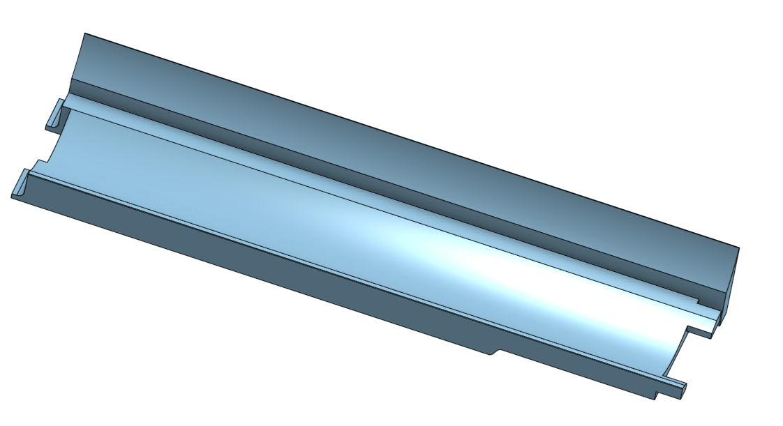

    since it didnt format right on the original post when i edited it and created 2 attachments of it instead, heres a separate comment showing how it looks so far
    again, think i might redo it later on since i dont think its completely right
    and this is just after correcting a simple mistake, i didnt realize i forgot to shorten the plastic pegs on the end, this is basically the complete visible portion of it, and im going to add the cutout on the bottom of it for the latch now

    placing the pieces together, there seems to be some small corrections that need to be made
    but it looks *generally* correct, ill have to check the spring dimensions when im able to print it, and use an original piece to test it with
    it *seems* ok, but from here i think im going to wait on doing anything new from here so i can check the general dimensions of these parts before going further
    with parts like these its crazy how much .1 mm here and there can add up to big differences (which ill include is *extremely* hard to measure with THAT much accuracy)

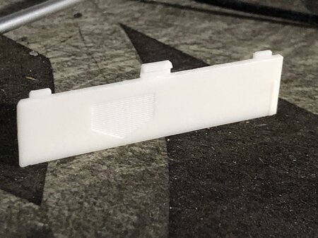

    update, the calibration print finished, surprisingly it turned out as good as i think could be expected of this printer
    im going to run the f10 ii cover through it now and see how it comes out, will likely come back with an update in maybe ~2 hours

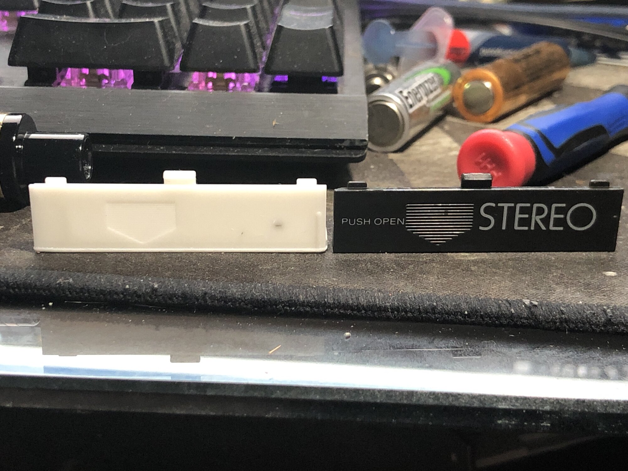

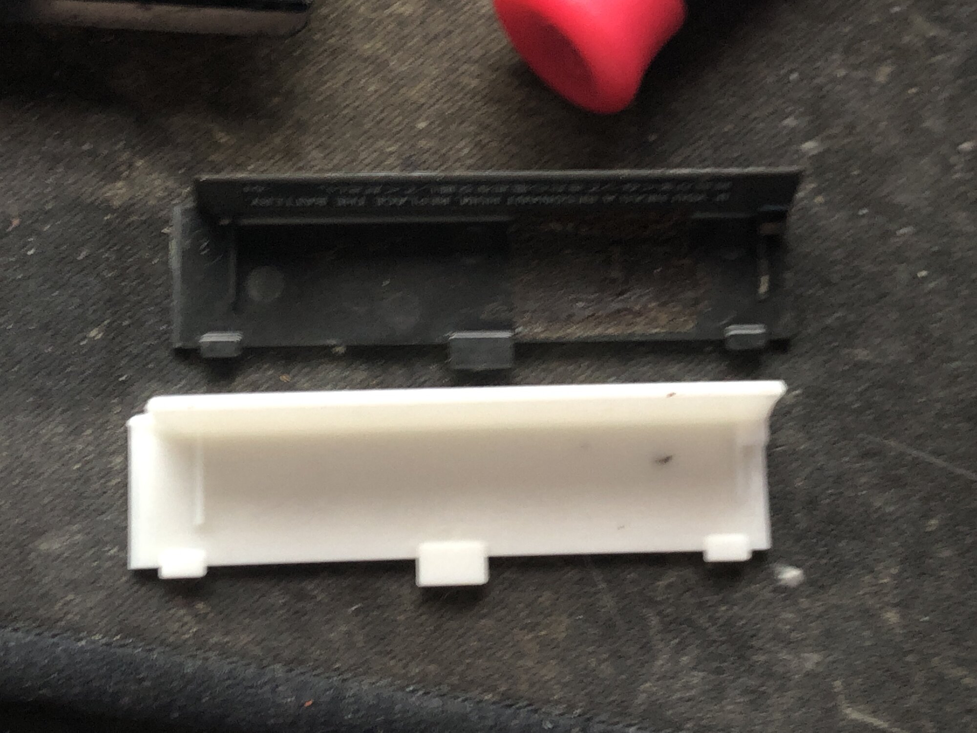

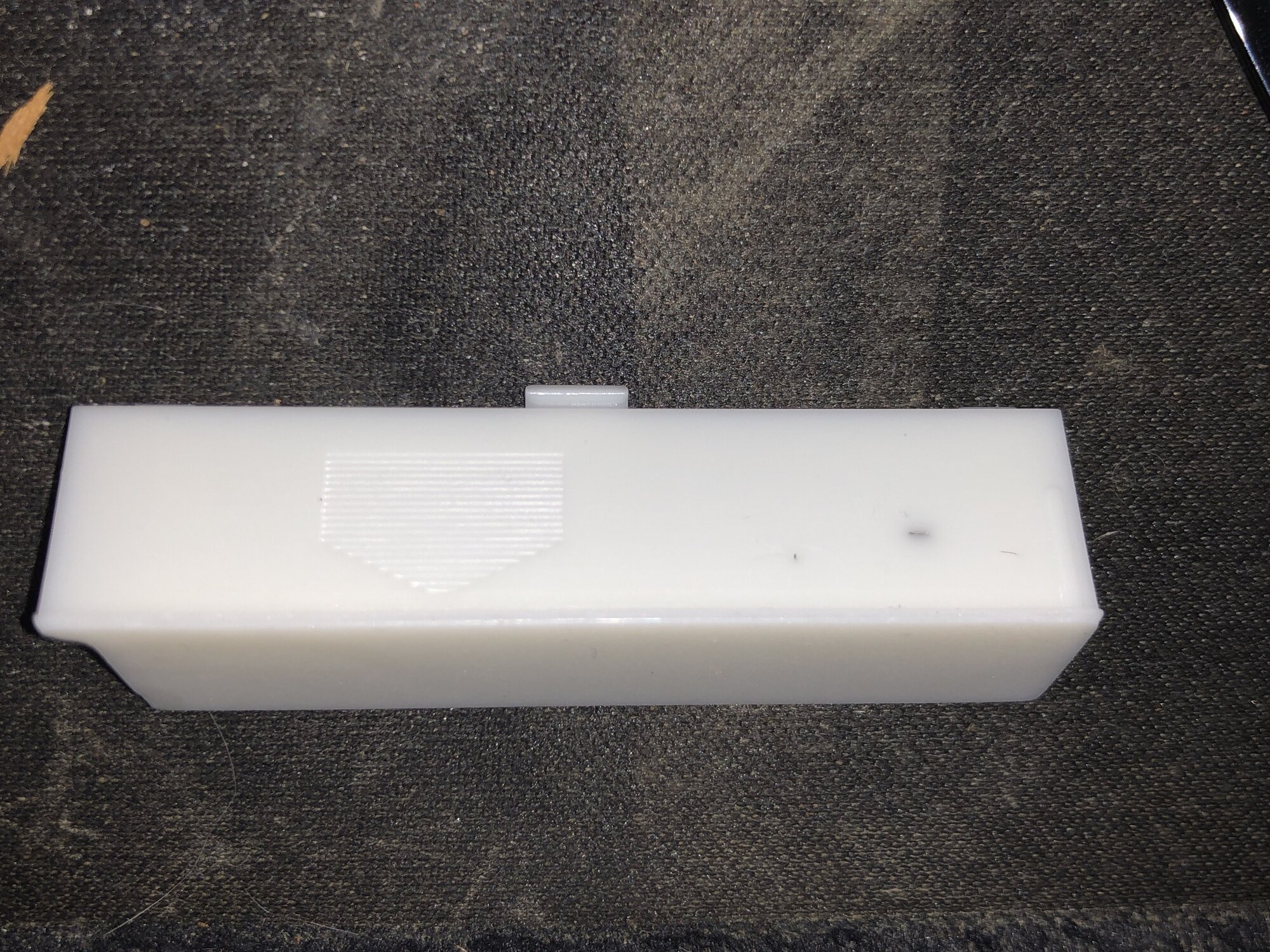

    heres the results of the first print (placed near an original for reference)
    *note the one im using isnt cured, this is just for reference while the 2 others are curing*
    using this one since it picked up some crap while printing, probably should have cleaned the vat before starting, but these will get painted regardless so any imperfections wont be visible anyhow
    *and ignore the state of my desk, its been awhile since i cleaned it*
    i noticed they all had this lip at the bottom, so next time im going to place them on supports and that should prevent it in the future
    also, i made the bottom too long, ill correct that before printing the next round
    here it looks like the front face is spot on though, well except i might have made a few too many ridges on the grip area, so i might redo that later on
    and the rear area of the front, looks spot on
    ill probably use these to practice painting them, see if i can get these looking like the originals paint, since the bottom is too long and they developed a lip in printing
    so ill revise the model, add supports, and likely post another update in a day or two, but till then, this is what i got to show so far, should have some way better results when i post back on here and make aforementioned revisions

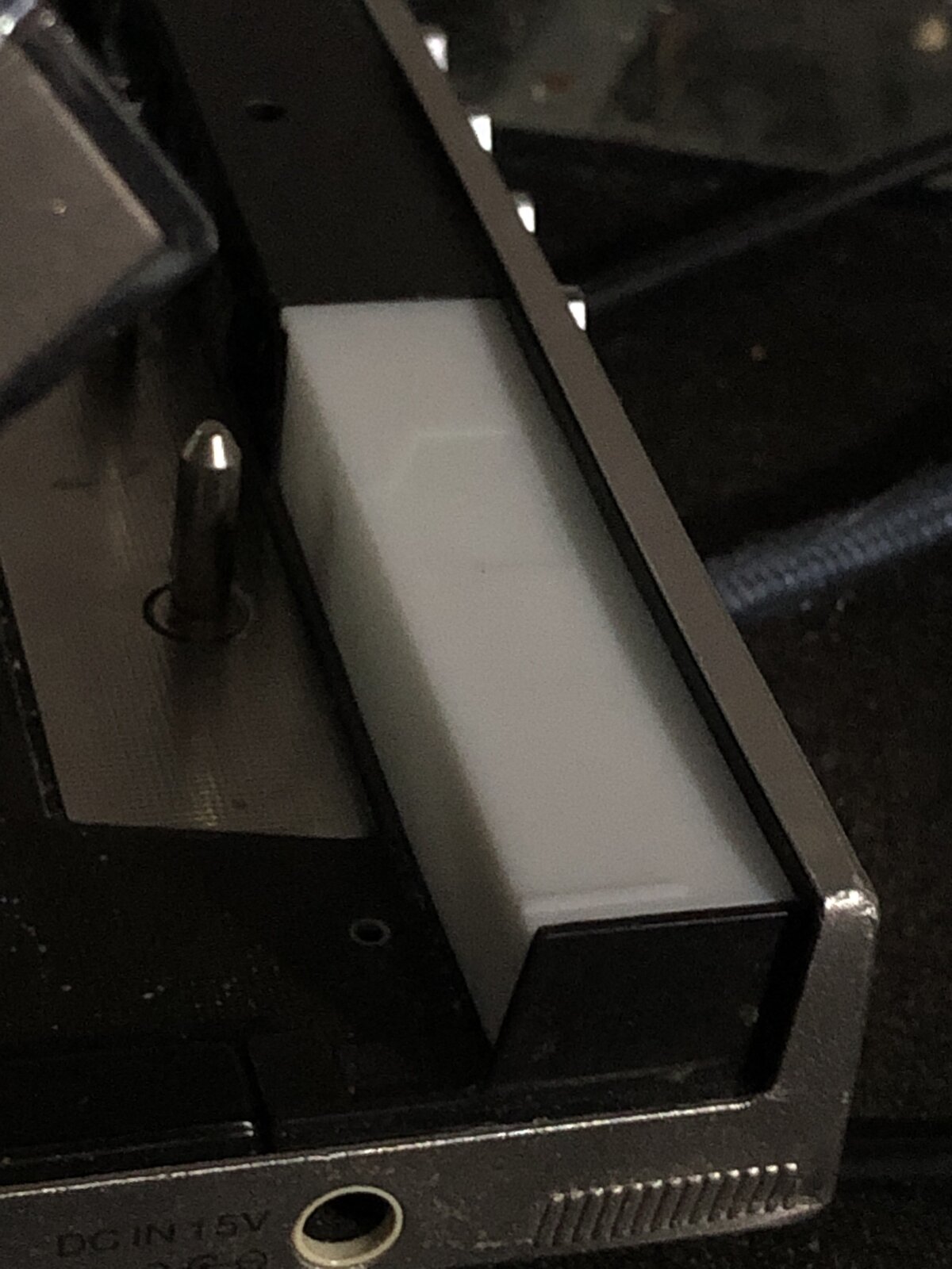

    so this is about what the final one will look like, its a very snug fit so i think im going to tone down the thickness ever so slightly, and correct the grip appearance, though otherwise i think this is about the final result here
    *also update took a bit since i had a failed print and this took 5 hours alone*
    Now im just going to see about painting it the original color, and how close i can get it using the several i have on hand to experiment with

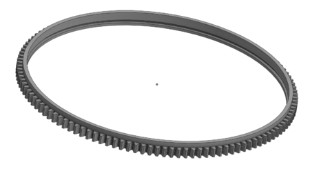

    oh crap sorry for the late-ish response, the only one ive finished last i worked on it was the wm-f10 cover, the gear is about in the same state as i left it in. i got super sidetracked wondering how id figure out the letter font of the f10 cover letters and transforming it into being a printable template. wound up shelving the project until i could figure that bit out. (getting sidetracked with trying to obtain an oscilliscope and better headphones now lately)
    gear is super unfinished as i couldnt quite figure out a way to properly gauge the curvature of the disc (its press fit on at the factory afaik), my last janky idea was to leave an empty space where the curved area was then allow it to be glued on like stated before in 2 pieces (glue fills the gaps, something like jb-weld)
    i can dm you the project link, though the gear is still largely unfinished on the underside, teeth count and dimensions otherwise though are as accurate as i could measure it
