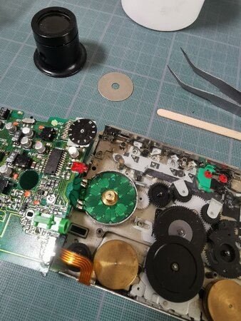

    hello Everyone,

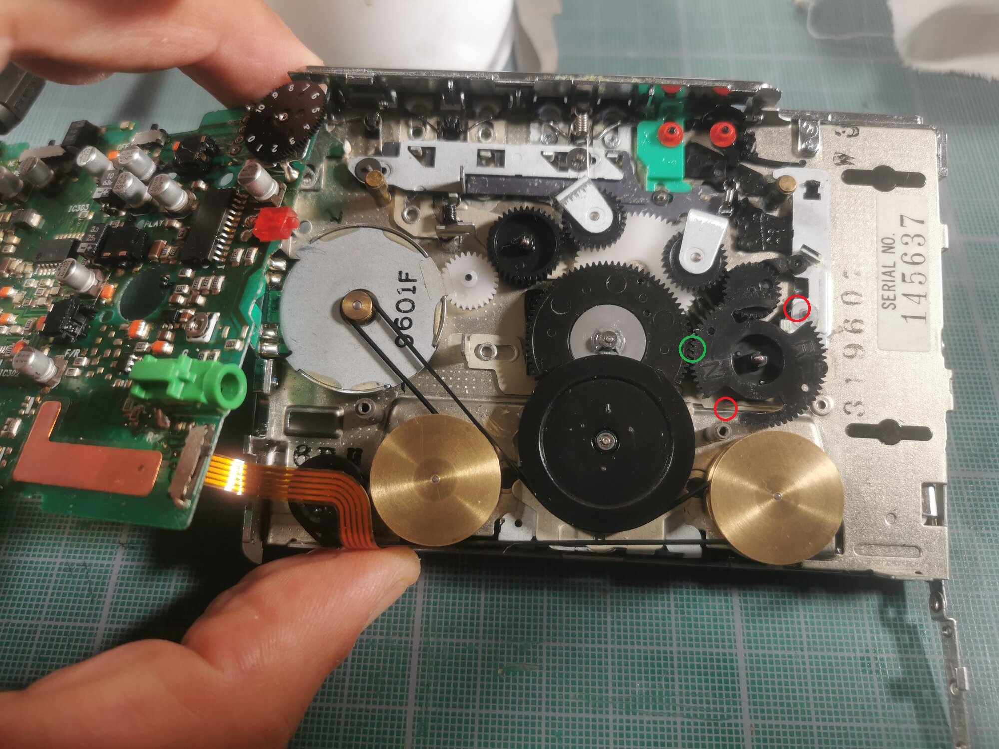

    so i have a problem: after changing the belt of my A602 (i really like its design) , it seems something went wrong with the player mécanism.
    >>§when play button was pressed, tape seemed to turn not in the same dir than the capstan... then. i moved one gear to try something and now it plays and stop after a second (like if reaching the end of tape) ...
    concerning FF and REW : stops after 1 sec...
    my intuition : gear or/and switches are not synchronized anymore.
    I probably moved something during cleaning and before installing the new belt... what.do you think?

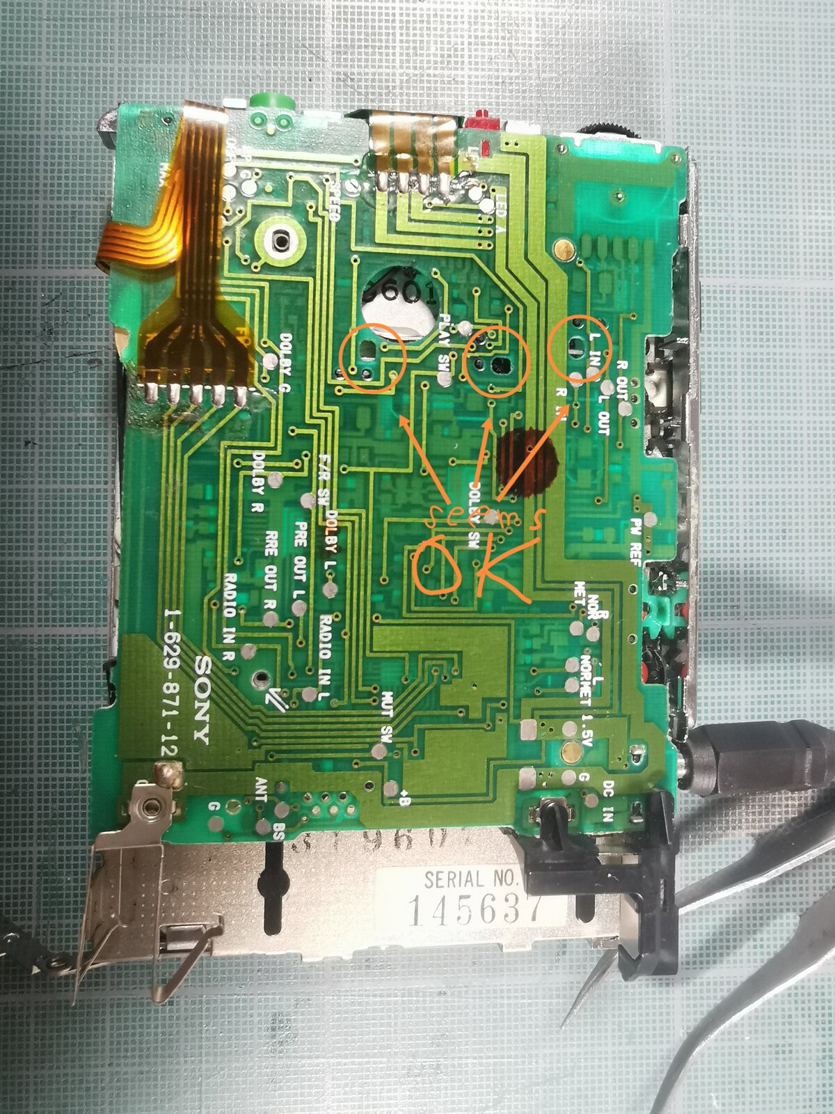

    i checked the 3 switches via the 3 holes on the PCB board and they are well located... (see picture)
    voilà... i prefer to stop now and ask on the stereo2go Forum some help before doing mystake.
    so thank you by advance
    b

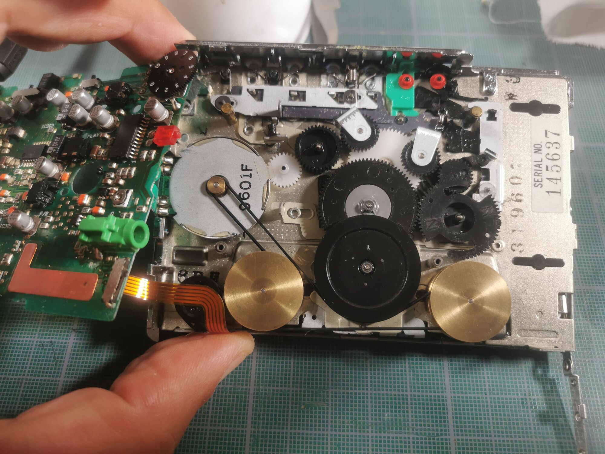

  4. Valentin
    1,531

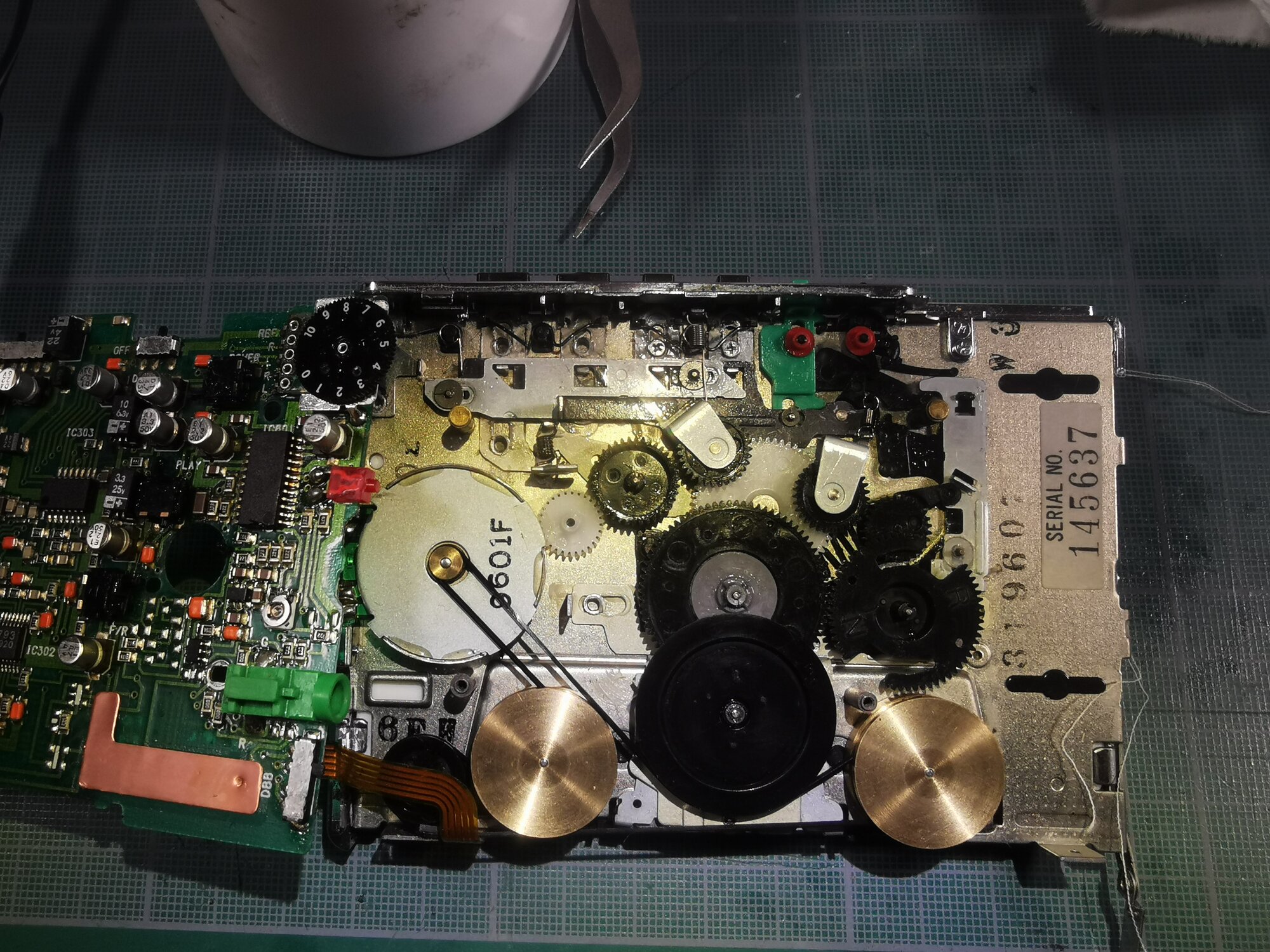

    A broken clutch gear can cause a jam in the mechanism. Your camgear seems to be half-way between FWD and REV, see picture attached.
    From my point of view, given the clutch is known to fail that should be replaced first.
    When I repair these mechanisms, I do the following before even powering up for the first time:
    - replace the clutch gear;
    - glue the tabel reel gears back to their shafts; you can see the white gear near the motor has a crack in yours. Chances are the other one has the same issue.
    - lubricate the capstan bearings and motor; this really depends on repair skills, if you're not confident skip this step;
    - install a new belt;
    - replace the capacitors if leaky;
    This way, when I power the unit on, I know all the common issues have been solved already. So if there are any additonal problems, I can already exclude some of the causes.
    As for the link, I recommend replacing the clutch with a new one, no point in repairing it. There are links in my common problems thread.

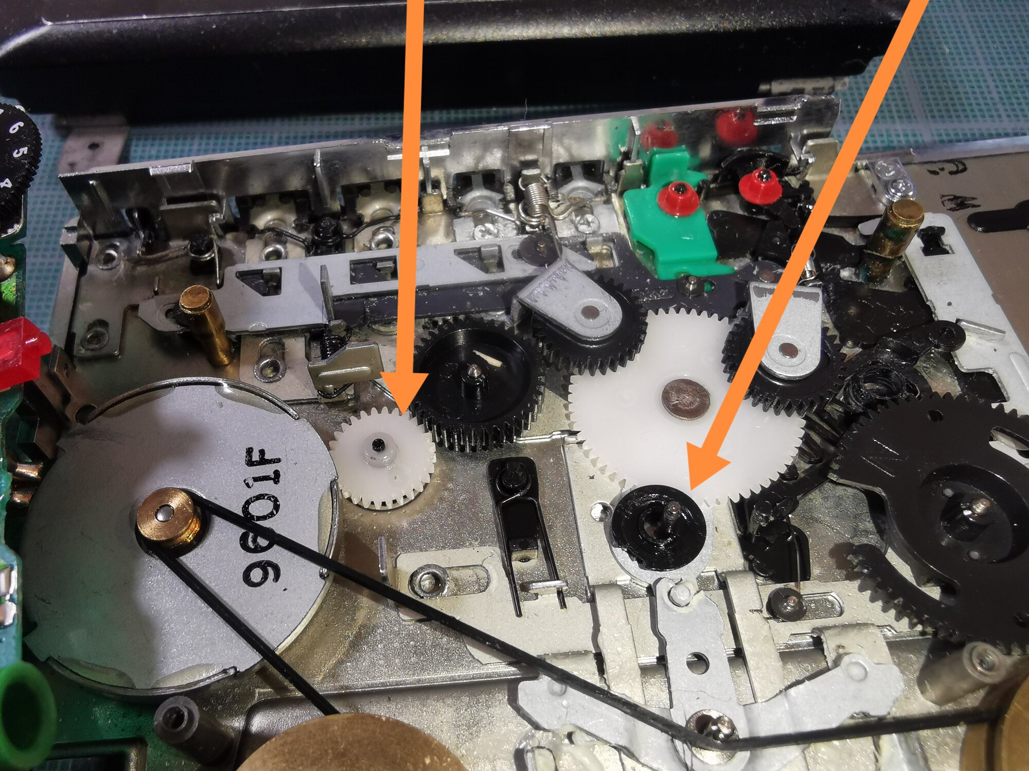

    both white gear and black gear/clutch were broken...
    i m lubrificating and checking... nothing else.
    I'll now try to order those parts, I'll browse now forum and your "common problem" thread to find new gear and clutch and replace them... if you know any link.

  6. Valentin
    1,531
    If you want a full kit containing all 3 gears, this has all (but it is more expensive): https://www.ebay.com/itm/314978961246
    There's also a kit containing 1 x clutch gear and 1 x reel gear, but you will need 2 such kits to get the 2 reel gears: https://www.ebay.com/itm/335392051559
    To be noted both reel gears tend to break, not just the visible one.
    However, these can be repaired (unless they're cracked all the way, which is not the case here) by adding a small drop of glue on top.
    In case you want to replace just the clutch gear and repair the reel gears, go for the FixYourAudio clutch gear: https://fixyouraudio.com/product/sony-wm-a602-clutch-gear/

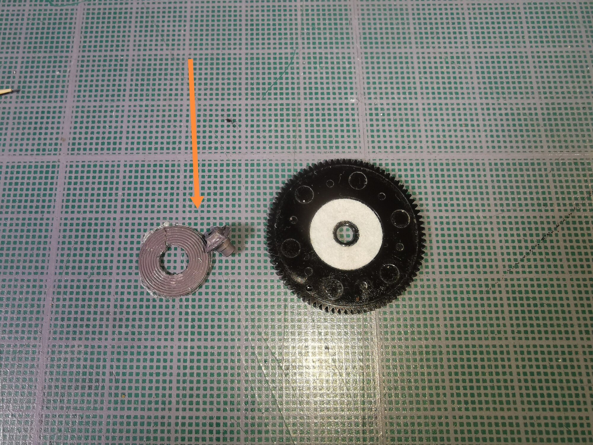

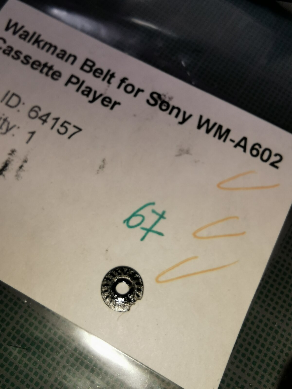

    - as you can see on the picture one of the grey disc holding a gear is broken - >is there a way to replace or repare it? (because of the quality of the material, it seems tricky to glue it)

  11. Valentin
    1,531
    Not sure if it's worth trying to repair that disc... Given there's quite a bit of force when clutch is slipping, chances are it will fail again.
    Would look for a donor unit, as it's good to have one for parts anyway. Look at post #17 here (any from the list will work as donor): https://stereo2go.com/forums/threads/list-of-walkman-portable-recorders-common-problems.7535/
