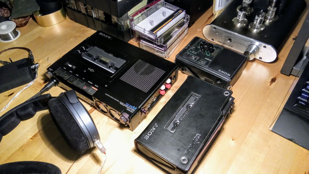

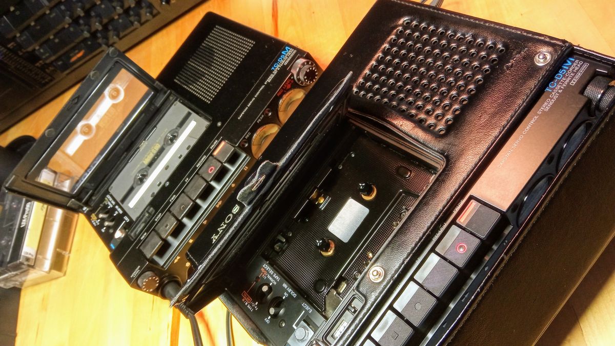

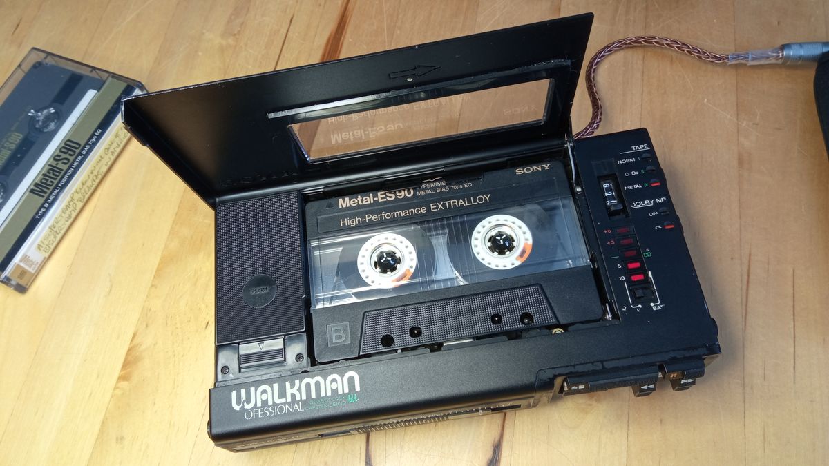

    I've had a most enjoyable weekend so far comparing playback ability between my newly-acquired D6 and my faithful old D3 and favourite TC-D5M.
    The D6 was a great find as even though it's not in the best cosmetic condition, technically and sonically it's tip-top.
    But I wanted to compare it to my (somewhat portable) TC-D5m and (eminently portable) D3 to see if there were any obvious audible improvements, caveats or downsides.
    The conclusion I came to is one I should have predicted to be honest; in that they all sound great in their own particular way. Not better or worse...just different.
    The D5M is just rock solid and never fails to impress in terms of ability every single time. If 'dependability' was an applicable byword for this device then it would feature in every single review. You can literally throw anything at it and it will sound great - almost like a Nakamichi Dragon.
    The D3 has similar characteristics albeit with a different sound signature, due I suspect to its amorphous head. If the D cell batteries of the TC-D5M were busy charging then the D3 would be the next Walkman I would turn to.
    Enter my recently purchased D6. What a lovely surprise it's been to discover its sonic capabilities. I have a beautiful 'refreshed by Deb64' D6C which sounds amazing but this goes a step further. The sound is more mature, more resolving and more engaging, due I suspect again to that amorphous pointy head. Deb64 was the instigator of the D6 itch I've been trying to scratch for the past 2-3 years ever since she imparted her preference for this particular model. After listening back to some recordings of the first 2 Nick Drake albums recorded to Type II and IV cassettes I now concur absolutely with her opinion.
    When a device can capture my attention for 6 hours straight then there must be something special going on.
    I used a range of headphones and amplification during the listening session and settled on my Fiio E12 and Sennheiser HD-565's with one of my own UPSPOCC headphone cables as the preferred ideal combination.
    Happy days.

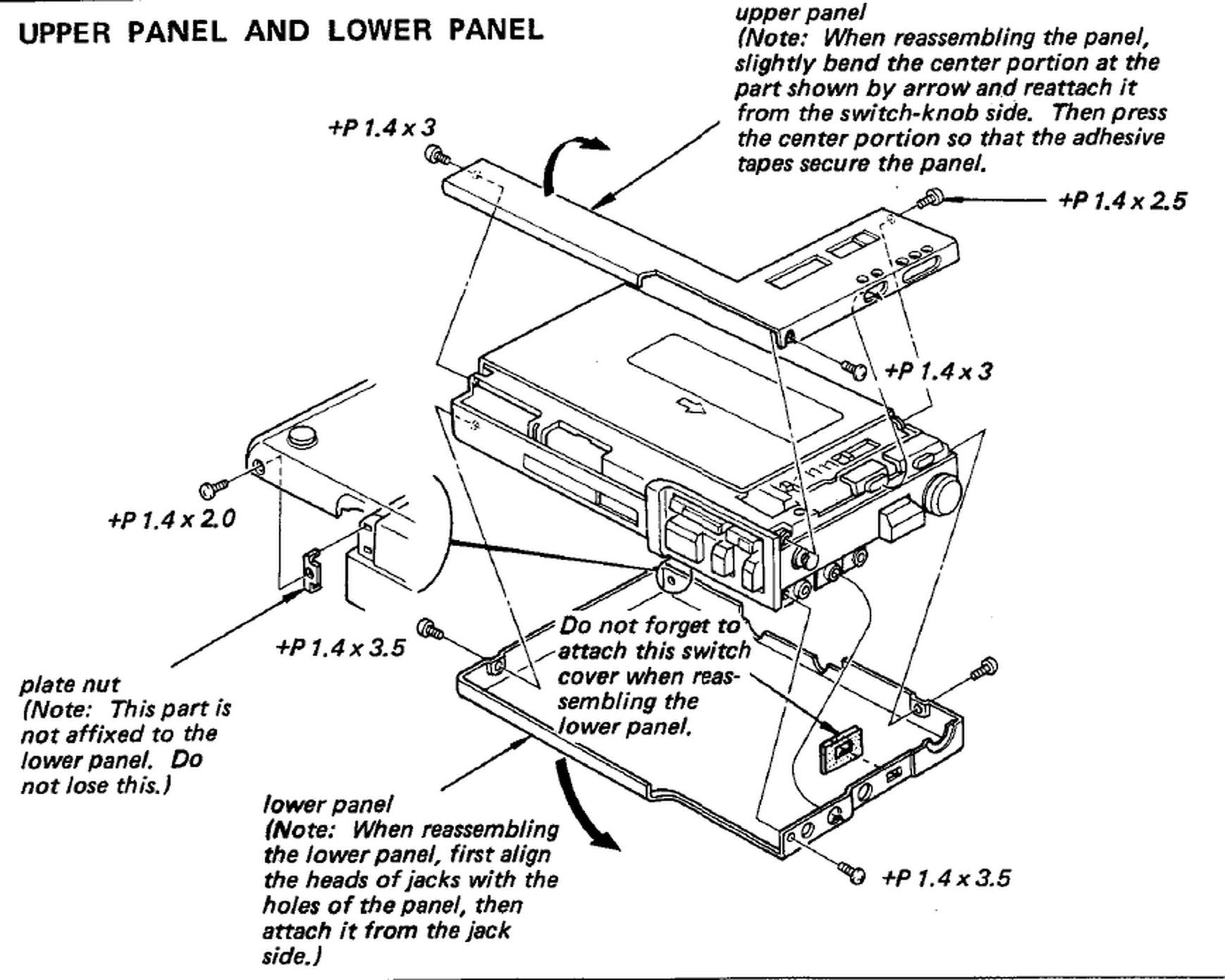

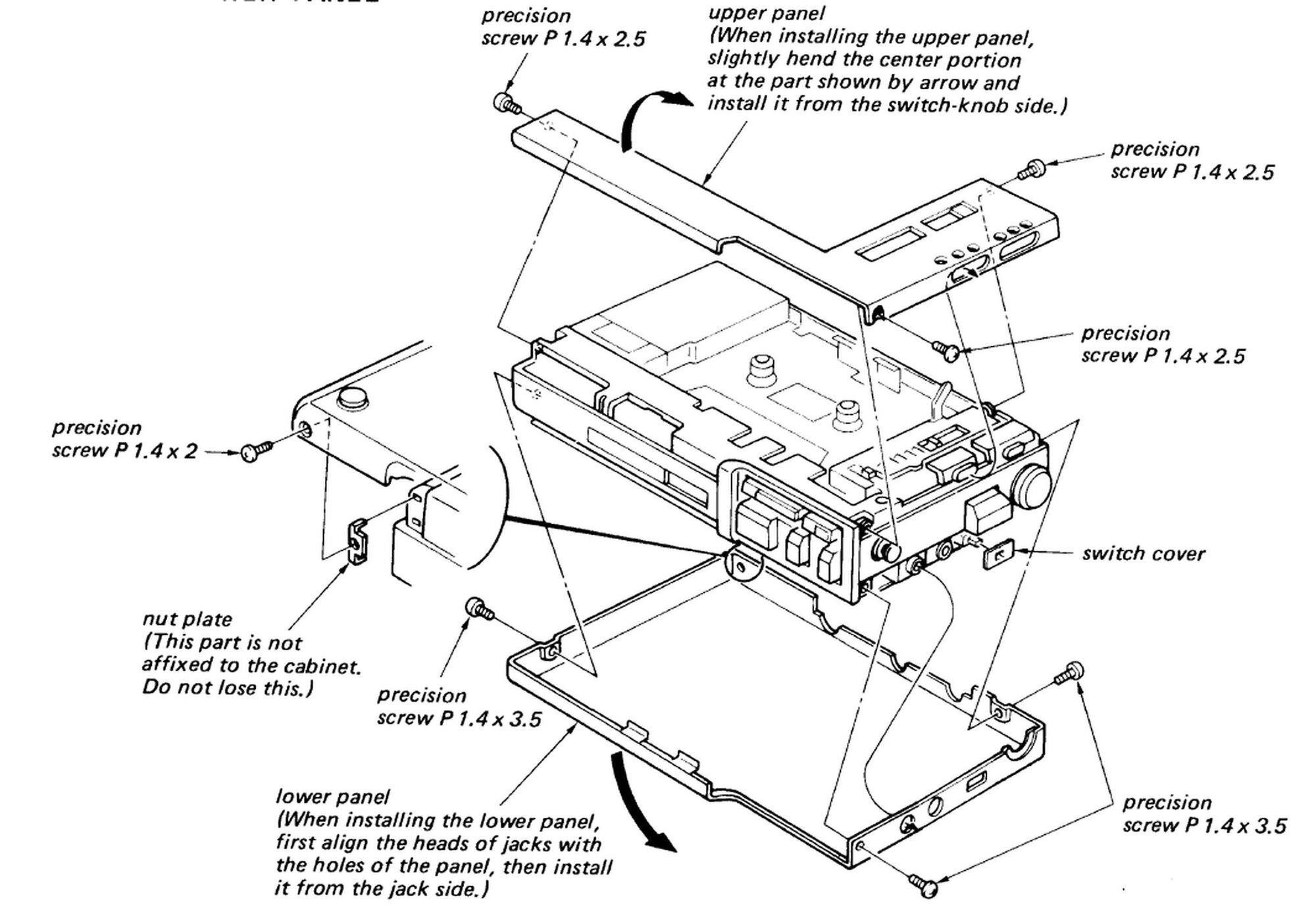

    Does anyone have or know where I can get hold of a +P1.4 x 3.5 screw for the bottom cover of my D6.
    Sadly it came with this screw missing and it's wreaking havoc with my OCD :ohno2:
    I pulled apart some old broken cameras to see if I could retrieve one from them but no cigar.
    I spotted Marions Mihokm's bag of spare Walkman screws on his fixyouraudio store but it doesn't list the screw sizes specifically, only the lengths, so I'm not going to order this on the off chance one might fit. Marion if you read this it would be handy to have a list of specific screw sizes including thread and P classification in your ad ;)
    I also spotted a set of spare screws for a D6 from a seller in the US who is asking a wholly reasonable $5, but with a quite unreasonable $114 for postage. grrr
    I noted in the service manual for the D6 that the nomenclature for the screw is '+P1.4 x 3.5' yet for the D6C it becomes 'P1.4 x 3.5' without the '+' prefix.
    Any significance/difference?

  4. Valentin
    1,644

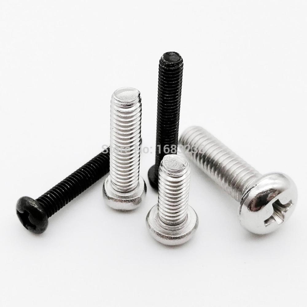

    The ones from Marian do contain a screw that will fit (with pan head). Alternatively you can order here a set of M1.4 x 3 or M1.4 x 4 (I think both will work): https://www.ebay.com/itm/183101617934
    And I think your autocorrect has "corrected" wrongly. The guy's name is Marian, not Marion. Seen this happening in many instances even with my name, but most people don't notice it.
  5. Chris_D
    Chris_D Active Member
    145
    Netherlands
    Thanks Valentin.
    Sorry but can you confirm absolutely that these screws correllate exactly to the thread pitch of the original Sony screws?
    Sony uses a 'P' prefix where the ones in your ebay link are standard 'M' prefix. The difference in nomenclature usually indicates a different thread pitch or depth or material in my experience - I come from a Nuclear engineering background, where everything is design-checked-approved 7 times!
    I will also message Marian and thanks for his name spelling correction.
  6. Deb64
    256
    Leicestershire, England
    I'm pleased to hear that you're enjoying the D6.
    There are a few sellers on Ebay who can supply the M1.4 screws for the casing. A 4mm length screw will be fine.

  7. Valentin
    1,644
    Yes, I confirm the thread pitch is the same on the ones from fixyouraudio. The "P" used in the service manual most likely indicates it uses a pan head and not a countersunk head.
    As for the ones on ebay, I did use them (on DDs, which have the same thread pitch) and I believe there is only one thread pitch available on these type of screws anyway.
    EDIT: To be even more clear, on DDs I used the M1.2 as the M1.4 head will not be flush with the case. Both have the same thread pitch, the M1.2 fits a little bit loose but works just fine in the end (on DDs).
    On D6C the screw heads are the larger type, those that correspond with M1.4. I mention the DD ones, cause I never seen ones with small head but M1.4 thread diameter (which is what is originally fitted on DDs).
    Of course at the end of the day, it is up to you to choose, but I don't think it's worth spending $114 on shipping for what I consider to be the same screw (or same functionality at least).

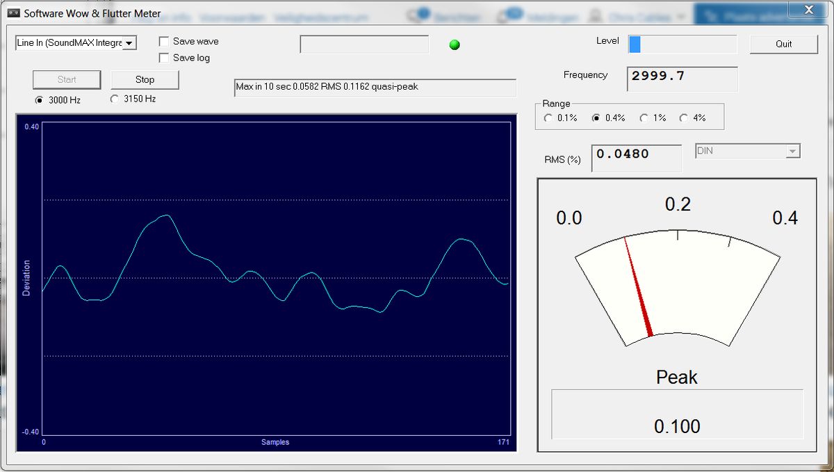

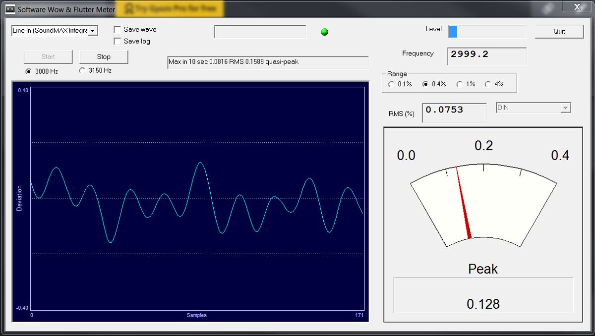

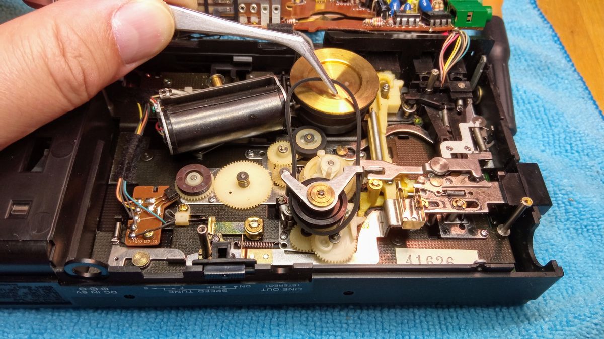

    Swapped a new capstan belt into the D6 this evening. The original one was okay but it looked past its prime.
    A fairly straight-forward procedure after watching a few Youface vids and reading the manual.
    Webspareparts.com supplied the belt which is proving to be a very fine example indeed as the W&F has dropped from an already not too shabby 0.07%RMS to a very respectable 0.05%RMS!
    The D6 just got a little bit better.
    :thumbsup2:
    Pre belt change
    Post belt change

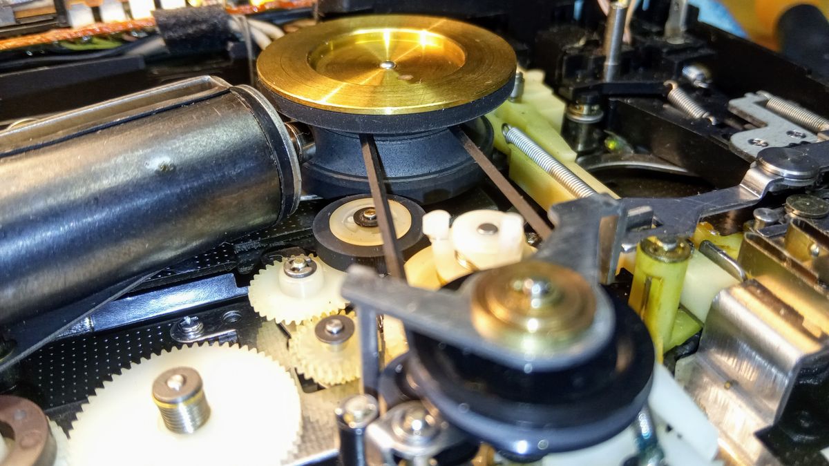

    I have an impression that you may have changed the motor position and that is what has changed the W&F, not the belt. That belt is not driving the capstan, but the takeup reel assy.
    The holes of the motor screws are larger than the screw threads (both on D6 and D6C), specifically for ajusting the position. This position does have a pretty significant impact on W&F.
    As a recommendation, all the rubber parts should be replaced, not just that belt. There is the capstan ring that will get the unit to run noisy when rubber gets hard and the 2 idler tires: small one can cause low takeup torque, while large one influences the FF/REW torque.

    Ah! Of course it's not a capstan belt - the capstan is driven by the motor wheel on these things of course! drrp
    I do notice that it's become a little less noisy than it was before although there is still a perceptible external-sounding 'oscillation' on playback.
