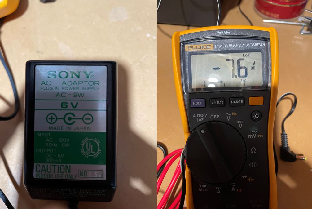

    DON'T USE A PLUG IN POWER SUPPLY on a WM-D6C!
    Recently one of my customers managed to destroy a CX20084 ic on his D6C while running it on batteries.
    Also, he had 3 Sony supplies, all rated at 6V and with the correct polarity, which he tested with a Fluke meter. They delivered from 6.5 Volts (the lowest) to 7.6V (the highest).
    Shortly after that, I had a repair enquiry from another customer with a faulty CX20084, which he insists has only ever been run on batteries.
    I tested a fresh set of alkaline batteries (Procell) and a set of 4 were delivering 6.3V.
    Although I have never seen a datasheet for the CX20084 (and I'm not likely to see one either), I think Sony were running these chips at the extreme upper limit of their supply voltage at 6V. Anything over 6V is taking a risk.
    The CX20084 is connected directly to the incoming power supply, which is not switched. Therefore, if you plug in supply with the wrong voltage or incorrect polarity, you will destroy the CX20084 instantly, even if you don't switch the walkman on in any way.
    Add to this the fact that replacement CX20084s are now becoming extremely difficult to obtain, I recommend that you only run your D6Cs using rechargeable AA batteries (such as Eneloop Pro). These deliver a lower voltage than alkaline batteries (normally 1.25V each) so a set of 4 will deliver 5 volts, which will run your D6C very well.

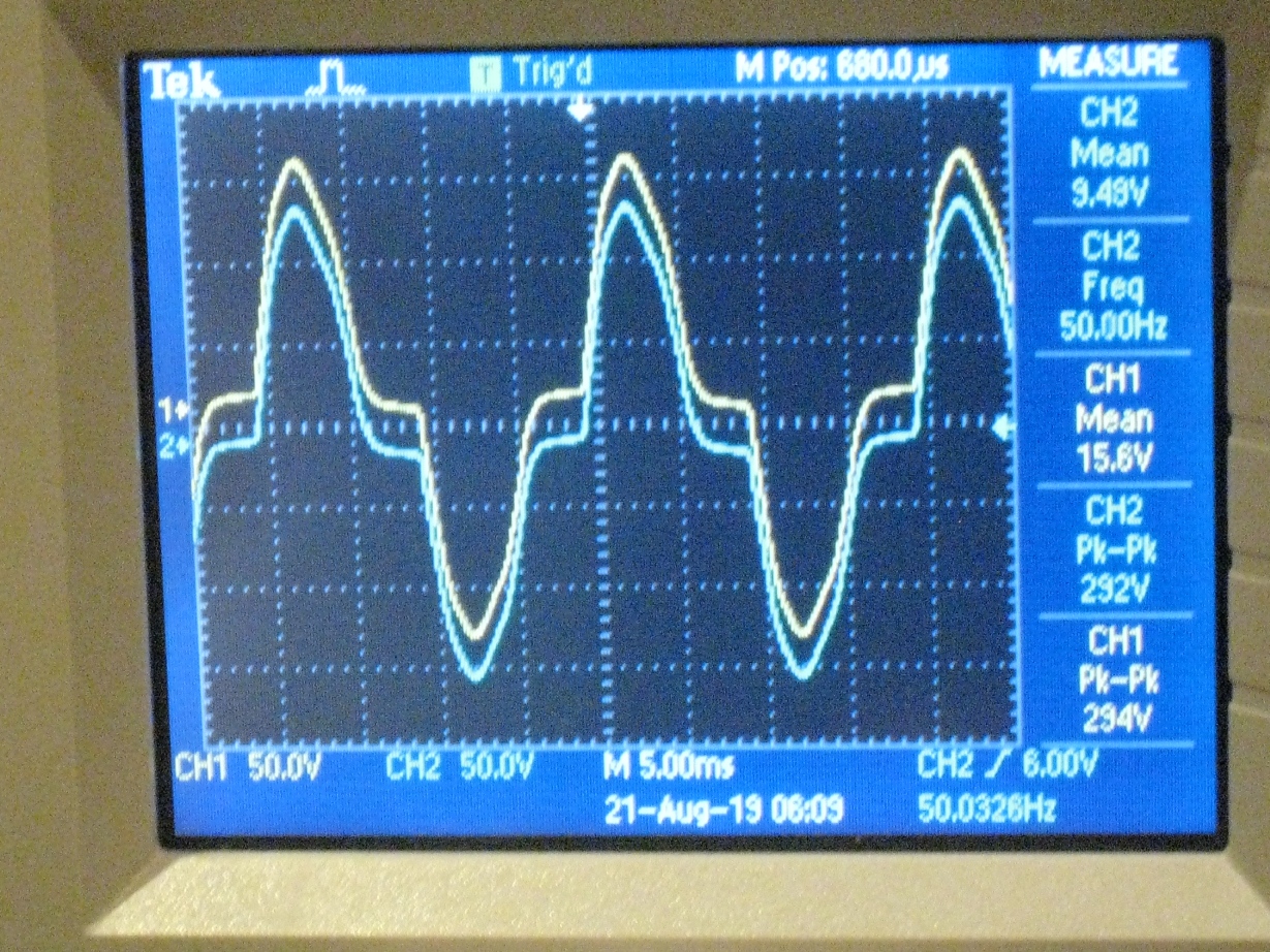

    The problem with using a 5V wall supply is that most of those sold these days are switch mode type supplies. These usually have AC coupling from the primary to the secondary side in the form a Class Y capacitor, which is put in the circuit to supress RF interference.
    This results in a common mode AC signal on the output which is high voltage but low current. In the UK, where we have 230V AC mains, the peak to peak voltage of this common mode signal can reach nearly 300V relative to mains earth.
    So far, I have repaired 2 D6Cs where the CX20084 was destroyed by the use of a switch mode power supply.
    I have attached a photo showing the oscilloscope traces of the two sides of the connector. When measured with a multimeter, they showed a nice steady 6V DC but it is the common mode signal which will destroy the chip.
    Valentin, spatterlight and Jorge like this.

    I mentioned earlier in this thread that a customer had tested some genuine Sony 6V supplies and found them all to be over 6V. The 300mA supply, which he states is recommended for use with the WM-D6C, gives an output of 7.6V, which is far to high to use on a CX20084.

    Thanks for all the good information, Deb64 ! I always used my D6C with NiMH cells exactly because of the fear of destroying the CX20084 chip.
    The original power supplies like AC-9W are all unregulated, so they will give a higher voltage with no load. The voltage will drop when loaded, but the initial spike is likely enough to kill the chip. Maybe not the first time, but in time it will.
    I have checked many 6V power supplies from different brands and most of them are unregulated. The only exception was the SONY TCD-D8 power supply, but given it has 100-240V input rating, it is a switching supply for sure.
    So it is also my recommendation to use this unit on recharghable batteries only.
