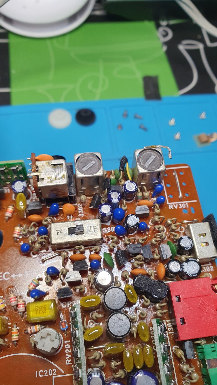

    Hi everyone,
    I have serviced my D6C and it's sounding fantastic - what a great unit! I have now been trying to record some tapes and noticed that I have some static/crackling noise in the background (on the left channel mostly).
    I will try to clean the PB/REC switch as suggested by Valentin - would anybody have any other idea of possible root cause(s)?
    I've attached a recording I've just made with record level set to 0 and nothing connected on line input, to show the problem.
    Thanks!

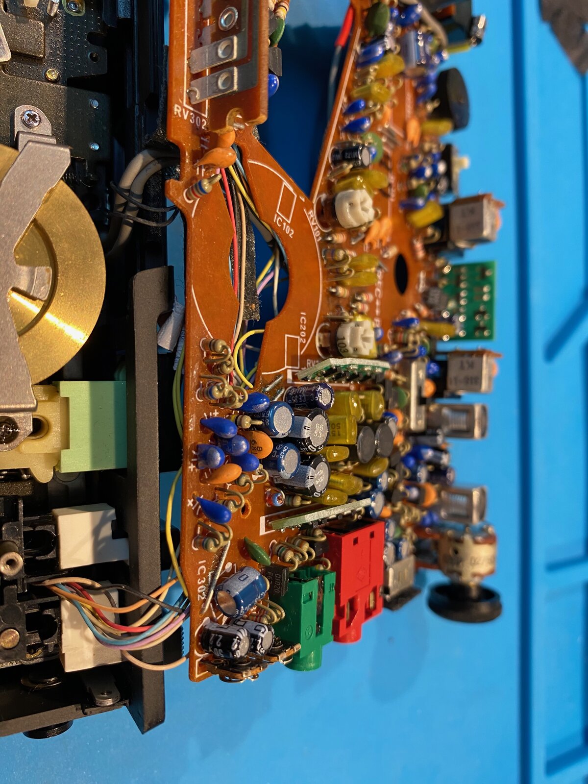

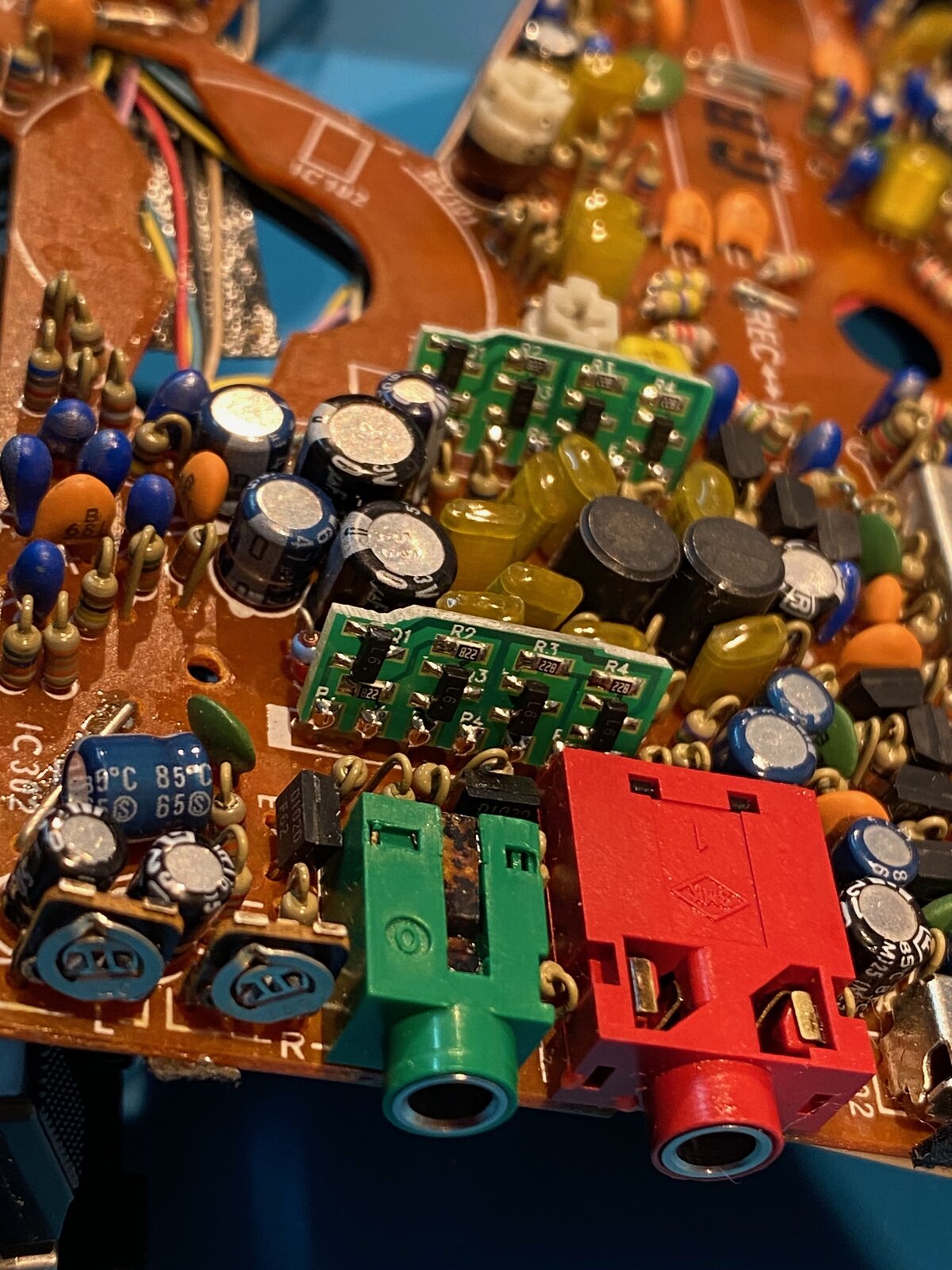

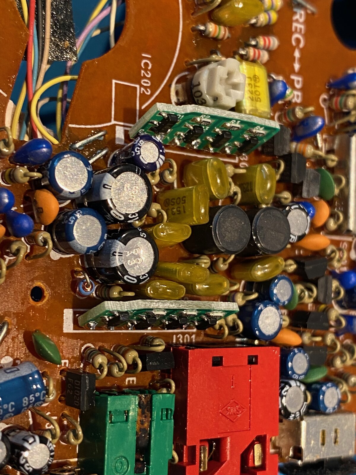

    I tried to clean the cassette type and Dolby selection switches - didn't help.
    I've changed both EQ switching modules with the ones sold by Deb and bingo - that was it! Unit now records perfectly and sounds amazing :D

    I'm pleased to hear that replacing the EQ modules has solved the problem. This was an unusual fault. Normally when EQ modules fail, they cause intermittent loss of high frequency on recording. I have never come across EQ modules causing static noises on recordings before.

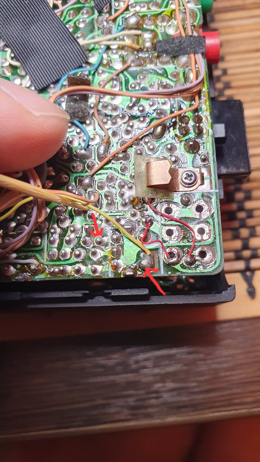

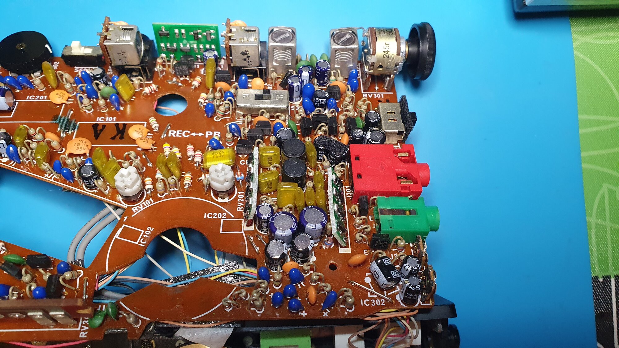

    Hi @Deb64 I recently replaced the EQ modules too and there was an printed photo in the parcel how to solder it, and CP303 in a different position than @dom69 . It's doesn't matter or I should resoldered it?
    I have issue in the record mode with left channel it works but is very very quiet both in line in or mic in, through headphones or line out. In playback everything ok with both channels.
    Tried to clean play/rec switch with contact cleaner without desolder it but nothing changed.

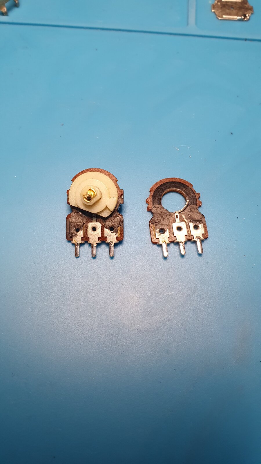

    Desoldered rec pot because it was broken and bridged at max rec level without rec pot but nothing changed. I also tried with fixed pot (glued it and restored contact with
    graphite varnish) nothing changed.
    Don't know what else I can check.
    Could play/rec switch be the cause of the very very low level in left channel? Should I desolder it anyway to check or may be it can be checked with multimeter without desoldering? Check with multimeter seems worked.
    I will be appreciated for any help)

    Electrically, the EQ switching boards can be fitted either way round; they are symmetrical. The problem is that I cannot make them as small as the Sony originals and the edge connectors, which I use, make the boards stand higher from the PCB. The fitting methods for D6 and D6C which I have shown in the leaflet are the best way of fitting which I have found to avoid the EQ boards touching other parts of the mechanism.
    @dom69 yours should be fine if it doesn't touch any other parts of the mechanism when the main board is fitted in place.

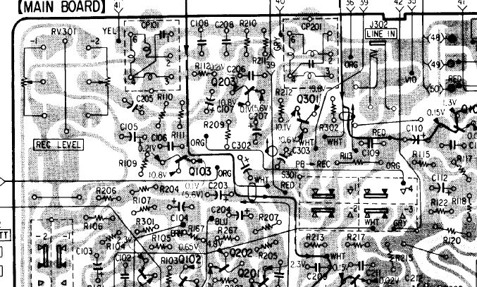

    @-LV- It is possible that you may have a broken wire inside CP101, which is the MPX filter on the left channel. If you have an oscilloscope, you can try tracing the input signal through CP101 to see if it can be see on pin 6 of CP101 (the output). Another way to check is to try swapping CP101 and CP201 over and see if the fault remains with the left channel or moves to the right channel. If you do de-solder and re-solder them be very careful as the wires on the internal windings are very delicate.
    The record level pot is vulnerable to damage if the walkman has been dropped, as yours appears to have been. In the D6C, sony braced the Rec level pot to the CP101 can to try and protect the wafers from damage if the rec level pot is hit. Unfortunately in a severe impact, the shock is transmitted through the bracing wire to CP101, which can result in a broken wire in CP101.

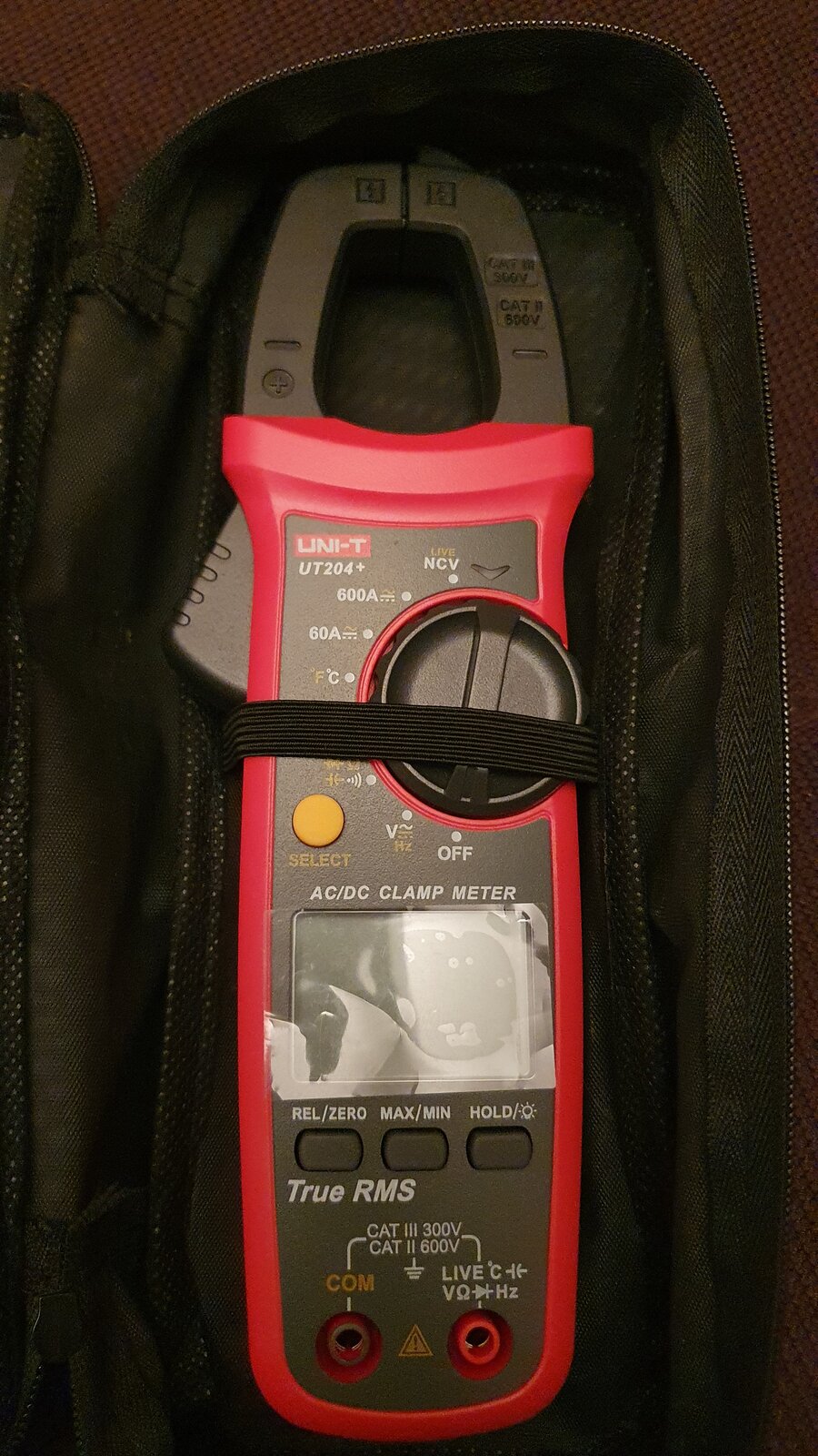

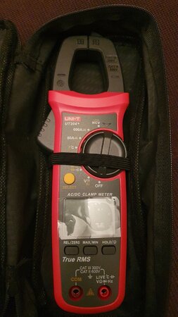

    @Deb64 thank you, can I use multimeter with true RMS instead oscilloscope? I don't have oscilloscope unfortunately :(

    @-LV- with my limited experience I would say yes, you can use True RMS multimeter to trace the signal - although I am not an expert in electronics. I have been doing so on other units I am working on, having no oscilloscope myself neither.

    I have never tried it as I normally use an oscilloscope. You can try with the meter and try checking the right hand channel to see if there are any obvious differences.

    I will try tomorow check CP101 and CP201 output pin. As I understand I need measure voltage between ground and 6 pin on CP 101 and CP201? Their inputs is on pin 3?

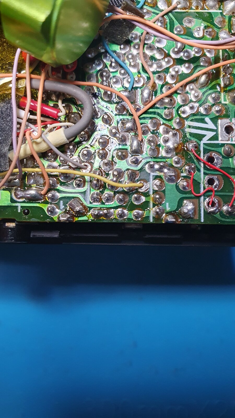

    I checked CP101 and @Deb64 I think you were right. I run 1kHz from my phone to line in and what I get:
    On line in contact R L
    87mV 87mV
    On CP201 3 pin 6pin
    51mV 47mV
    On CP101 3 pin 6pin
    80mV 1mV
    I checked scheme and I think I can bypass CP101 for test. If I desolder one side of R112 and yellow wire and connect them directly. I'm right?
  19. -LV-
    -LV- New Member
    15
    EU
    I bypassed CP101 and left channel works fine :) Than I decided bypass and CP201 too. As I understand MPX filter for records from FM radio and it shouldn't affect record from other sources?
