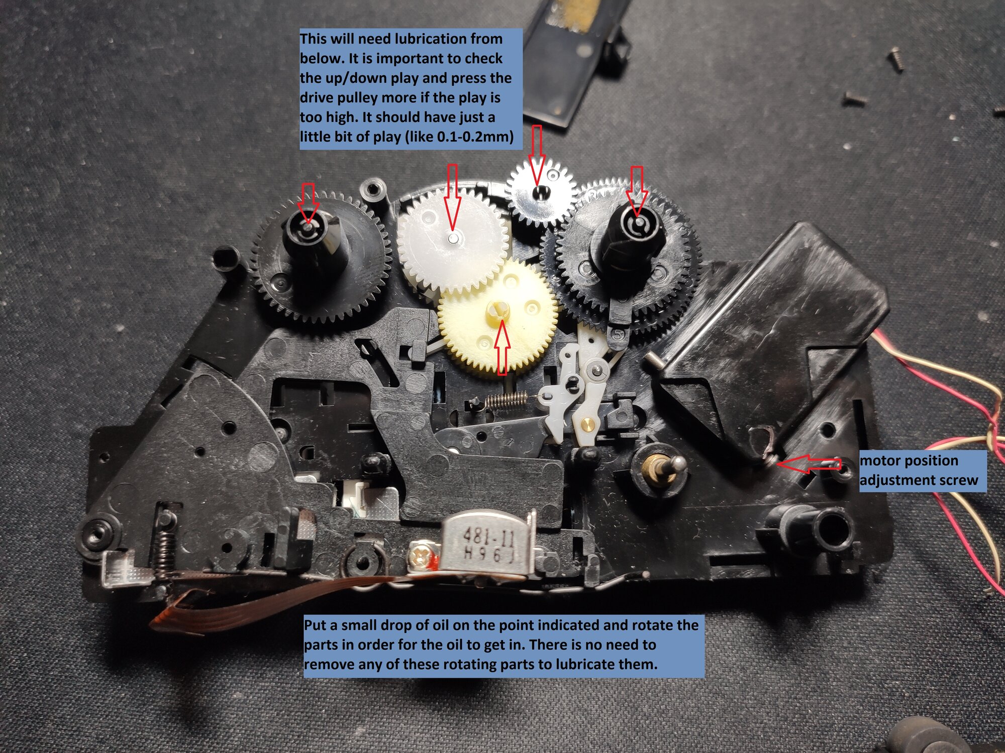

    4. Flywheel thrust play
    This should be checked to be within 0.1mm. If not, re-adjust it.
    5. Motor position will need adjustment
    There is a left-right adjustment of the motor which needs to be adjusted so motor spindle is perfectly perpedincular to the flywheel. This adjustment has a significant impact on wow&flutter.
    It also needs to be done after the flywheel thrust play has been adjusted, as it's influenced by that adjustment.
    6. Re-lubrication of mechanism is recommended
    There are some key points shown in one of the pictures below. Besides that, the motor and capstan bearing should also be lubricated.
