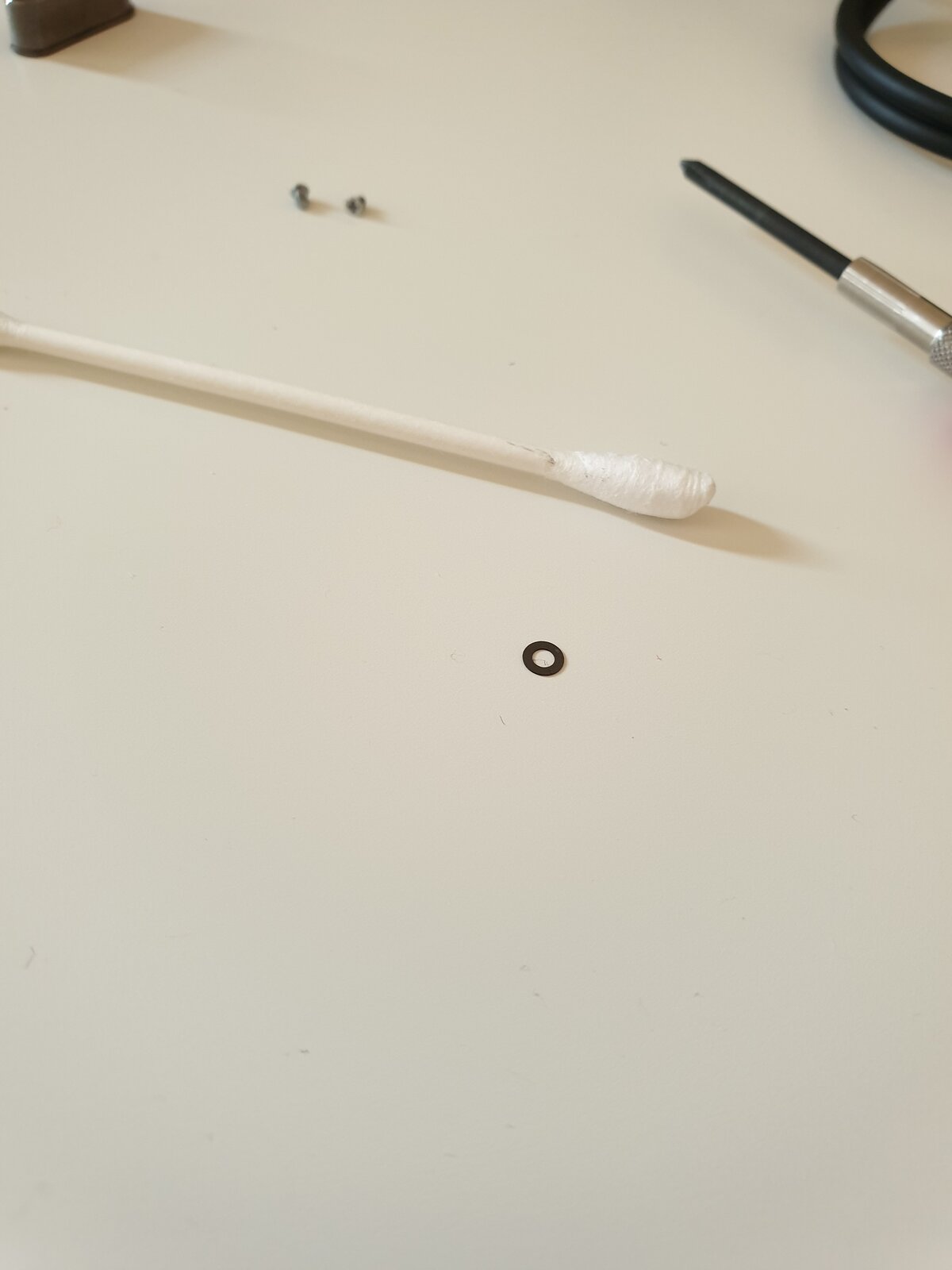

    For initial testing I didn't have the lever installed, lest I need to take it all apart again.
    I bent the rewind pusher area even more, as well as removing a black washer under the clip holding the rewind gear. Rewind now works, though it quacks and occasionally slips when upside down. I also bent the fast forward lever more, but still not enough contact.
