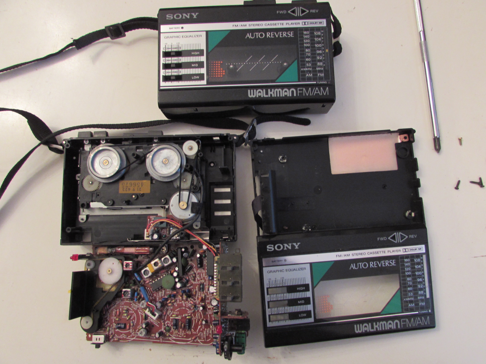

    IMG_7983.JPG I have two WM-F28 Walkmen as they sound so good (BETTER than my DC2, with correct azimuth, the DC2 simply sounds dull) but both of these WM-F28 developed their own problems.
    On one Walkman, the FF wouldn't work due to some friction somewhere in the mechanism. The motor was nearly stalled already without a cassette in it. This turned out to be hardened grease in the bearing of one of the gears. I removed it, cleaned it and voila, works. Now that it was open I removed the flywheels, cleaned capstans and bearings, put a LITTLE(!) oil on the capstans and reinstalled them.
    The other one developed a nasty habit of giving a very harsh and loud sound if pressed at a certain place at the back. Indeed, a small crack in the PCB. Installed a small bypass-wire and voila, it works fine.
    Remarkably, these 1986 Walkmen did never require a new belt or new electrolytic caps. They still sound wonderful after all these years. I bought a lot of other, more modern and small Walkmen later, but they all didn't satisfy like this large brick the WM-F28 in fact is. Especially all those 1.2V powered ones just don't have the power to drive a decent pair of headphones. The WM-F28 drives them with ease.
