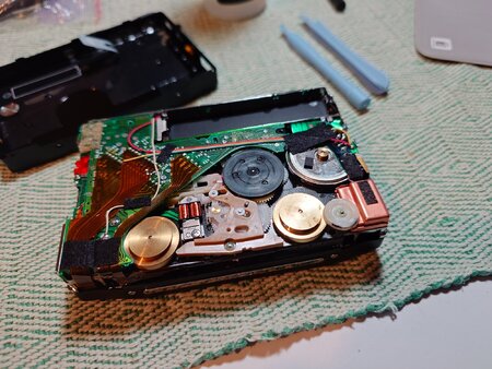

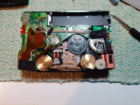

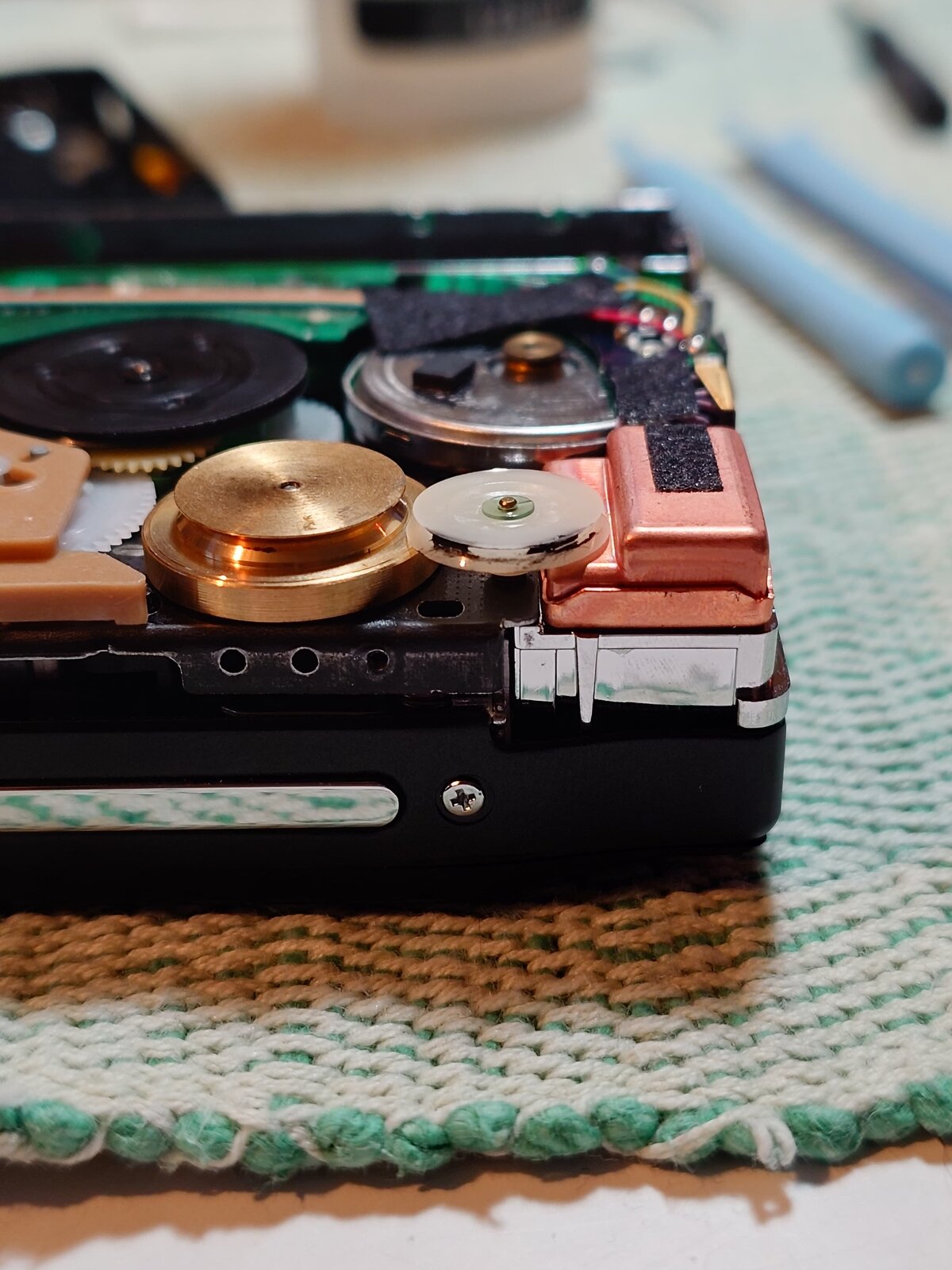

    So I finally got around to fixing this one after spending the long weekend with family. It was a piece of cake.
    Took the top off and sure enough the belt had snapped. The bottom flywheel had 'absorbed' a bit of the rubber and gotten stuck, so I assume that's where it failed.
    Took my sweet time cleaning out all of the rubber 'goo' without damaging the tiny plastic flywheel. You can see it's sort of "stained" the flywheel. I did my best to get it all out with the tools I have but it'll probably never look completely clean again. Was hesitant to use any kind of strong alcohol etc. in case the residue gets stuck on the flywheel and ends up just speeding the decay of the new one.

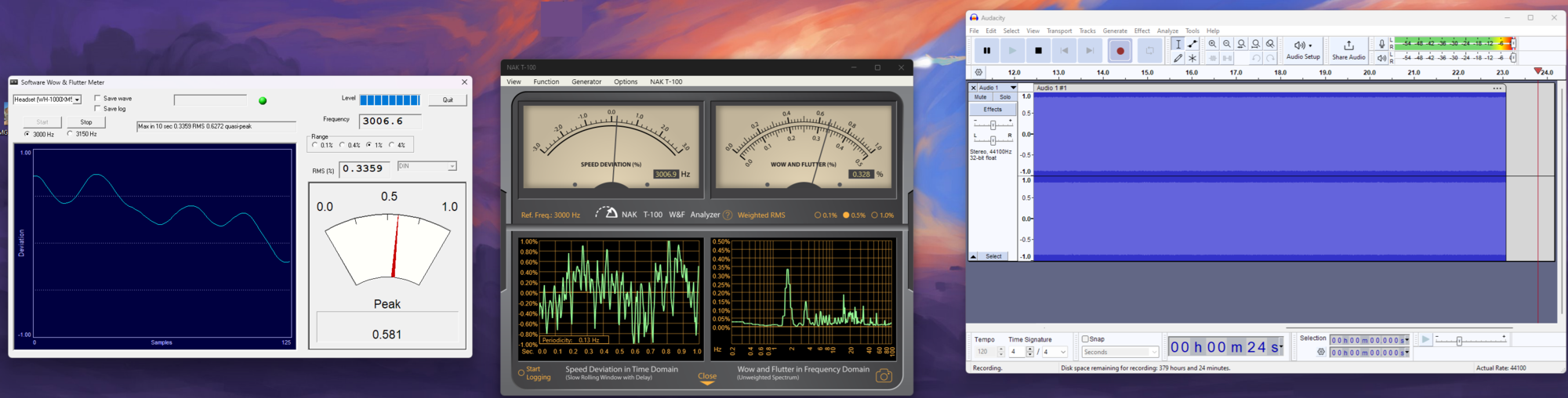

    I'm pretty satisfied with Marian's belt. Not sure if this is a good or bad result for the belt I got from him. I made extra sure that the belt wasn't twisted anywhere when carefully installing it.
    The W&F seems a bit high (bit over double my DD models) but this could be due to a few different things.
    I bought the device BNIB and it has never been used.
    Capstans are spotless, pinch rollers look immaculate and the overall condition of the device looks straight out of the factory. I also carefully checked the grease for the gears and the mechanism and it seems to be working as new. If there's something not working properly, its outside of my knowledge.
    Volume pot got a tiny drop of audio cleaner to roll it in as it had the tiniest bit of scratching.
    That said, the speed of this thing is about as perfect as it gets for a non-DD model.
    The seller of my tape told me I should consider 3002Hz as the mid point as his Nakamitchi ZX-7 had drifted slightly. Which would put this device only ~4.5Hz off 3000Hz.
    If anyone has any ideas of how I could drastically lower the W&F, I'd appreciate it. Though I'm not expecting any miracles for this model.

  6. Valentin
    1,527
    The W&F result is good in my opinion, especially considering there was nothing done apart from swapping the belt.

    And possibly clean the pulleys a bit more, on last picture of post #4 it looks like there is some leftover residue on the white idler pulley. IPA can be used safely on these pulleys.

    Yes there's a tiny bit of residue left on the white pulley. I did everything I could to get the rubber off but I'll give it a go with IPA as well. At least at this point it seems like the leftover rubber from the old belt was more of a "stain" than anything I could see actually impacting the the transfer of the belt.

  8. Valentin
    1,527
    For most music genres out there, indeed you won't notice the difference between 0.2% and 0.3% WRMS, the value at which it becomes really noticeable is a bit higher than this.
    Exception to this is classical music or any music with long note decays, that's where the w&f will become very audible and even 0.2% will seem very high.
