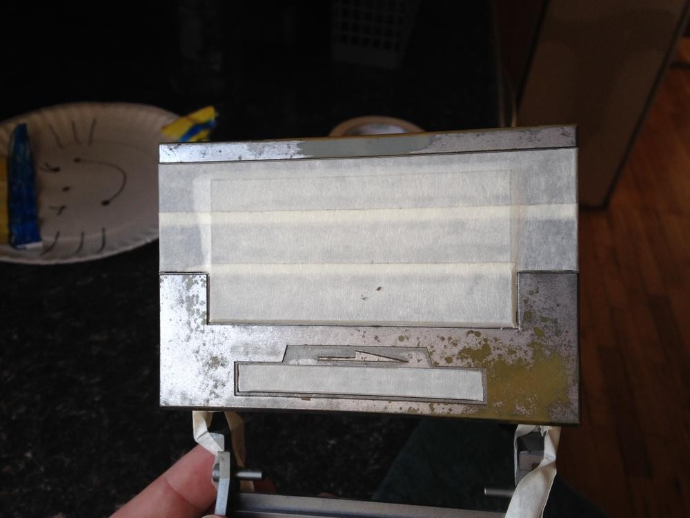

Yes that is the color I use for repainting. It has a little more metallic in than the original M90 finish so if you use it for touchup on scratches, it might show. Overall, the best color match I have seen.
I painted the cassette door on the M90 shown below.
IMG_2271IMG_2277IMG_2284IMG_2286

btw one can remove the plexi glass on the m90, no need to take the hole door off bro
