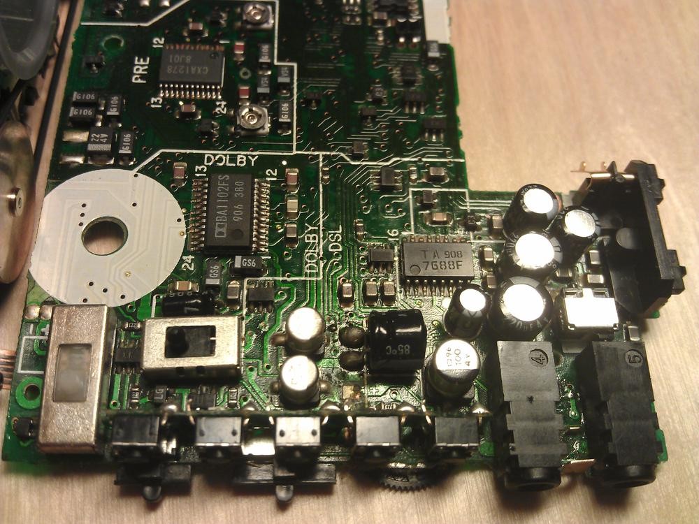

When I removed the screw from the back of the metal case I noticed some crusty deposits on the back of the screw head. Removing the rest of the screws to open the back cover reveals the usual crusty gooey mess I've come to expect from AIWAs of this vintage.

The capacitors were tested and interestingly only a few had not survived the aging process. Not surprisingly the three surface mount capacitors were dead. I have yet to ever find any surface mount capacitors on an AIWA circuit board in working condition. Of the three 220uF 4V through hole capacitors present, the horizontally mounted one was actually in very good condition. All the larger through hole and surface mount capacitors were removed and retested again. Only the 47uF and the 220uF 2V through hole capacitors are kept to be reused.

Hey hey ! I'm happy to see your job ! although not yet read all your post , there's something funny here , check my JX303 thread , so you did mount the 47uf 4v the opposite than they were originally !? And you didn't noticed the reverse polarity again for one of them like the pcb suggests it ? That's troubling me... Isn't there any polarity here ???
plop - 2012-01-07 11:31
It does not surprise me that there is such an error on the screen printing. There are errors on the JL30/303 screen print as well. I make notes of the capacitor orientation along with their values before I remove them, since when I clean the board the screen print normally just floats off.
IMAG0487
By sheer co-incidence I have the schematic diagram of the main PCB for the JX30/303, and the 47uF 4V capacitors are all used for noise suppression to ground, so in this particular case incorrect orientation would not have had a major detrimental effect.
IMAG0488
It should be noted that electrolytic caps are way more forgiving than tantalums with reverse polarity, if tantalums were used then there could have been a VERY DETRIMENTAL effect ie fire or possible explosion.
