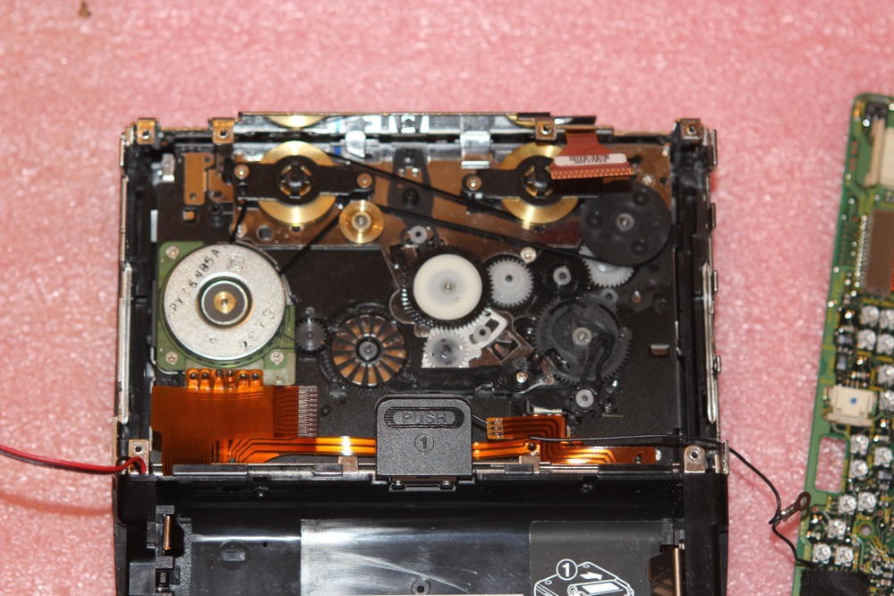

Have the service manuel for this one so ended up Buying this dirt cheap on eBay due to won't power on was $1 dollar, plus $40 overpriced expensive shipping, was cause by a poorly made custom cable as the wire were solder in reverse and ended up killing it, even if it would have work more likely would have lost more voltage thur the cable, as it was very thin gauge, which took out a zener diode ma8100tx and another diode, lucky IC took no damage and dc-dc converter was fine, so replaced the main diode, didn't replaced the zener yet as had to order a replacement, but not really necessary as it use to stable and protect the rail, will will be replace in a day. But does power on now, but did notice the volume isn't as loud as it suppose to do 15mw plus 15mw, so took digital board out and notice thoses same dodgy capacitors that I find in aiwas, took a ESR meter to them and tested bad Here a inside look of the digital board, this is made by Panasonic. Belt also has to be replace.

Ended up replaced the belt. To do so, you have to removed the second RF/Servo board PCB, not easy as you have to becareful of the ribbon cable, transport is built very well, uses two bearing for the capstans each a top and bottom bearing. This one not easy, makes d6c's look easy to repair.
