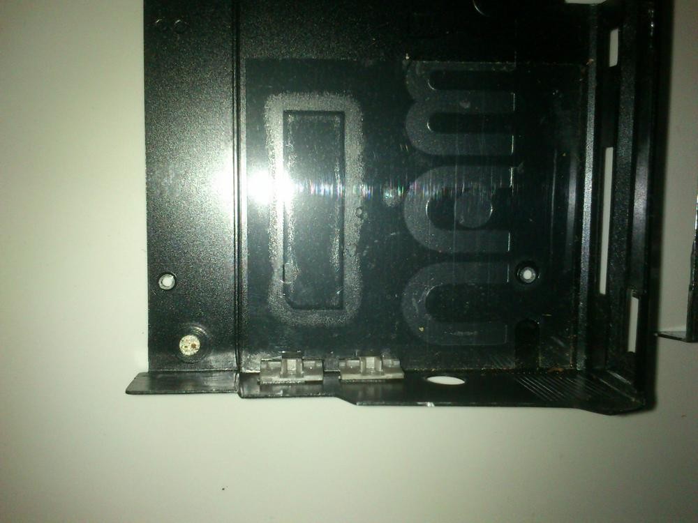

Keep the unit in its extended state preferably with a cassette inside (to prevent it from going to the collapsed state which can be a bit cumbersome later) an try remembering to prevent it from collapsing if there is no cassette inside.
Go for it in two steps first. start with the bottom end and its three screws first and then the back of the player and its 4 screws. The bottom has a portion of the cassette door engaging mechanism that runs through it...so you have to jiggle it off...take care to remember how it seats so that you can reseat it the same way.

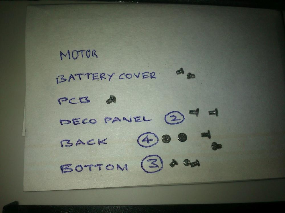

With these exquisite units if you drop a screw you are screwed so try being a little careful with these tiny fellows. I'd advise a sheet of paper folded over a fridge magnet onto which you can stick the screws in order by category so that you don't lose or interchange screws
No harm in placing a 'number' next to the legend in case a screw tries crawling into the neighboring category so 4 screws for the back, 3 for the bottom end....
