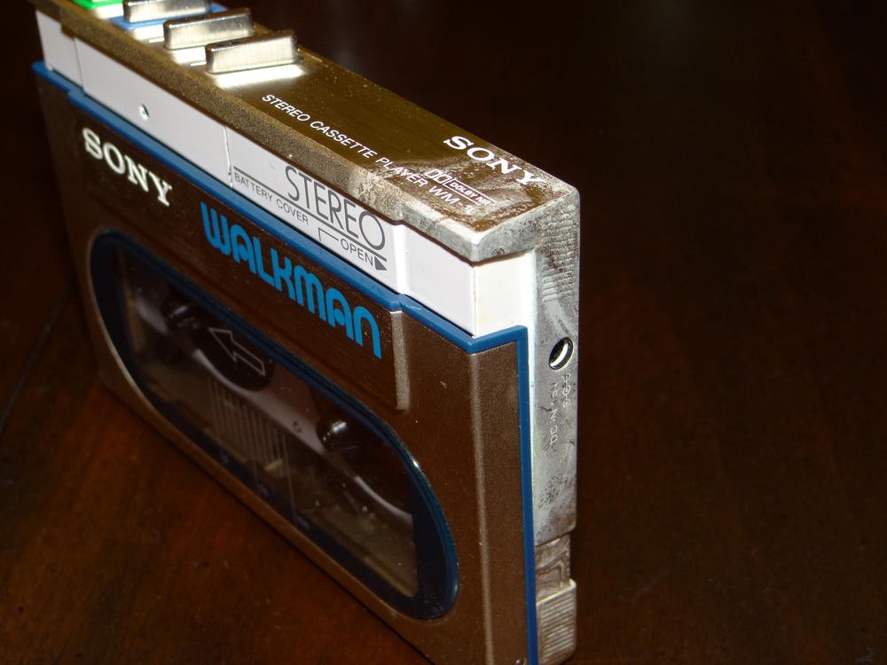

Does anybody know how to get corrosion off of a Sony WM-10?
DSC00524
DSC00525
DSC00526
DSC00528
plop - 2012-11-28 16:15
Baking soda or bicarbonate of soda (sodium bicarbonate) will shift some of that white crusty stuff. However most of the anodised paint will have been lost as a result of the chemical reaction, so alas it will never look as good as new in the end.
Mix up a slightly thick paste of finely granulated baking soda with water and let it sit on the corrosion for several minutes and then gently brush off under running water. Repeat until you can shift no more of the white crusty oxide.
You may want to fully dis-assemble the unit first before trying it.
