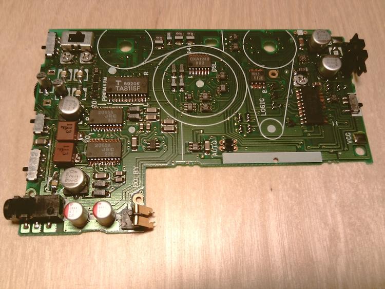

Opening the unit up the PC board was in relatively clean condition. There were a couple of corroded capacitors. Noticeably the 100uF and the 22uF 2V SMD capacitors.

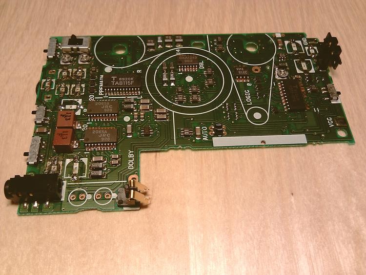

Testing the capacitors with an ESR meter, I got no readings at all from any of the 22uF or 100uF capacitors. The 220uF and 470uF capacitors gave slightly higher readings. On that basis I decided to remove all the capacitors from the PX303.
IMAG0305

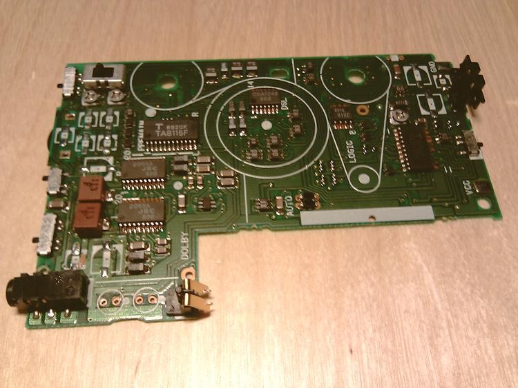

There was relatively little migration of electrolyte, so only minor cleaning with IPA was done. Some conformal had flaked off from underneath where one of the 100uF sat by the headphone jack. I will eventually go onto painting on some new conformal to replace this.
IMAG0306
The connection pads were cleaned and re-tinned prior to fitting the new capacitors.

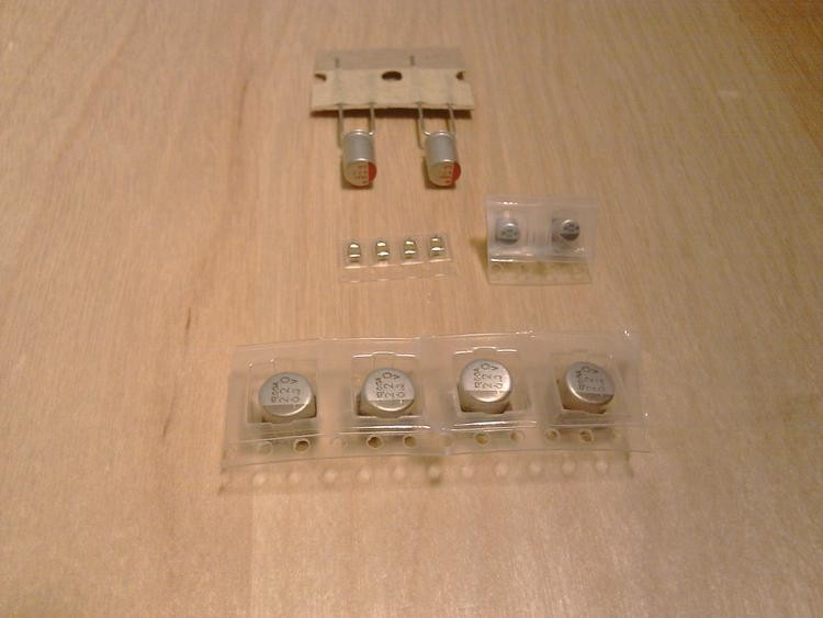

I have had to substitute tantalums for the 100uF 2V SMD as I am unable to source replacement aluminium electrolyte cans for this value. The 470uF surprisingly are microns of a millimetre small enough to fit inside their allotted spaces without any bulge to the PC board, and so would not need to be fitted sideways as previously thought.

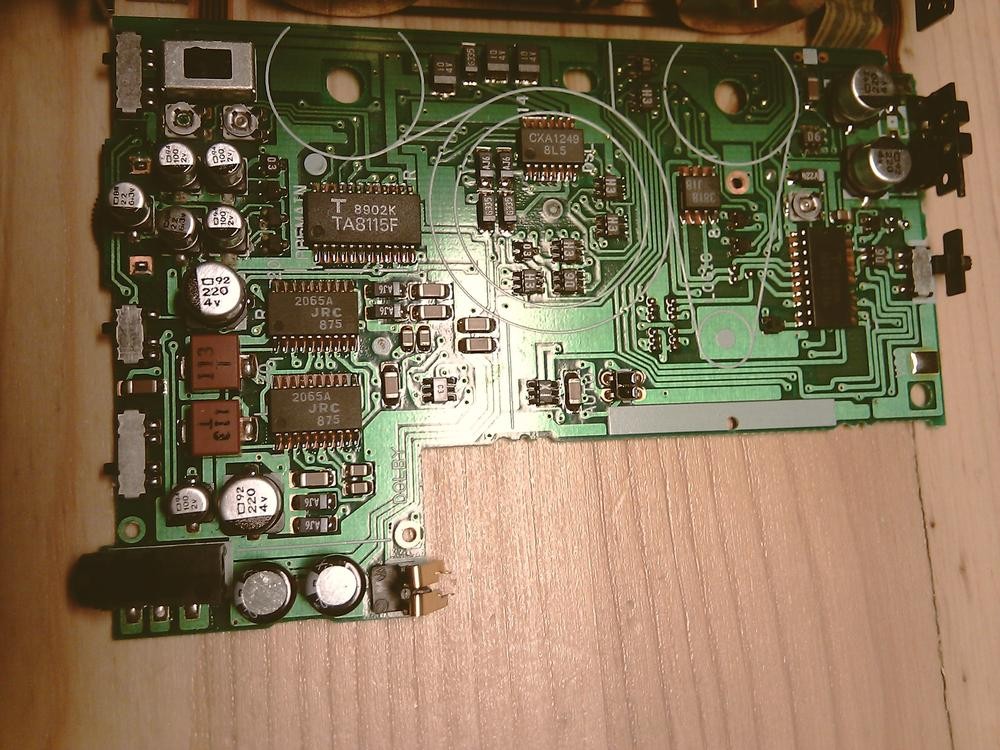

The PX303 was reassembled and tested. I have to say, even without the DSL activated I get oodles of bass. There is a decent amount of treble. Selecting "1" and either "L" or "H" There is more deep and punchy bass, with "L" the bass range is lower than at the "H" position. Selecting position "2" and there is far to much bass for my own personal taste.
Without DSL activated the amplifier is loud but not as loud as some other models. I like the sound from the PX303 in this neutral setting, however activating the DSL and the loudness is there in full effect. This is definitely one model for all those bass lovers out there!
