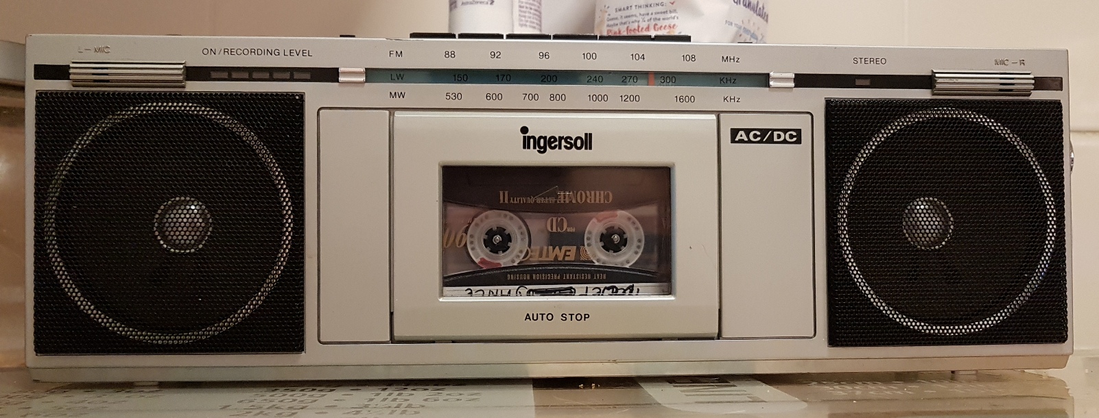

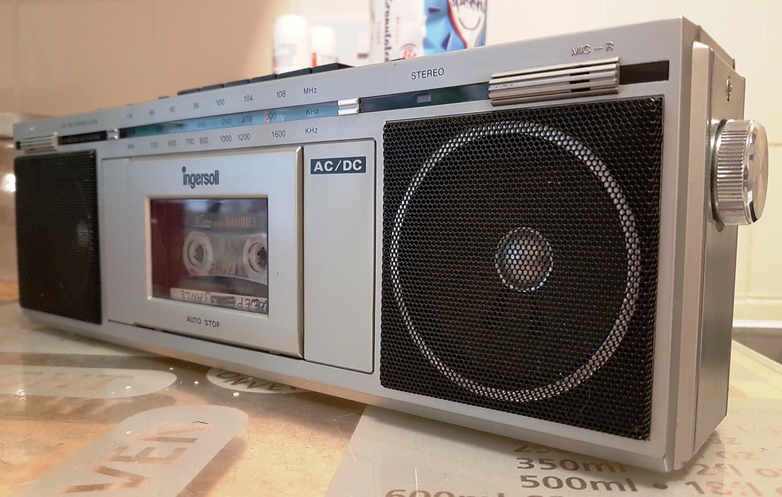

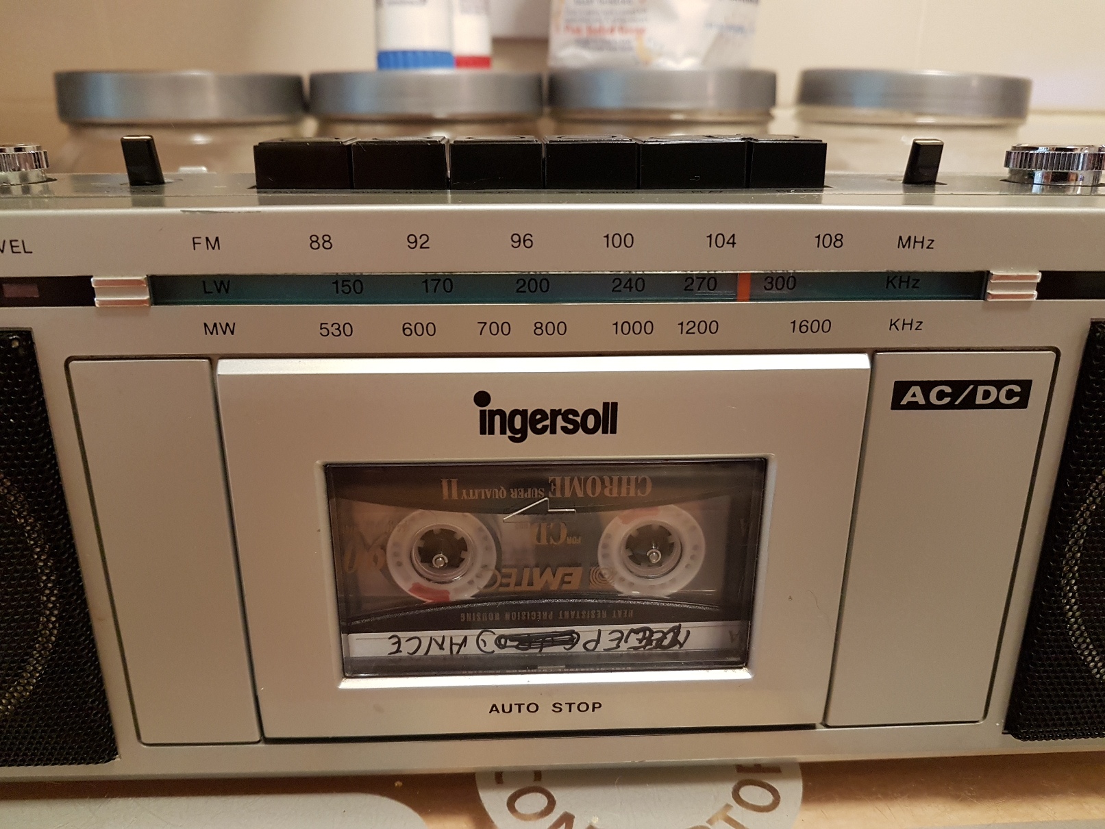

    I have had this for a good five years just sitting in the 'Boomer Store Room' I felt sorry for it & had to save it, used to own one of course back in the day around 1982 (A great year for me!!)

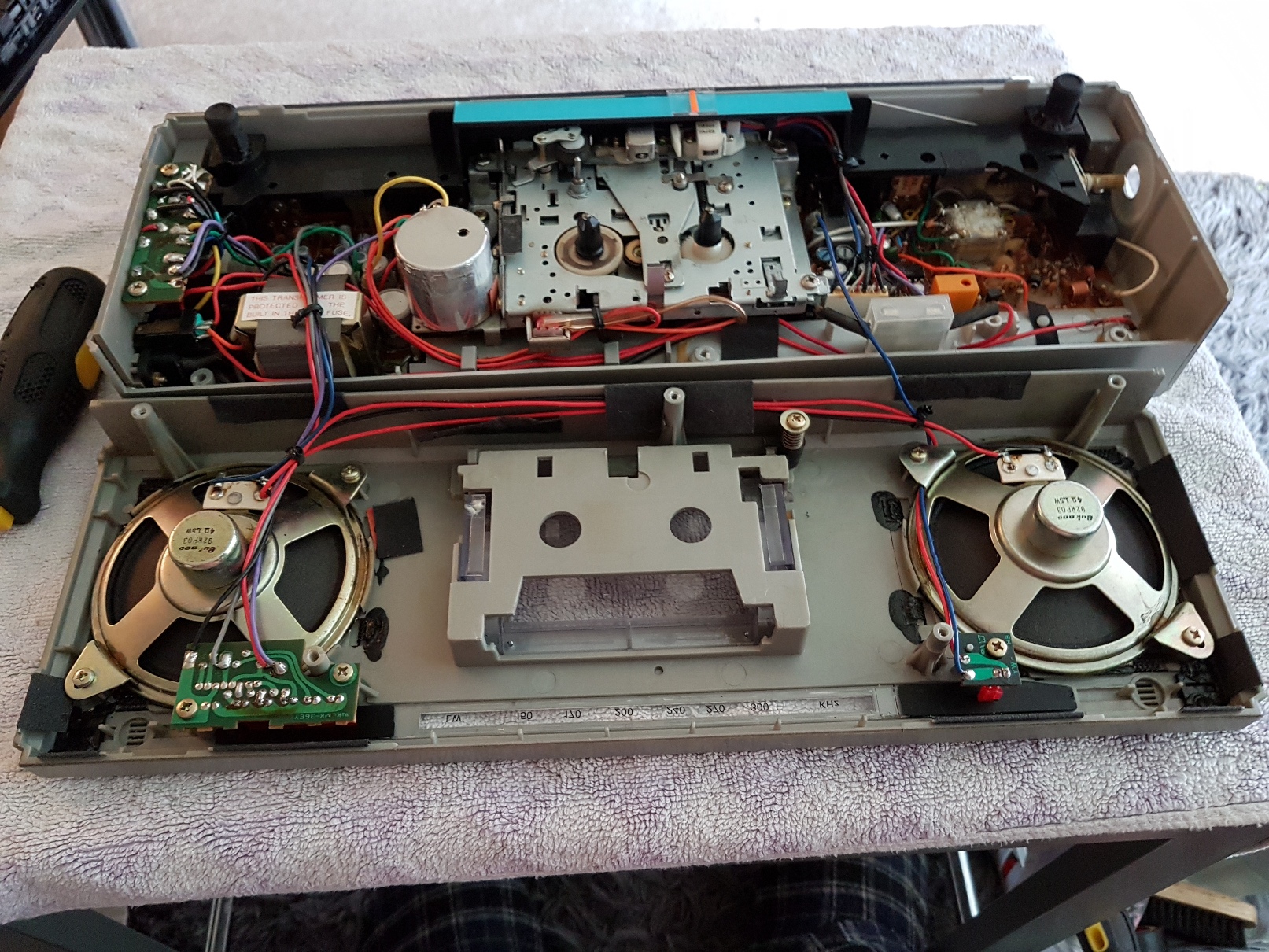

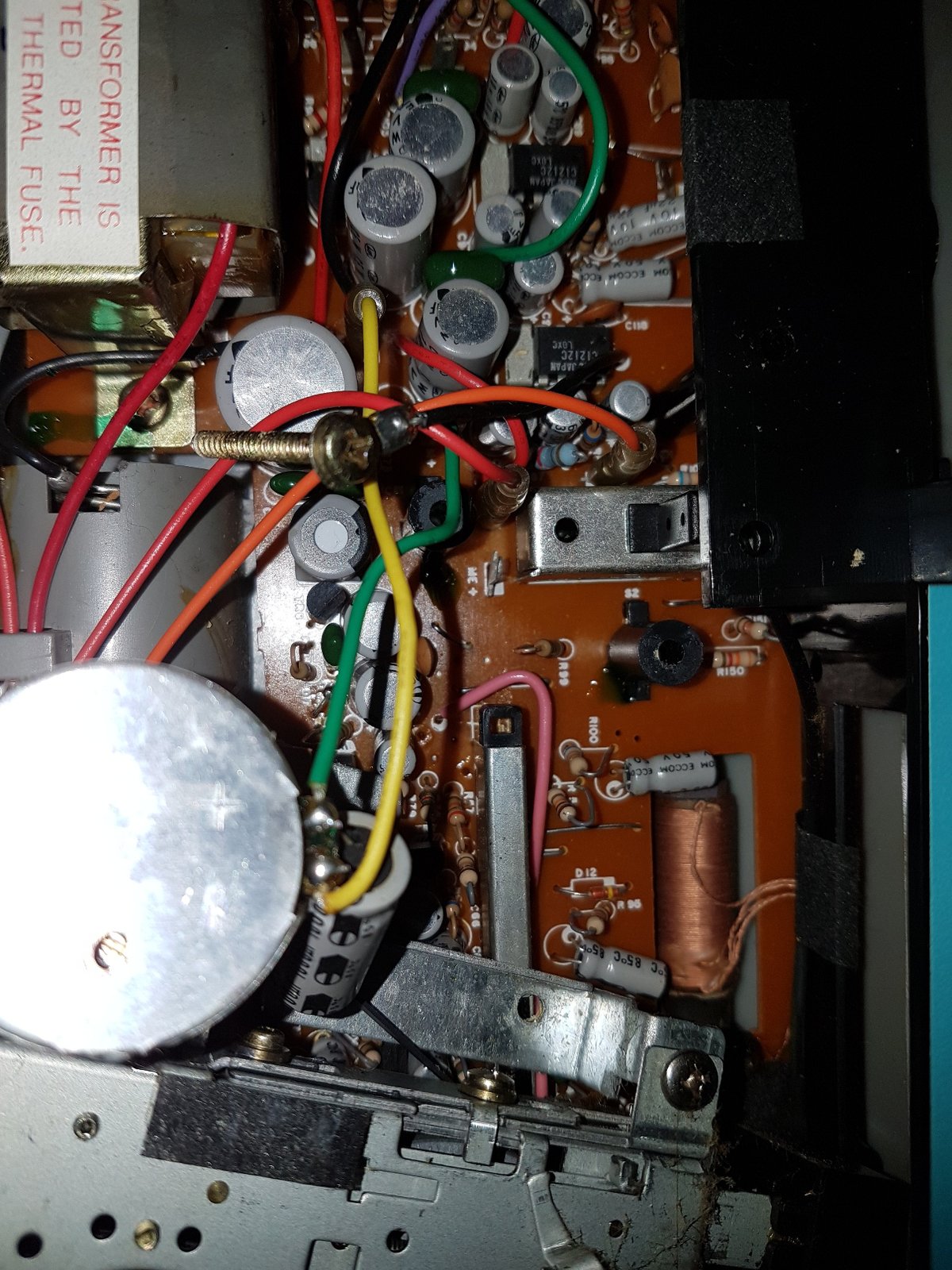

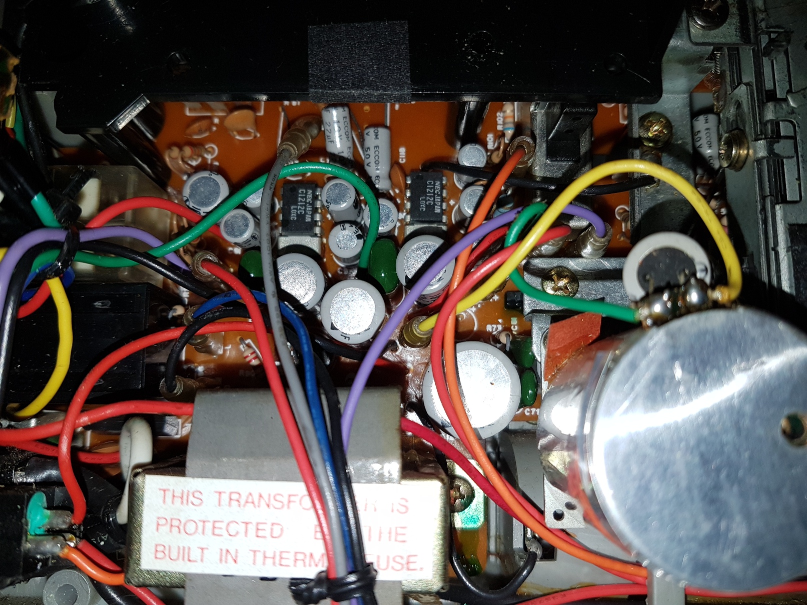

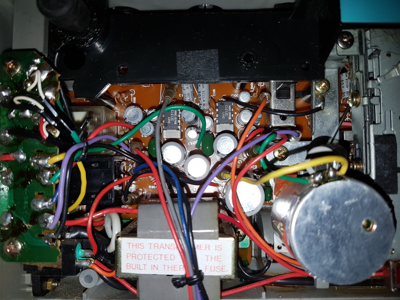

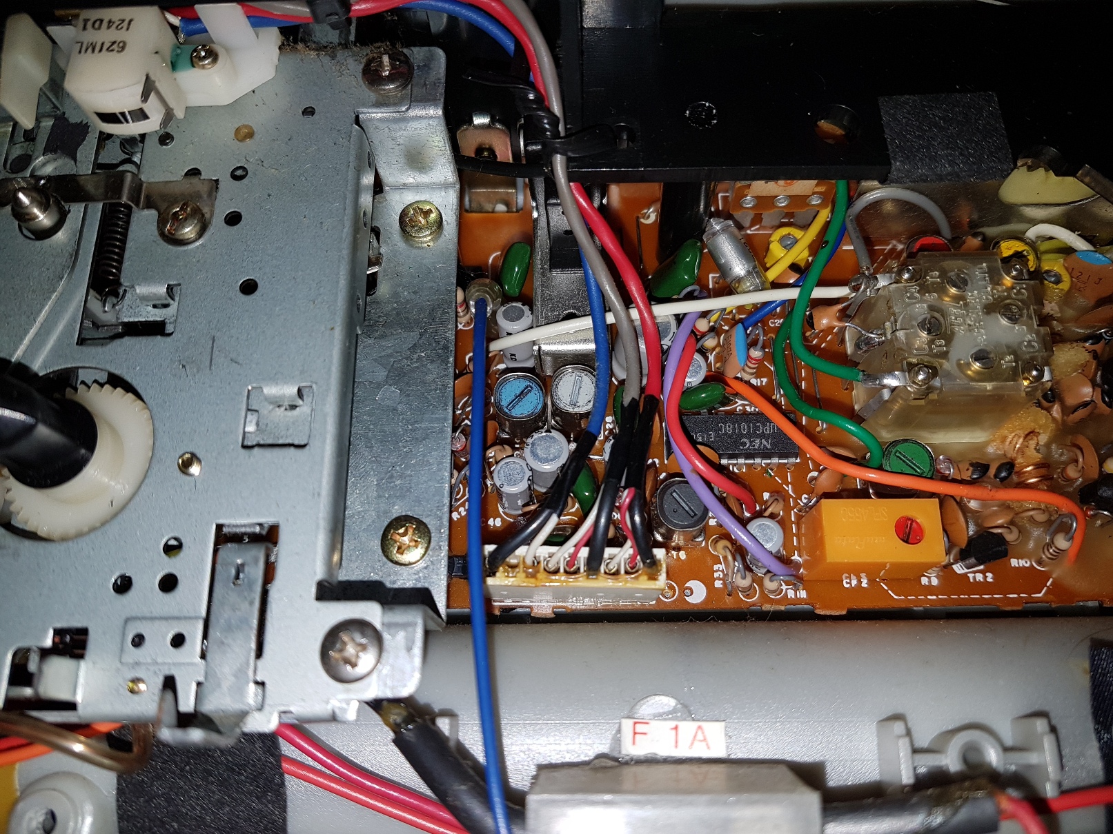

    This was filthy & dead so time to investigate!! I guessed this would be a fairly easy job & it was.........
    Seized motor, stretched belt & mains fuse blown!! I was very surprised to see a flat capstan belt & a large flywheel in this little Ingersoll, I expected 'Mickey Mouse' throughout this machine but that wasn't the case at all...........everything pluggable & really easy to get access to the cassette mechanism! :thumbsup: :thumbsup: :thumbsup:
    Capstan shaft & motor bearing oiled, it was time to replace the mains fuse & power up - All good so far!! Motor running silently & after oiling both reel shafts (Almost seized reels) it was time to clean heads & pinch roller which were very dirty & seemed to take forever :eyepopping:
    Plugged in my headphones (Speakers were off in the front panel) & played a tape........
    Speed spot on with no instability at all - that's what we want to hear :thumbsup:
    Tiny azimuth adjustment required to restore maximum treble & channel balance & suddenly this little Ingersoll sounded ace through my earphones :guitarist
    Now I know this little units speakers are small & not up to much but after cleaning the case & reassembling, she works like new in every way & looks so clean & new :biggrin: :biggrin: :biggrin:
    An easy restore & am glad I did it now...............
    Another one saved from the skip :biggrin: :biggrin: :biggrin:

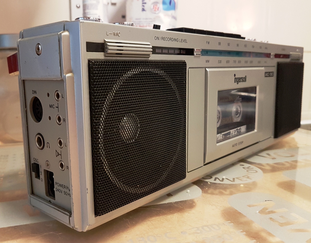

    Oh & VIOLA!!
    Here she is :bigthumbsup: :bigthumbsup: :bigthumbsup:
