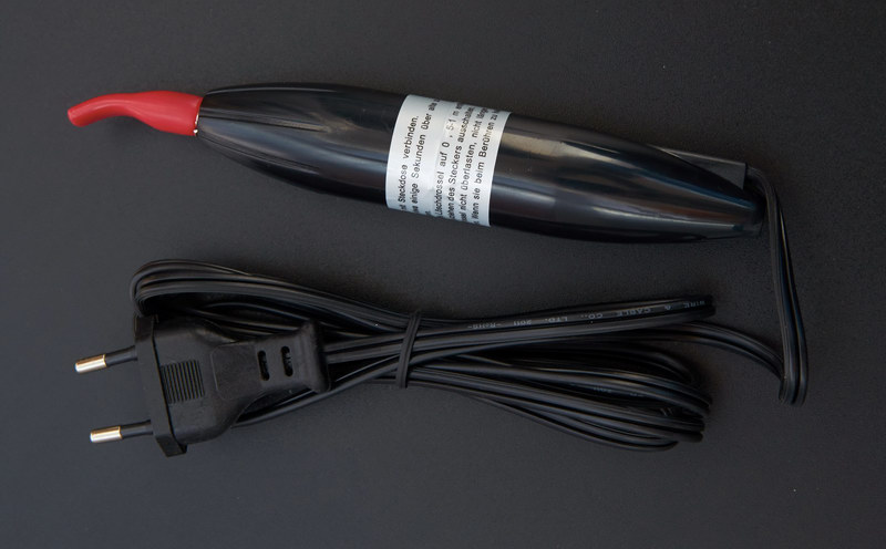

    I think I have to buy a head demagnetizer (I do not have it) ... any suggestion on what to buy ?
    thanks

    i do use a TDK HD-30 head demagnetizer cassette. works absolutely perfect (pic is just a sample from the net, doesn't show mine wich is grey, not red)

    I have this one and also another one that is way more powerful:
    I bought it at eBay years ago and it has served me well to demagnetize my decks. You should be very careful with it, though. It has a very strong magnet field...

    How does it work? do you need to hold it next to the cassette player's head for a specific time or move it in a specific direction?

    That is the most readily available on ebay but i'm afraid too is it too powerful for walkman heads. Do you also use it on your DD's ?
    I think it is intended for R2R with bigger heads and more robust electronics.
    thanks

    I think it can be used with decks and walkmans too, but @Doctor Walkman can answer that.
    You have to put it very close to the head (a pair of mm), connect it and slowly take it away from the head. When it's about 1,5m or so, you can disconnect it.

    That's what I use as well. Take all recordings a few meters away from the demagnetizer just to be safe. The advantage is that you can demag capstans with the wand. All new machines I get go through a demag, and after any head alignment.
