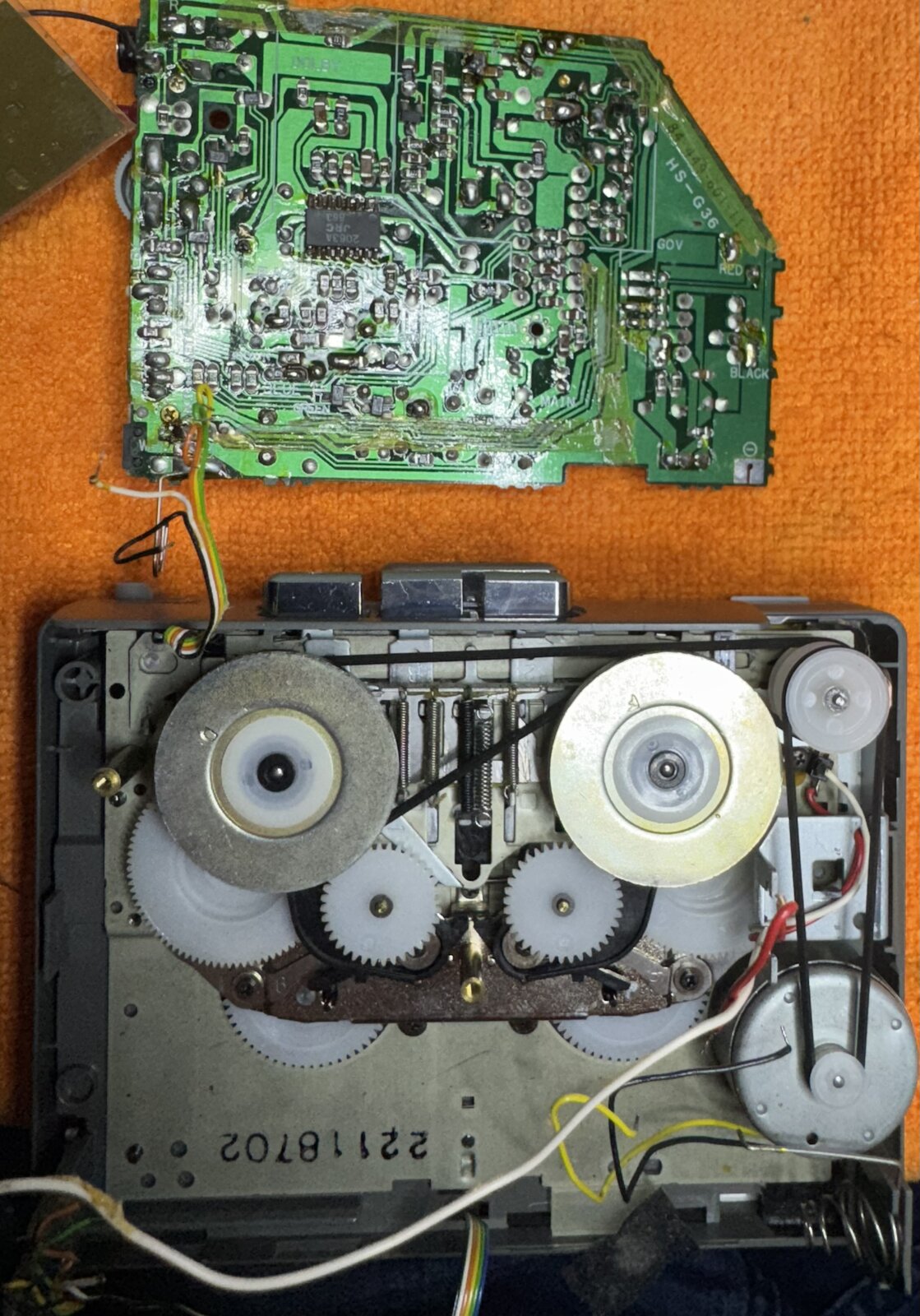

    Finally I opened it.
    3 screws on back cover (2 on the back and one on a side).
    There is some clips around that has to be unlocked, I used a Mobile phone plastic tool...
    2 clips near the batteries place has to be pushed with help from a screwdriver or similar, I had to push on each clips going through the battery compartment...

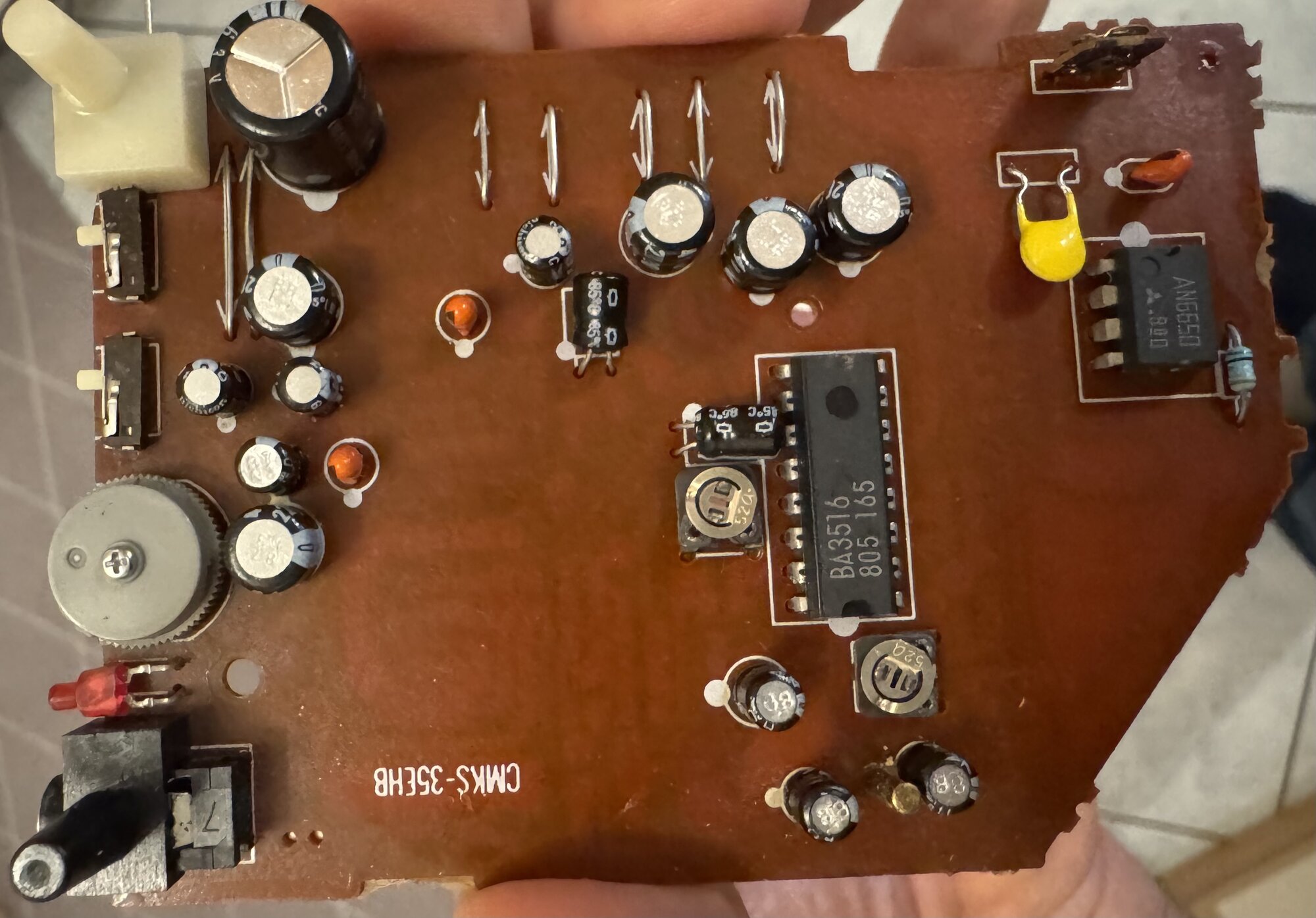

    I unsoldered all the wires from the motherboard to be able to work on it easily. Time to recap and new belt (not so bad but as it's open...) plus solder joins inspection....
    Caps :
    5X 220uf / 4V ø6.3 x 6
    2X 1uf /50V ø4 x 5,5
    2X 2,2uf / 50V ø4 x 5,5
    4X 47uf / 4V ø4x5,5
    1X 10uf / 10V ø4x5,4
    1X 1000uf/6,3V ø10x12,5

    Belts you can get from DeckTech: https://www.ebay.com/itm/224456754842
    Regarding the mechanism, can't see anything obviously wrong. But if the belts are a little bit loose, this is a symptom you will get.

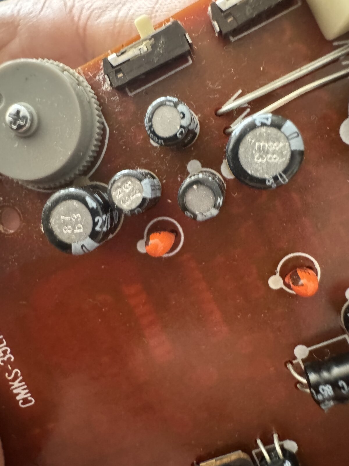

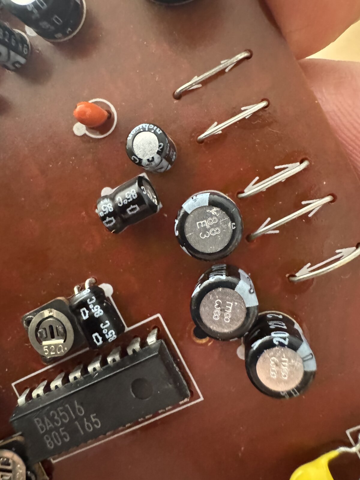

    Concerning the caps, I did notice that almost all caps except 4 have an engraving on their top. "88 E3" and "80_" for the smalls 2,2uf;
    See picture.
    Can I deduct from this that all caps except the 4 with no marks on the top are Nippon Chemicon ?
    If yes , I would have just to replace the 10uf and both 1uf plus the 1000uf...

    See the Nippon Chemicon logo in the picture attached.
    The 88 E3 looks like a date code and batch number, it's probably stamped only on bigger caps due to space constraints.
