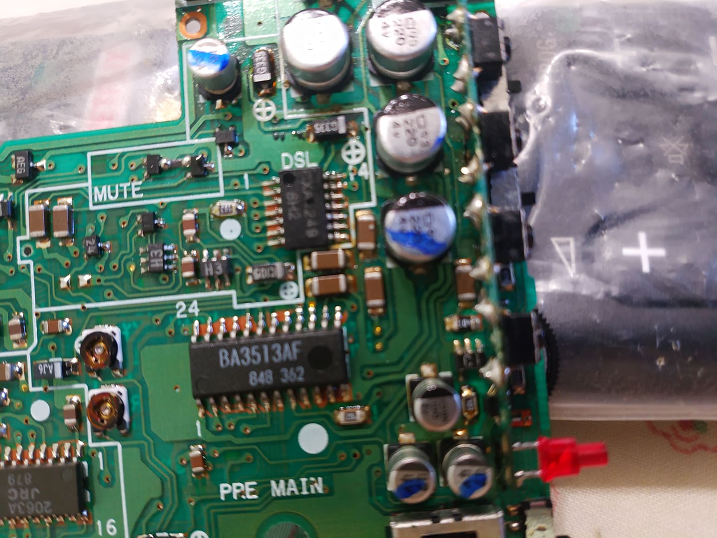

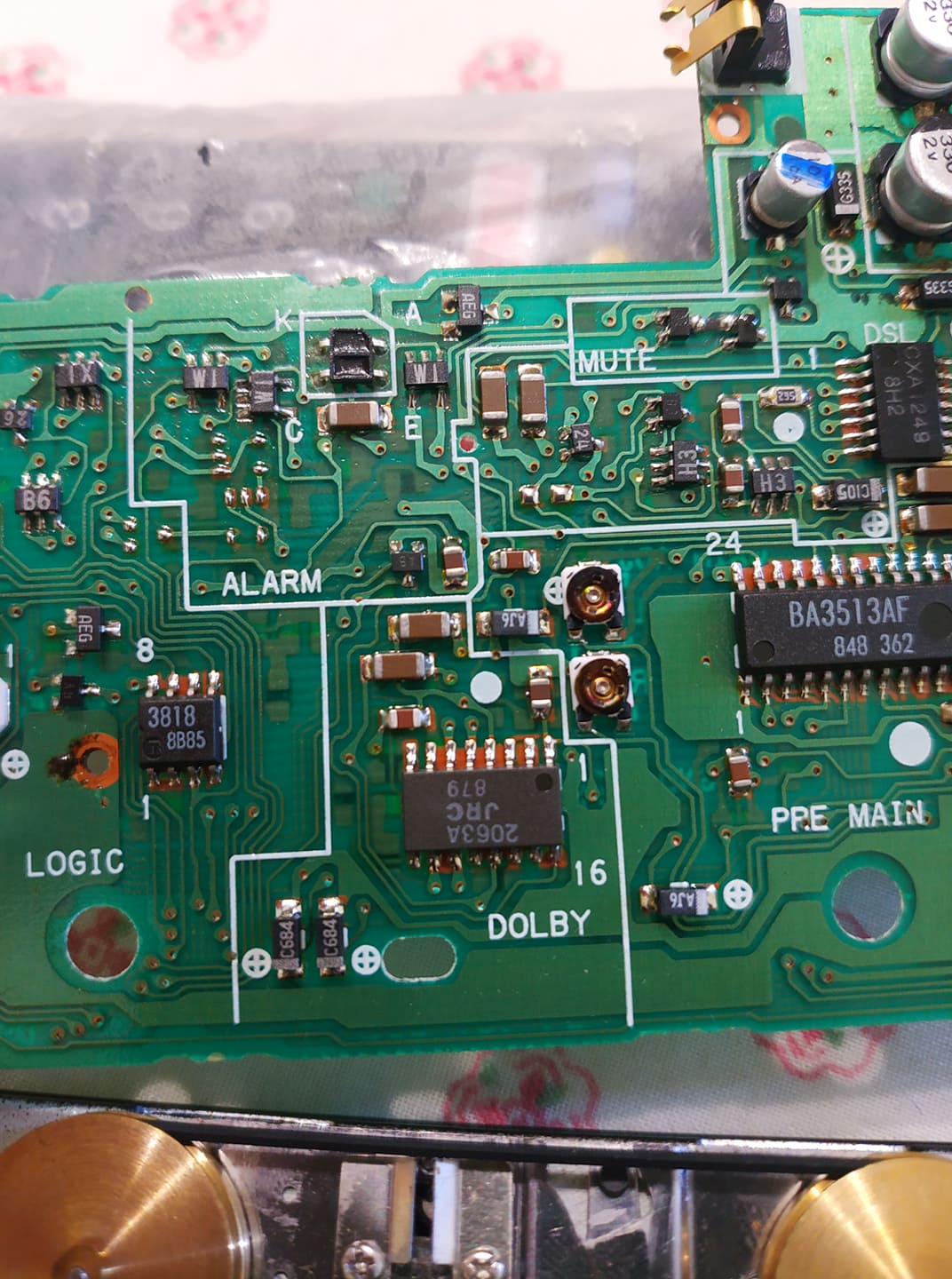

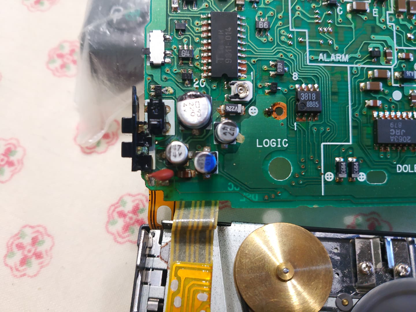

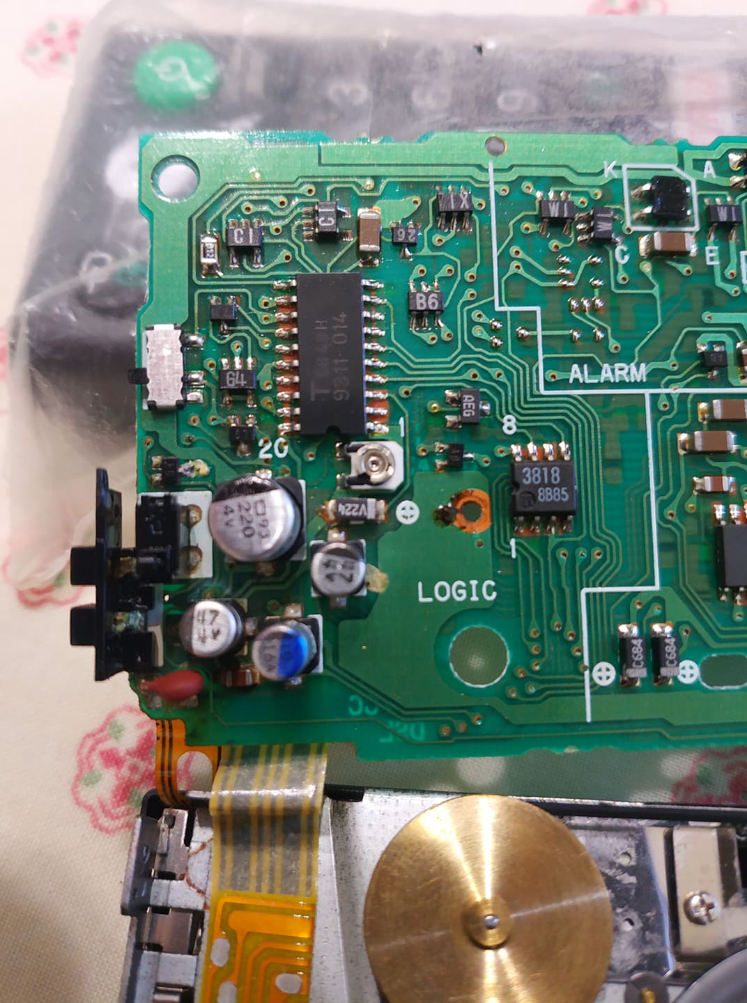

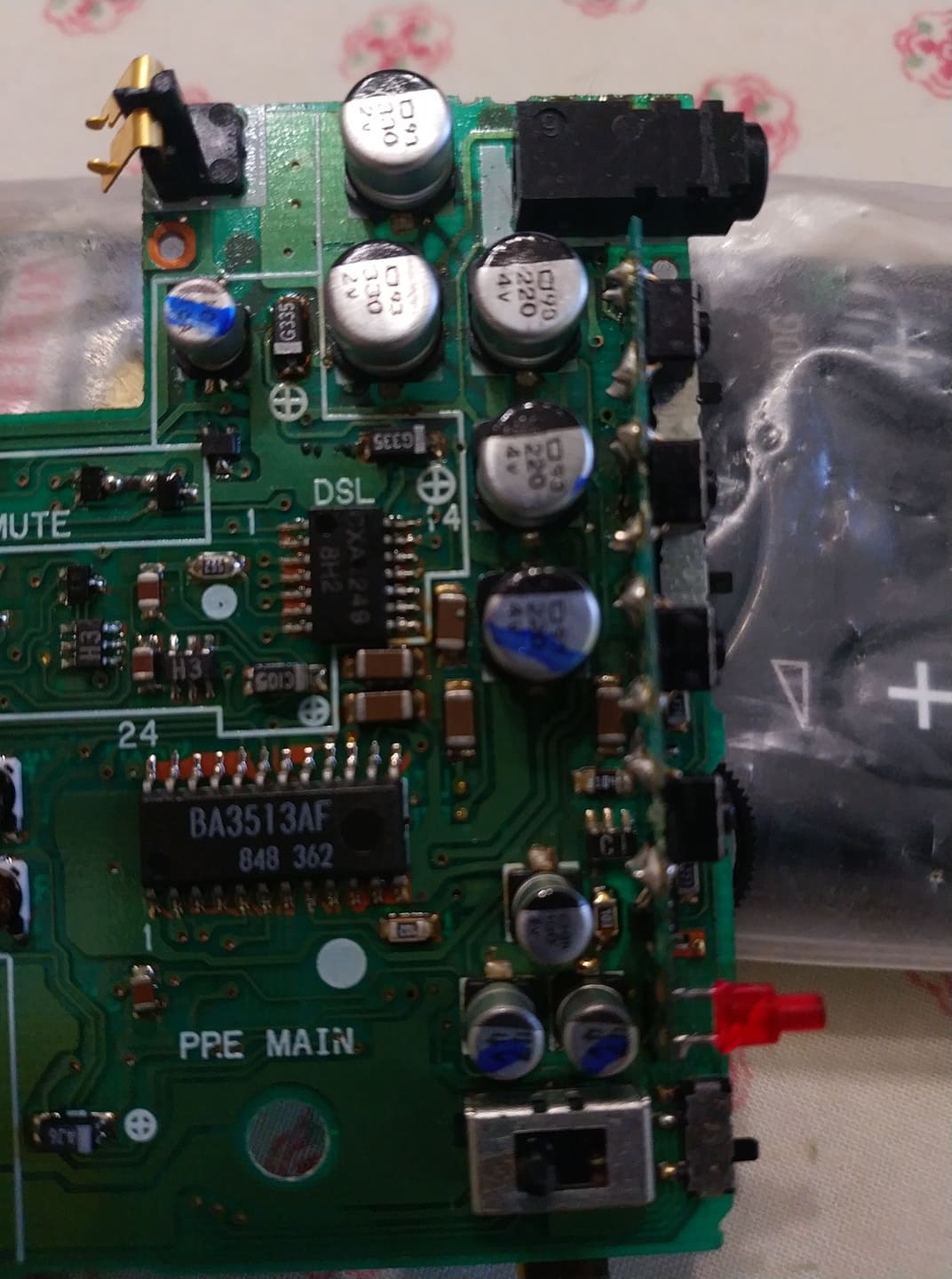

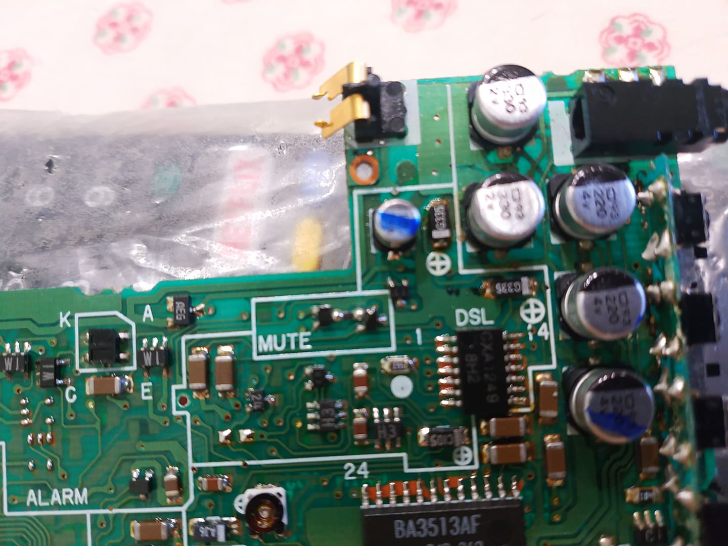

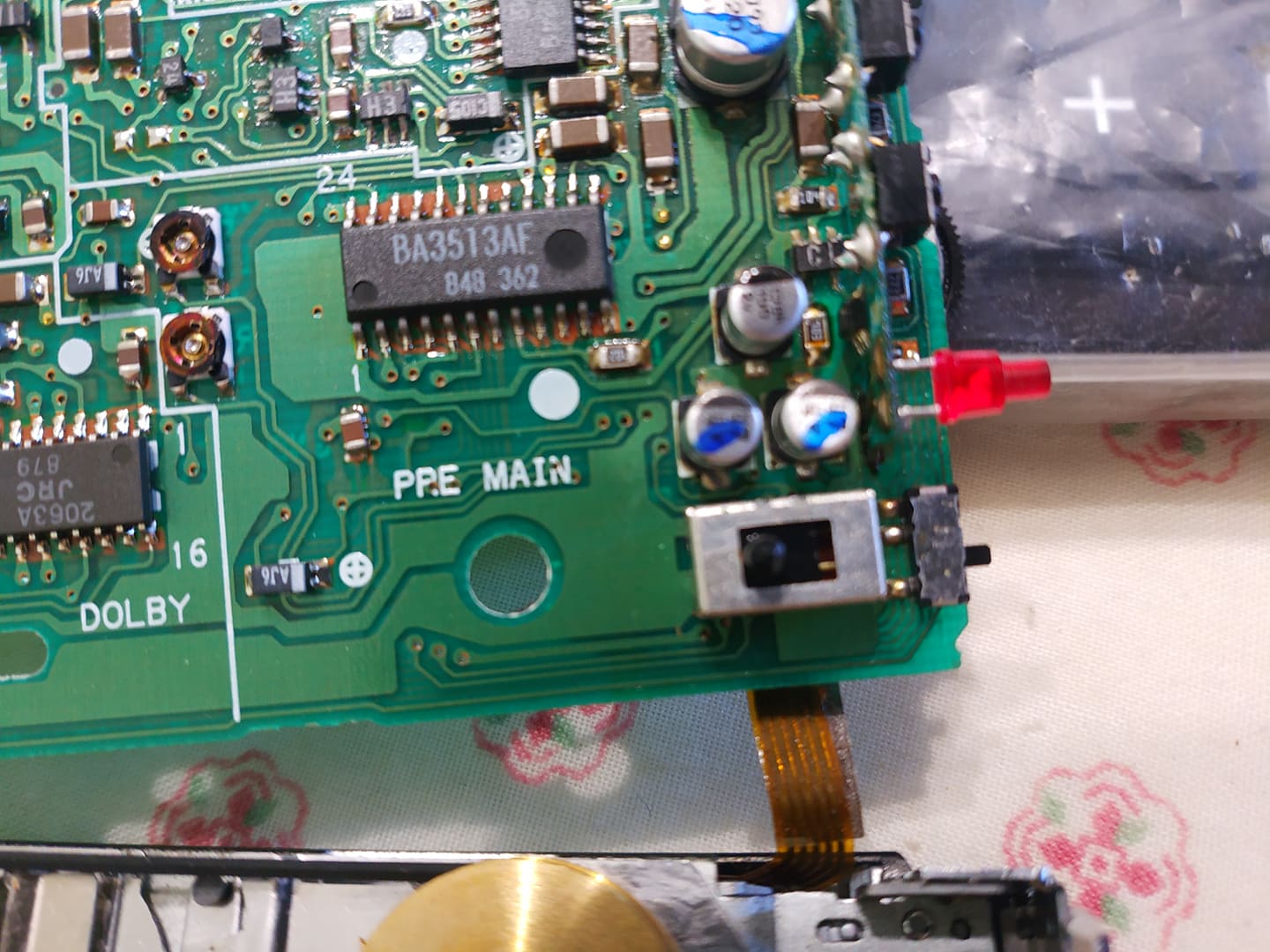

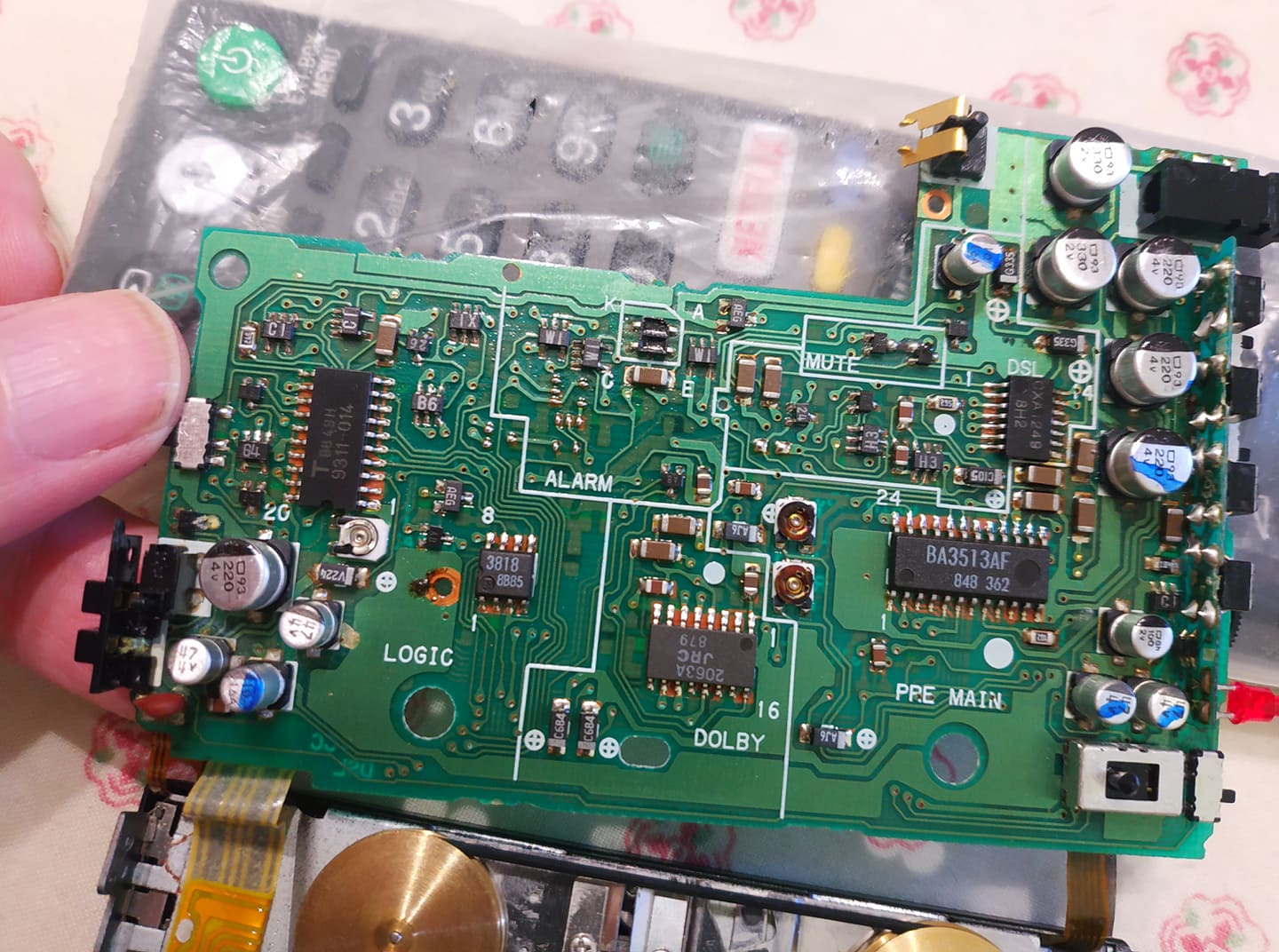

    The capacitors will be here next week,i took some pictures from the board as it is now.

  7. Valentin
    2,009
    Will do that. There is more to be seen, the IR sensor will likely need a new LED part. Dolby levels adjusted, mech lubrication.

    Sorry for the thread necro, but I just found my one of these all packed up in my mums loft. It was all there, box, headphones, 2 batteries (PB-3s) charger, AAA adapter, fake leather case and manual all from January 1990 - I have the receipt too! £91.10 bought on 13th Jan 1990 when I was 16.
    the batteries didn't charge - which I pretty much expected but when I put a tape in it did turn, (using Rechargeable AAA batteries) but was very very quiet.
    Can anyone offer any advice on how I can get this guy working again?
    Could the low voltage of the AAAs - 1.2v be a problem?
  9. Valentin
    2,009
    No, should operate on NiMH batteries just fine.
    Having very low volume is the typical symptom of failed capacitors. You need to replace the capacitors, values are visible in pictures.
    Note all of these caps are very small footprint (5mm height), so you need to order the smallest possible.
    SMD tantalums are an even better options as they will be easier to solder, won't fail again and are much more readily available.
