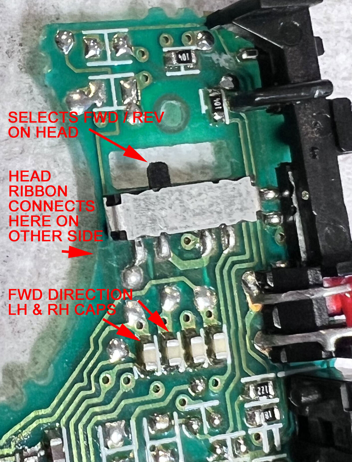

    ...it's been a while, but I've just re-enthused myself into repairing the 9 machines I have - 310's, 510's and 327's.
    I have just resurrected the two HS-PX327's. One is 100% working and I am reminded how great these sound - well worth the effort. The other is 90% with a very annoying problem that in FWD the volume is reduced and the RH side is quieter.
    I changed the head, the switch which selects which side of the is connected to the amp and also the tiny caps for those channels - makes no difference. I assume that the main caps I changed wouldn’t be the issue as both FWD and REV would be affected - is that right?
