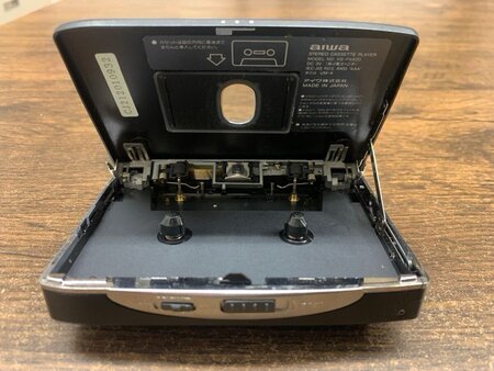

  2. Minidiscboi
    Minidiscboi New Member
    4
    Usa
    Here she is
