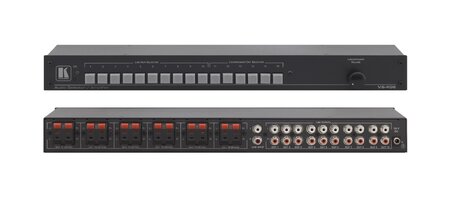

    yup a five way kramer all jubbley. stereo mini unput ... a pair of gain trims a five stereo buffered outs..,on mini jacks. they do a stereo in and eight stereo outs ... heres another solution and the sokkits on s kramer...
    oh yeah... Kramers are good enuff for Lucas Films they should be good enough for temples of loud.

    and an eight way speaka switcha!!! fk yeah! im glad the belts and the braces are thought about here. 046D84CE-B050-4015-8D3C-F6B929E9C1F3.jpeg

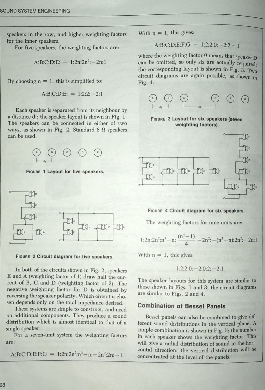

    very tru Longman ... you are talking about Bessel arrays... speaker stacks that conform to bessel functions. Very interesting guy Bessel mustve been to see so clearly as he did.
    In the Sound System Engineering bible (which im sure you all have by your bed) theres an excellent no bs section on Bessel arrays...
    if you have a soundbar on ya telly ... thats one!
    I’ll photo the five pages neccesary to enlighten yassel to arrays... gimme five.
    yada yada i kno i digress ... aint exactlerly ya 8 boom wall please is it... yes i kno... im ungovernable tho.
    so without rules laws or guidance... pics of science to follow

    ok tapeyFreakys theres a bit of homework for y’all... pay attention at the back. class dismissed..
