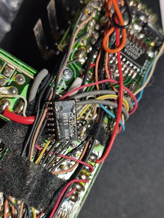

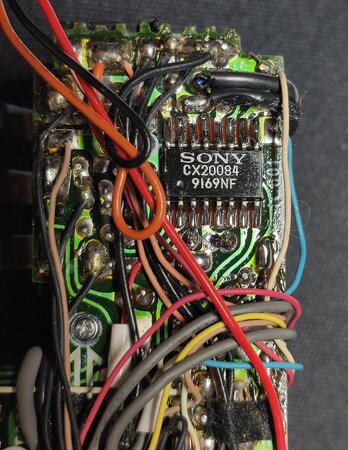

    I attach 2 pictures of genuine ones below. The older one (date code 8911) is what was installed from the factory in most older D6Cs/D3s/DDs. The "N84" at the last does vary, especially between D6C and D3/DDs.
    The newer one (date code 9169) is what will be mostly found today for sale, while the older ones without SONY logo are rarer and harder to find. Even the newer type has become pretty rare these days, but it's not impossible to find one.
    EDIT: Further digging suggests the newer D6C with SMD PCB does use a servo IC that looks very similar to what is depicted above. It has a different format date code most likely and the font/color is also different than the 2 versions I have shown.
    That is why the only 2 types that I would consider are the ones shown below. As for the ones in picture above, there's just no way to tell if they're genuine without soldering them and testing. Of course, it is to be mentioned, just working is not enough.

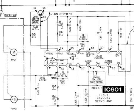

    @Silverera The CX20084 is not a potted hybrid module, so there isn't anything to strip down. If we are to do that (assuming we could do it without damage to bond wires and the die itself), there is still nothing that you can repair at that level.
    Inside the package you will find something like this (keep in mind CX20084 is much more complex than the op amp shown here): https://www.righto.com/2018/06/silicon-die-analysis-op-amp-with.html , which can only be used for reverse-engineering the circuit.

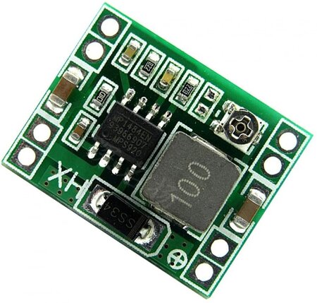

    thus I thought of a third option;
    There is some space behind the main circuit-board on the D6C (above the DC/DC regulator). I ordered a simple regulator board (at least it appears small, picture enclosed). I might try - just as a proof of concept - reconnect just the motor to the regulator board via switched 6V. This could well bring down a static voltage to an acceptable level - however, the speed regulation would of course be missing (as nothing reads of the coils anymore).
    If I perform this experiment I can post the results here. Theory: the first Walkmans used similar motors, these motors were very good and produced decent results even without the quartz lock.
    Fully aware this is a sub par solution, it might revive my D6C (which works perfectly in every other respect). An additional board would do minimal damage to the main board which later could be restored with a CX20084, should I ever find one.

    @jacobsteel Unfortunately the third option proposed by you is something that will not work in practice for a couple of reasons. Let me explain further: even the most basic cassette tape player has some kind of motor governor, meaning the motor speed is regulated to be:
    - independent of load (you get load variations as tape spools, load variations depending on position of walkman, load variations depending on beginning/end of tape); this is a must have, otherwise, wow&flutter will be all over the place and you just cannot obtain a stable speed;
    - independent of battery voltage (this can be achieved by a regulator, however a linear one would be more appropriate since the switching type has a lot of high frequency ripple and depending on topology it will also have some low frequency ripple);
    - independent of temperature (the walkman should work similarly at room temperature as it will work at 0 degress or lower); there needs to be a mechanism to compensate for this and most regulators don't have one because they're not voltage references;
