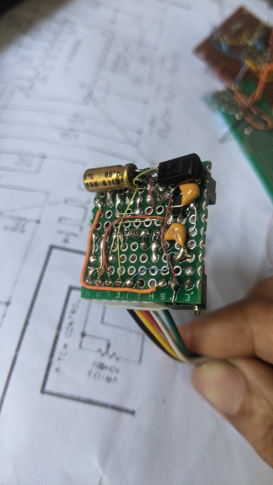

  11. Hn14197
    Hn14197 New Member
    10
    Vietnam
    BA6301 IC is feasible and Wow&fl look good

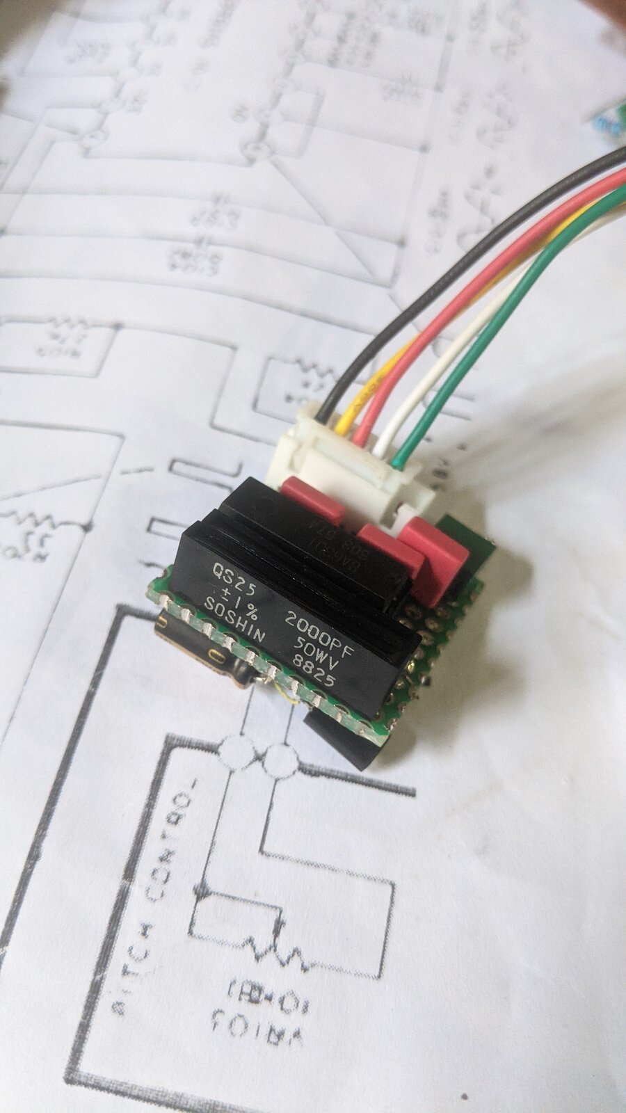

  14. Silver965
    Silver965 Well-Known Member
    724
    Torino
    Hello,
    I ask you if you managed to make a circuit small enough to let it go inside .... what I see in the picture I think is a prototype I would say quite voluminous
  15. Hn14197
    Hn14197 New Member
    10
    Vietnam
    Absolute possible. very few components, with SMD resistor
    Doorz, Emiel and Silver965 like this.

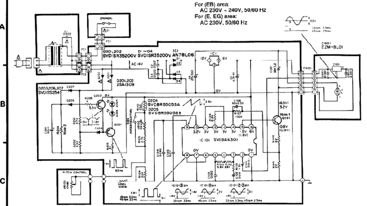

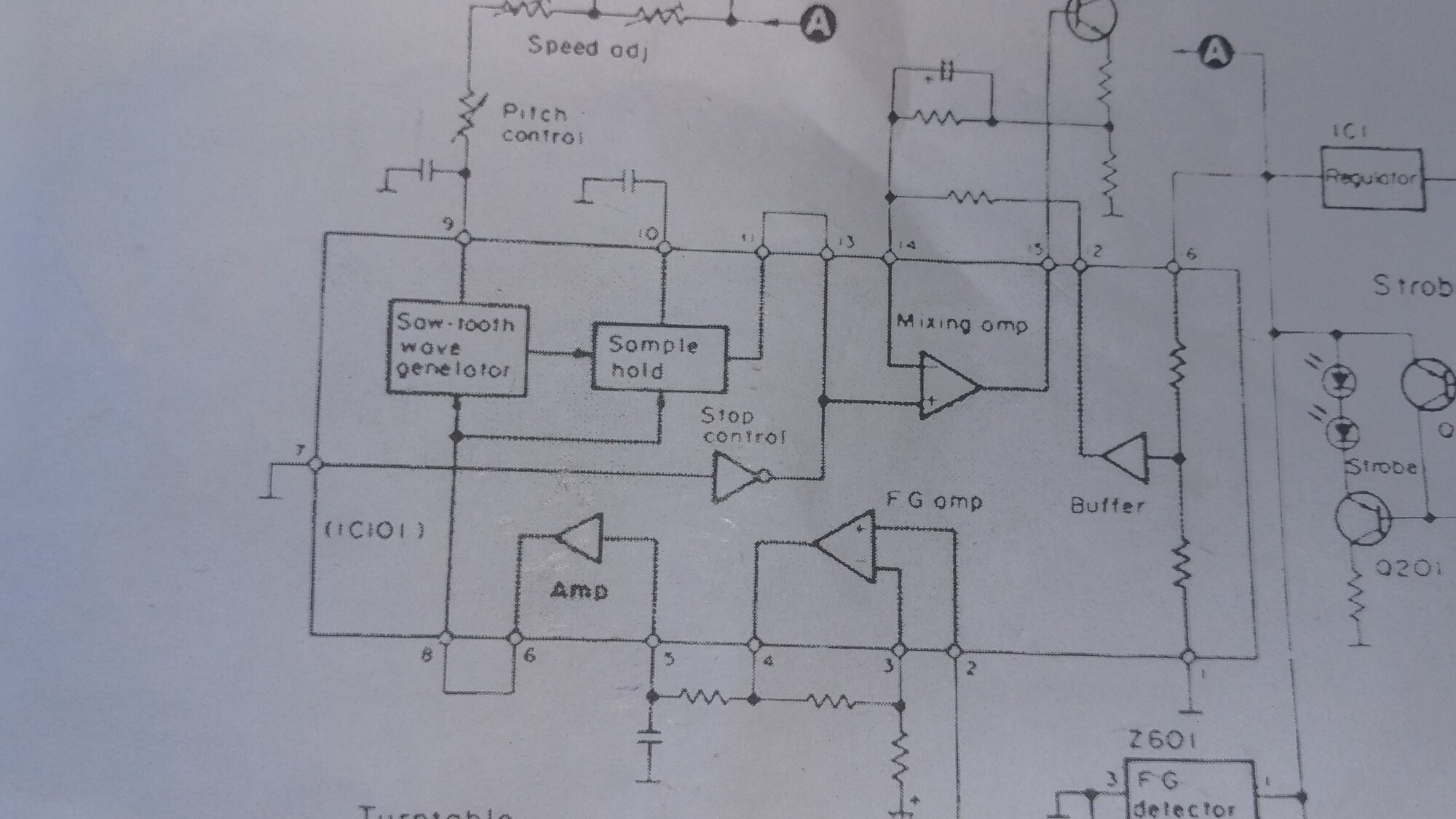

  16. Silver965
    724
    Torino
    Just because it is a topic that interests many
    The block diagram you see in the photo of @Hn14197 comes from a Technics sl-bd22 turntable ..for those interested
    Wombat, Emiel and Valentin like this.
  17. Wombat
    Wombat New Member
    27
    Australia
    I wouldn't be surprised if it was the same thing tailored to Sony's requirements.
    Rohm developed many, many ICs for Sony...
    Ford were great at doing this in their engine management systems, taking jellybean components and attaching their own codes to them so you cant easily replace them when they go bad.
    Do you run this on the 12V system or the 4.5V system?
    How does it perform below 4.5V?
    Are these easily obtainable?

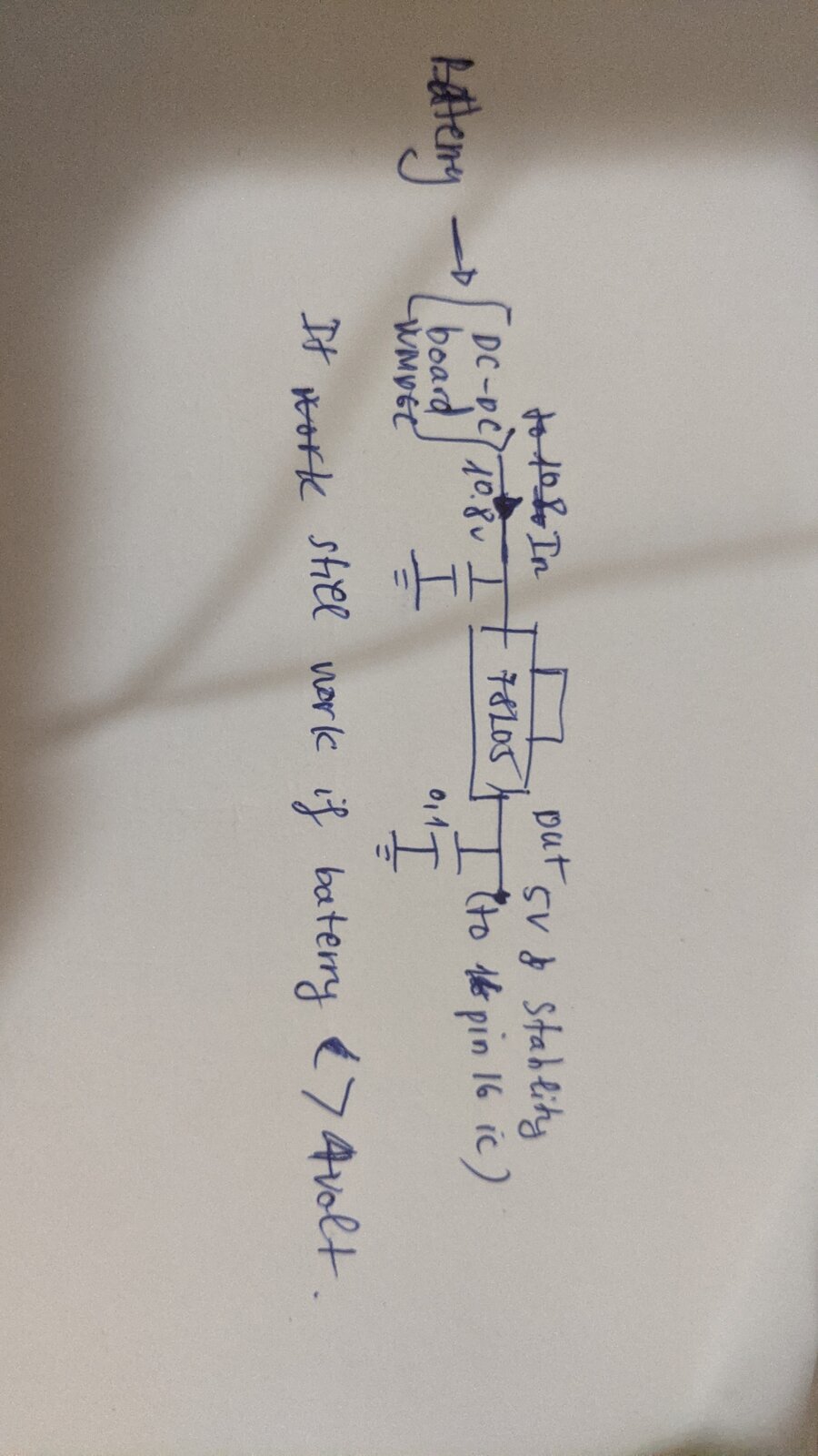

  18. Hn14197
    Hn14197 New Member
    10
    Vietnam
    Thanks for your question. We can use 78l05.
    Finaly, wow flut is pefect!
