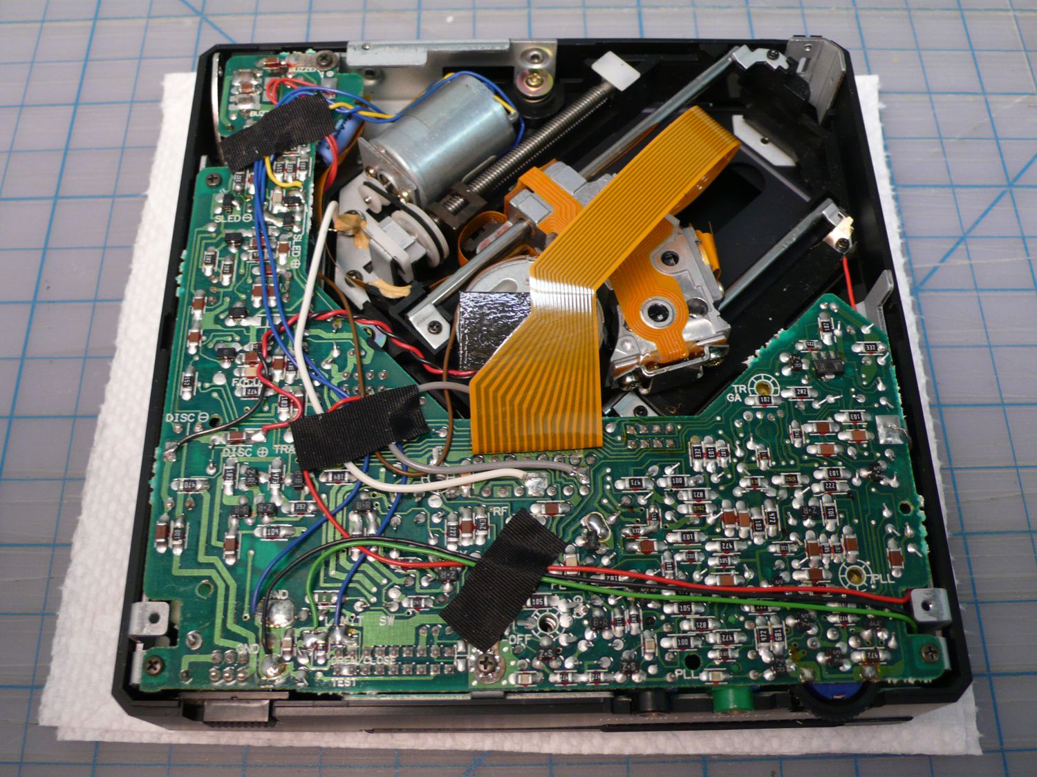

    I was talking about CBM-1000 posted here by @Mister X.
    Below is a snapshot of my conversation with Master Gu (Kaosun) about this PCDP (PortableCDPlayer):
    CBM1000
    RF amp: CXA1081
    Servo amp: CXA1082
    DSP: CXA1125/1135
    CPU: HD????? (forgotten)
    DAC: NEC UPD6376
    AUDIO amps: NJM4558
    Optical head: SONY KSS220
    Its design of membrane control panel nice but not durable. Its switching step-down power supply often get problems.
    This problem will cause over heating and melt the membrane comes from the control panel which is connected to the main board.
    Melting will cause no display, lacking segments, and key-pressing no responses.
    D6376? No. NJM4558? No.
    I think Citizen is a good maker of watches, not for PCDPs.
    Instead of an infamous Sony Discmans "middle gear" CBM1000 has a belt-drive for the sled: the first thing to be changed (belt available from TurntableNeedles.com):
    In mine I narrowed down the problem to the busted DC-DC converter, but never bothered to fix it. S2G sidetracked me onto cassettes and boomboxes :D

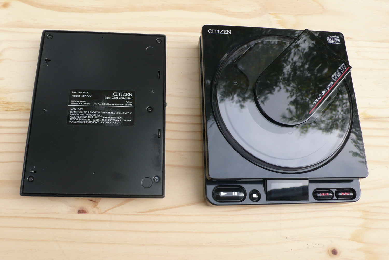

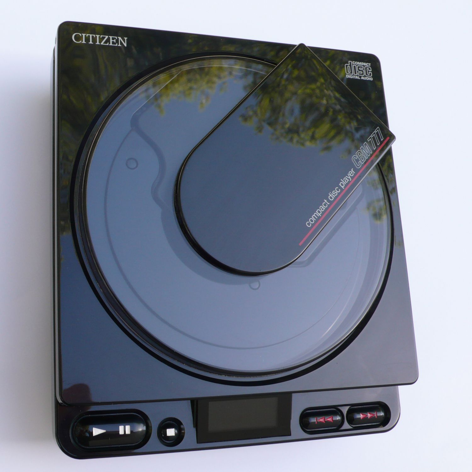

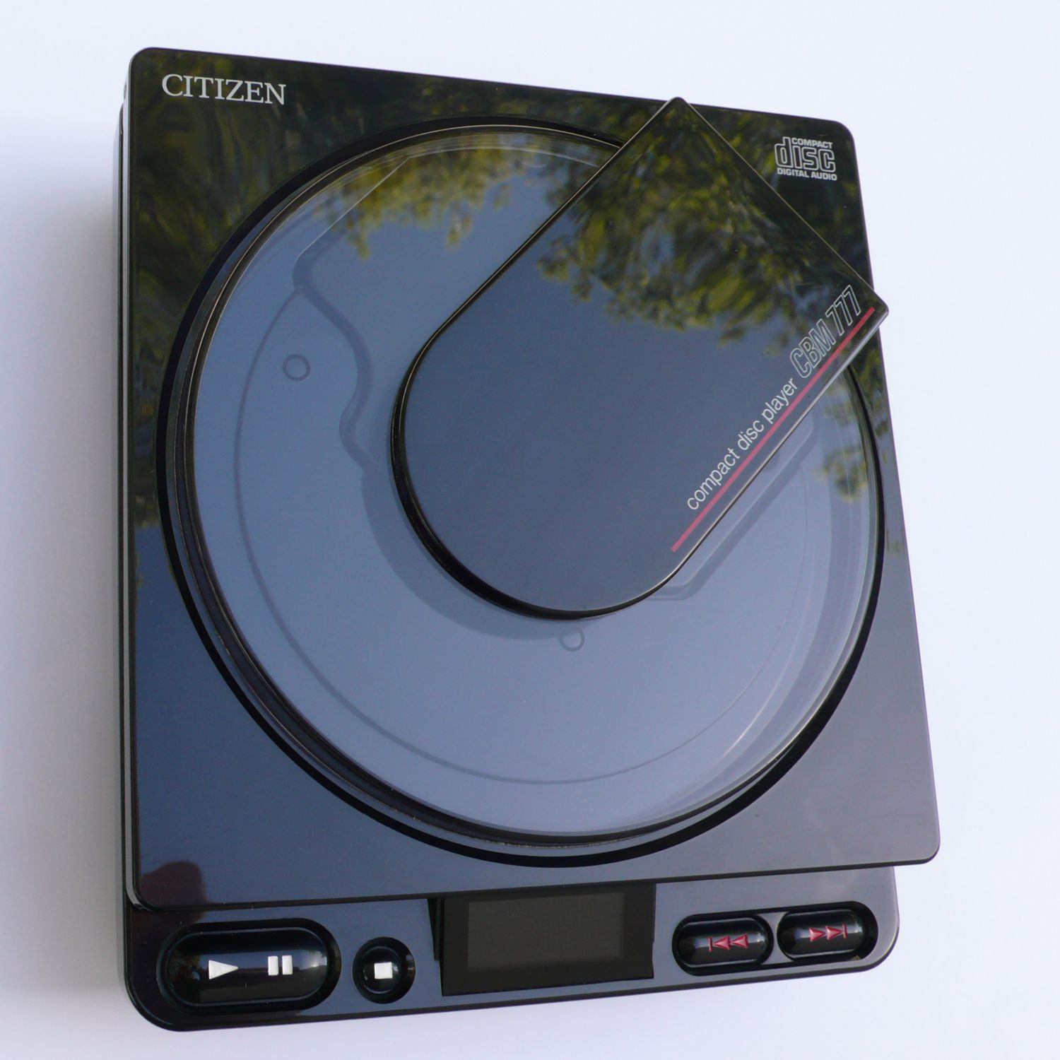

    CBM777 was a Beauty Star of my collection:
    simple and unbreakable design, decent sound quality
  8. nickelindimer
    nickelindimer Active Member
    415
    Chicagoland

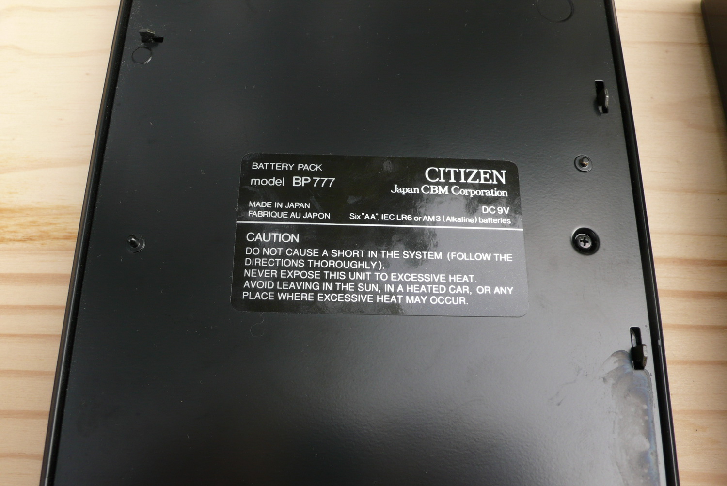

    Agreed... the CBM-777 is durable (Mine still working before storage in a zipper bag)... but the lack of battery case was off-putting. Did either of yours include it, and was it interchangeable between them?
  9. Jorge
    1,786

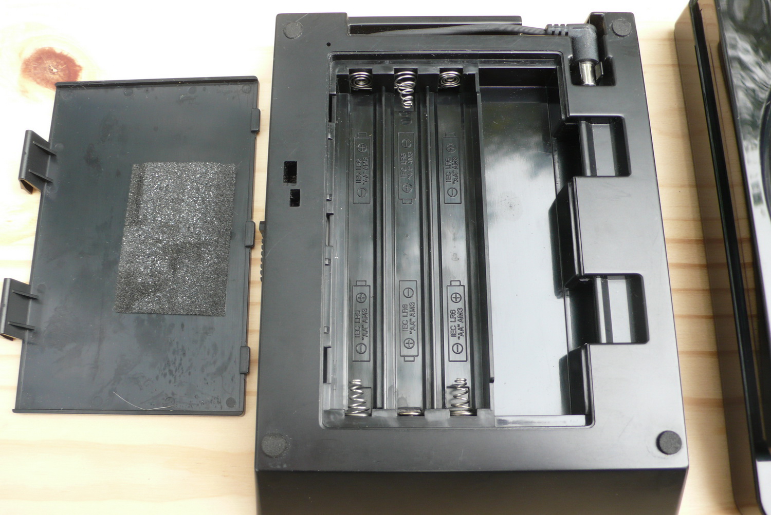

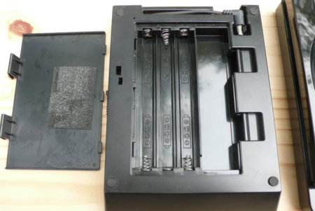

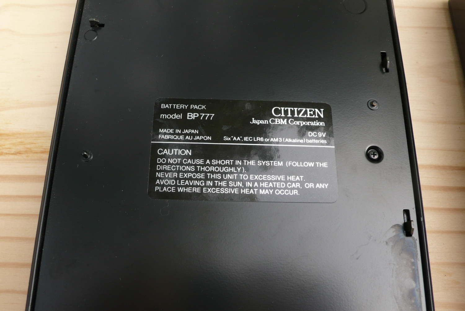

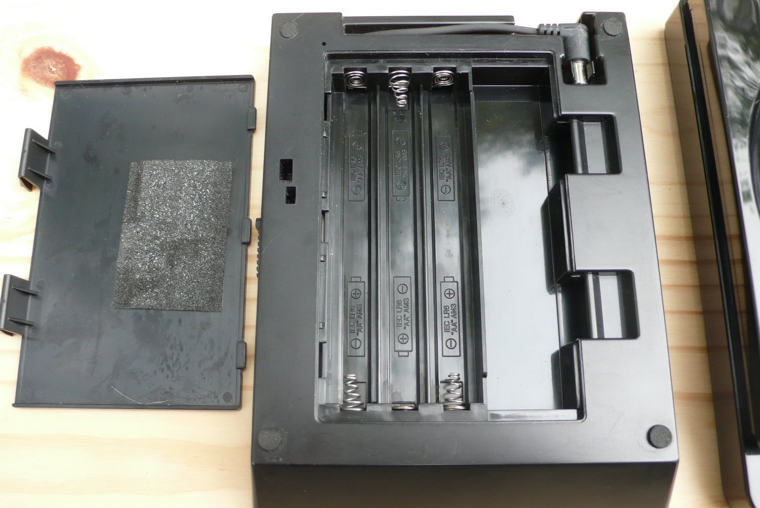

    Mine had a snap-on battery case:
    Takes six AA batteries plus extra hiding space :)
    CBM1000 had very fancy battery pack, as in the ad by @Mister X above. It snaps to the bottom of the player but batteries go into side gondolas. They did look like rocket boosters and were the main reason why I bought that player. Unfortunately, at that time I was unaware of the concept of "display items" and once my restoration effort failed/expired I never put that thing together and never took any photos.

    So that's what it looks like...?I never had one because it was an "order separately" item. Imagine my surprise at seeing I had to spend MORE money just to make my portable CD-player "portable"! And looking at it, I now see why the "feet" on my player were just little rubber discs.

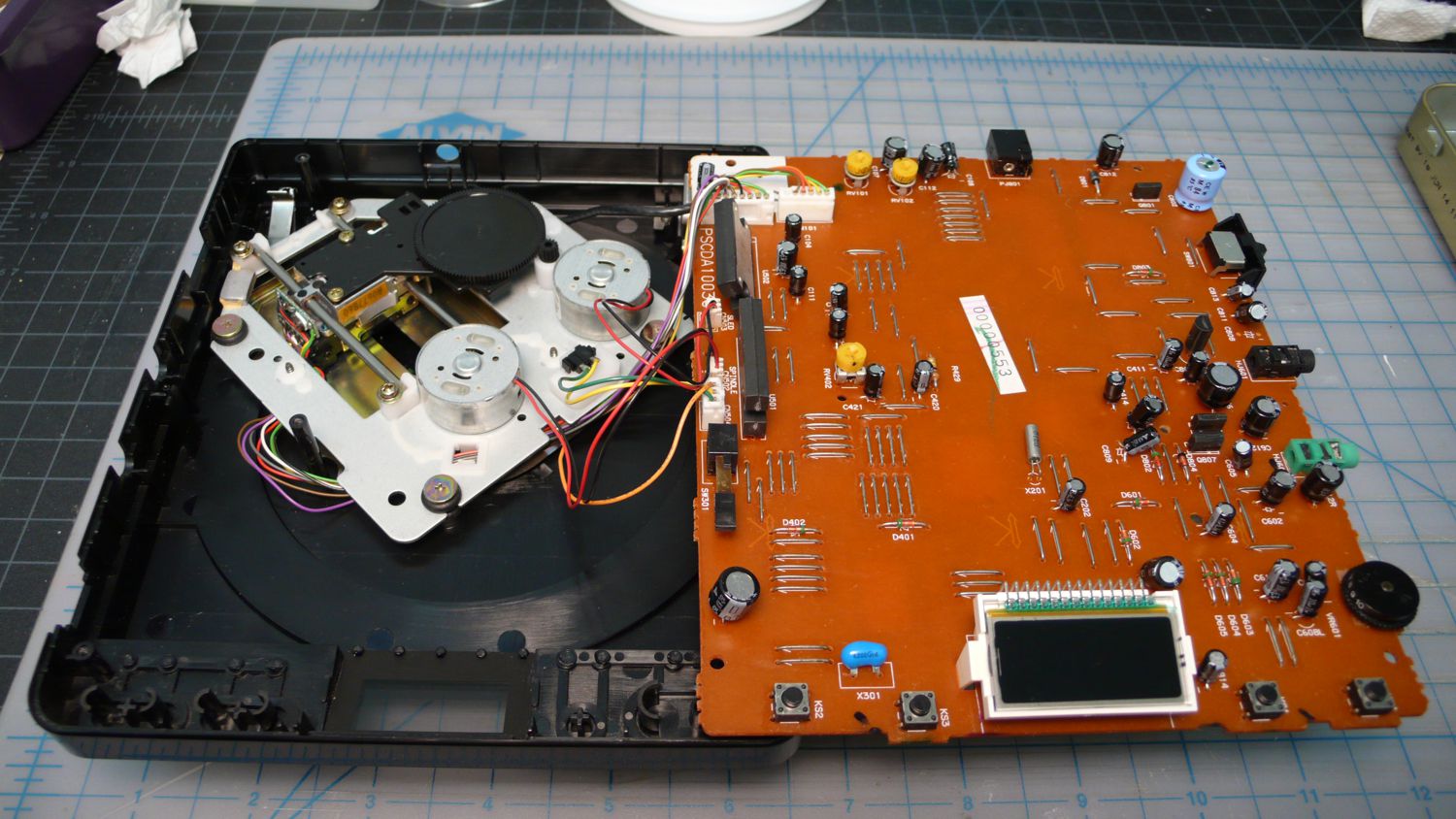

    I recently got a CBM200o, it's ok, they were definately trying to cash in on a lower price point (I think) but it was 33,000 Yen when new.

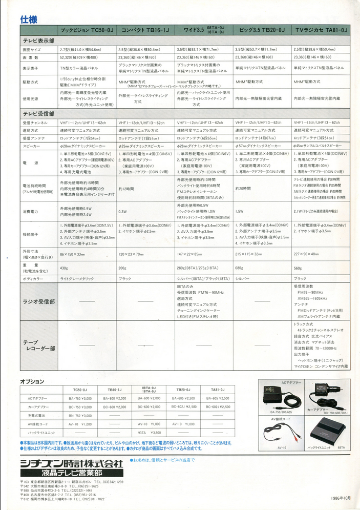

    Another cool catalog from tas66dc, Citizen 1986. They had some much nicer looking models than Sony or Casio, I think some were rebranded for Radio Shack as well. Now I know who the builder of my Trident TV Boombox is now, the TAB1-OJ on page 3. I've posted my Trident Version in the TV on the Radio Thread.
