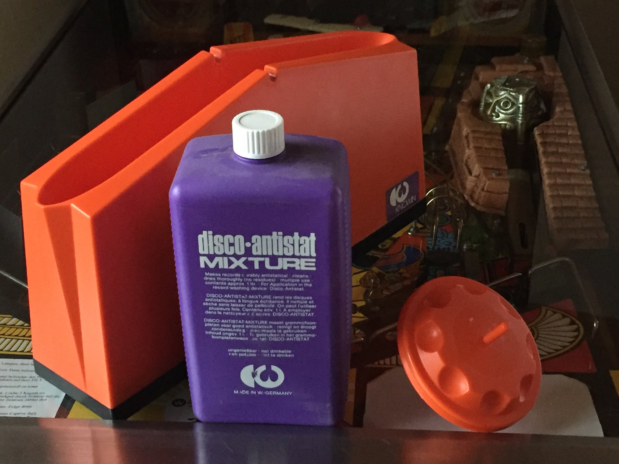

    i don't have space for an okki nokki and also enjoy there ceremony of vinyl-washing with my good old KNOWIN (today: KNOSTI) washing-machine, wich i can throw in a box and store in the shelve ( i do have a newer set as well but prefer that orange sweetheart, even fill the new liquid regularly in that vintage purple bottle :nodding: ). my shellacs get a wash in lukewarm water with a spread of fat-remover in the same machine. no need and use for a revirginizer in my house.

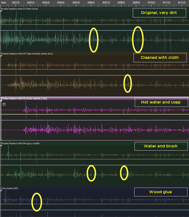

    This is a screen capture of the several digital files I acquired after trying out a cleaning method of the same disc:
    As you can see the original is very very dirty, with lots of crackles. Every vertical line crossing the signal is a crackle, so counting them you can see how many dust is on the disc.
    Cleaning with cloth effectively wipes out so many dust but still leaves residue. Wood glue is the best, as it almost leave nothing at all. There's only onle big 'dust' (vertical line actually) in the wood glue, marked in yellow. That is actually a scratch on the disc, so cannot ble cleaned...

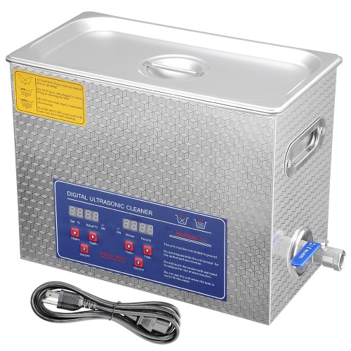

    I am looking into Ultrasonic cleaning, so far I am looking at buying a 80Khz tub as it is quieter. I am not convinced to spend over 4k on a machine, but a tub with a kit from a referral with Michael Fremer has got me thinking, what can 3400 of a difference actually be? this is a fascinating thread to me as this is where my focus will be heading now that I am happy with my setup...
    19,427
    That might be a good idea James Tervit, we have a ton of surplus over here and ultrasonics turn up every once in a while. What about something like this? You could put a wooden dowel through the center and have 1/2 of it submerged and just spin it by hand.
    I just found the size of the tank, Tank Size 11 3/4" L x 6" W x 6" H. Records are a hair under 12? but I bet it would fit at an angle.
