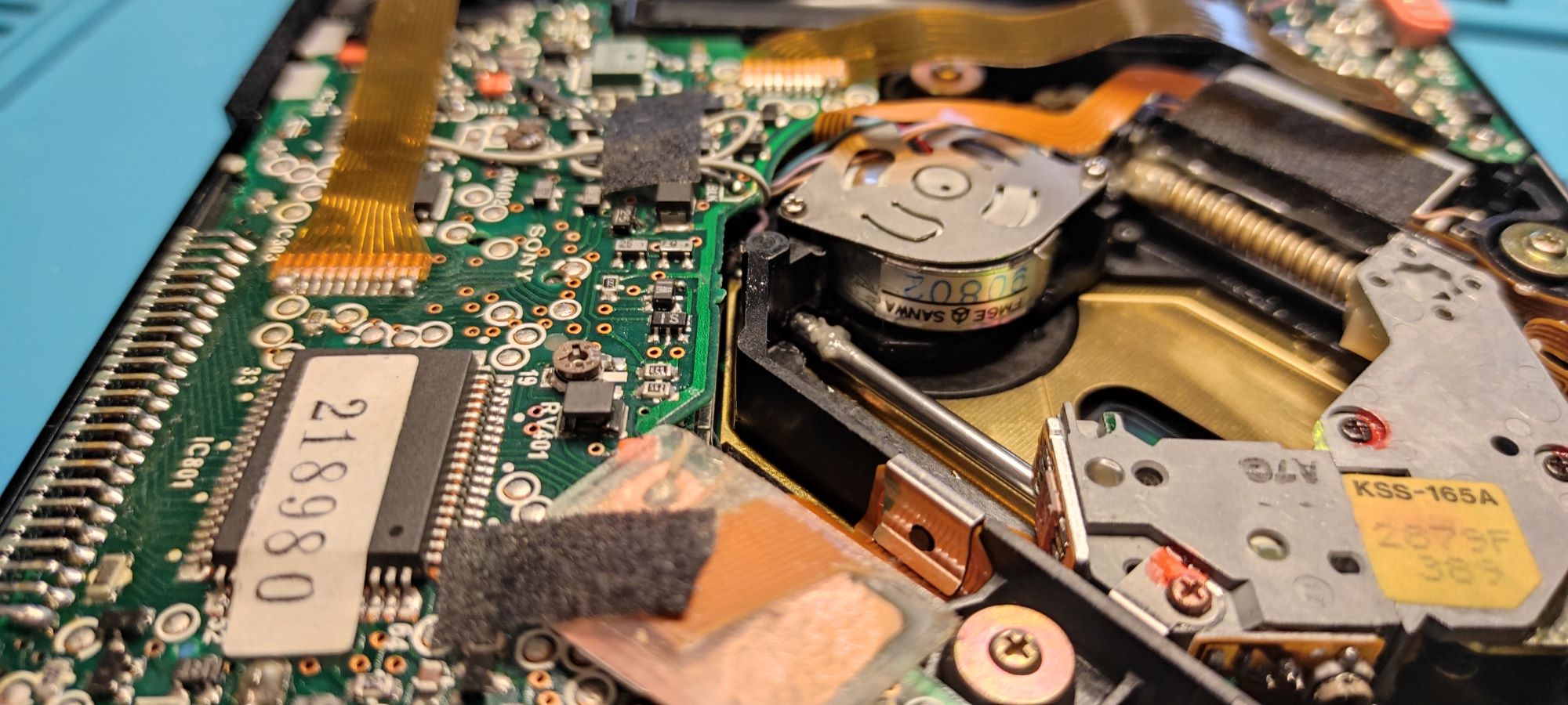

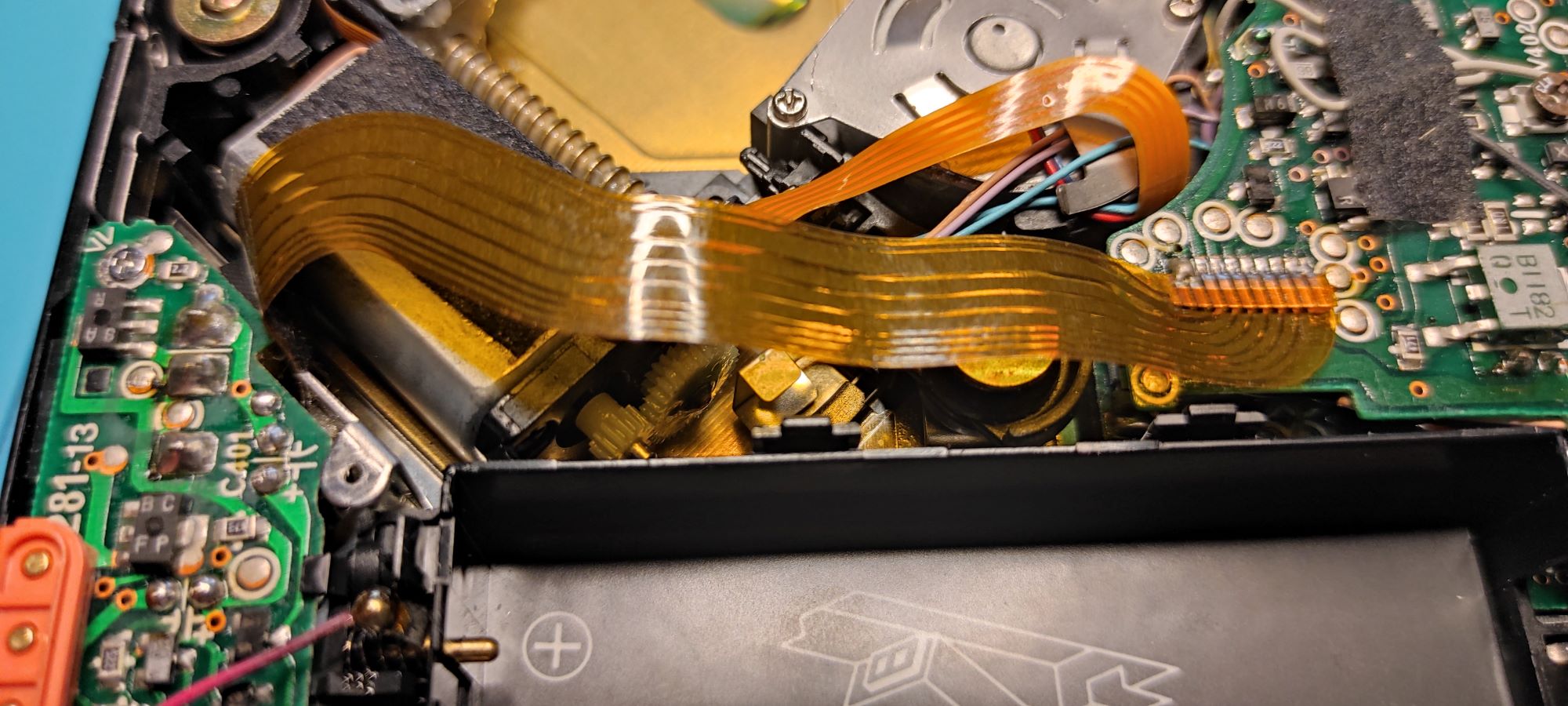

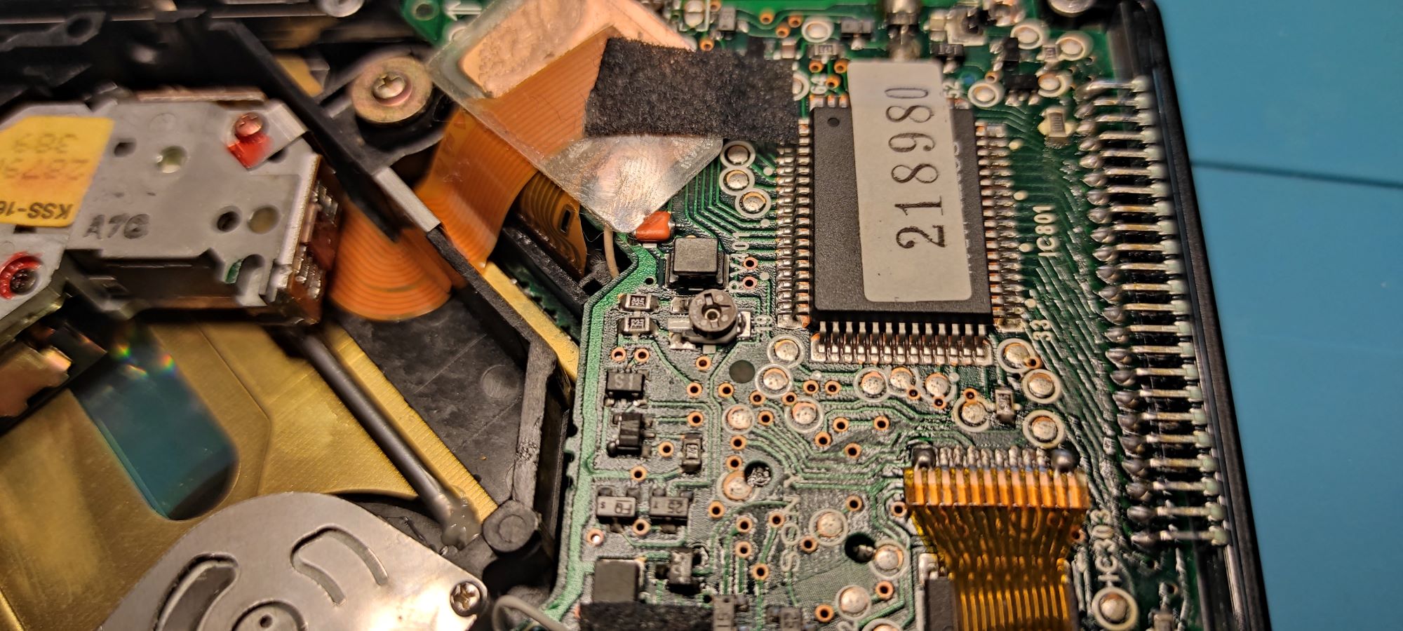

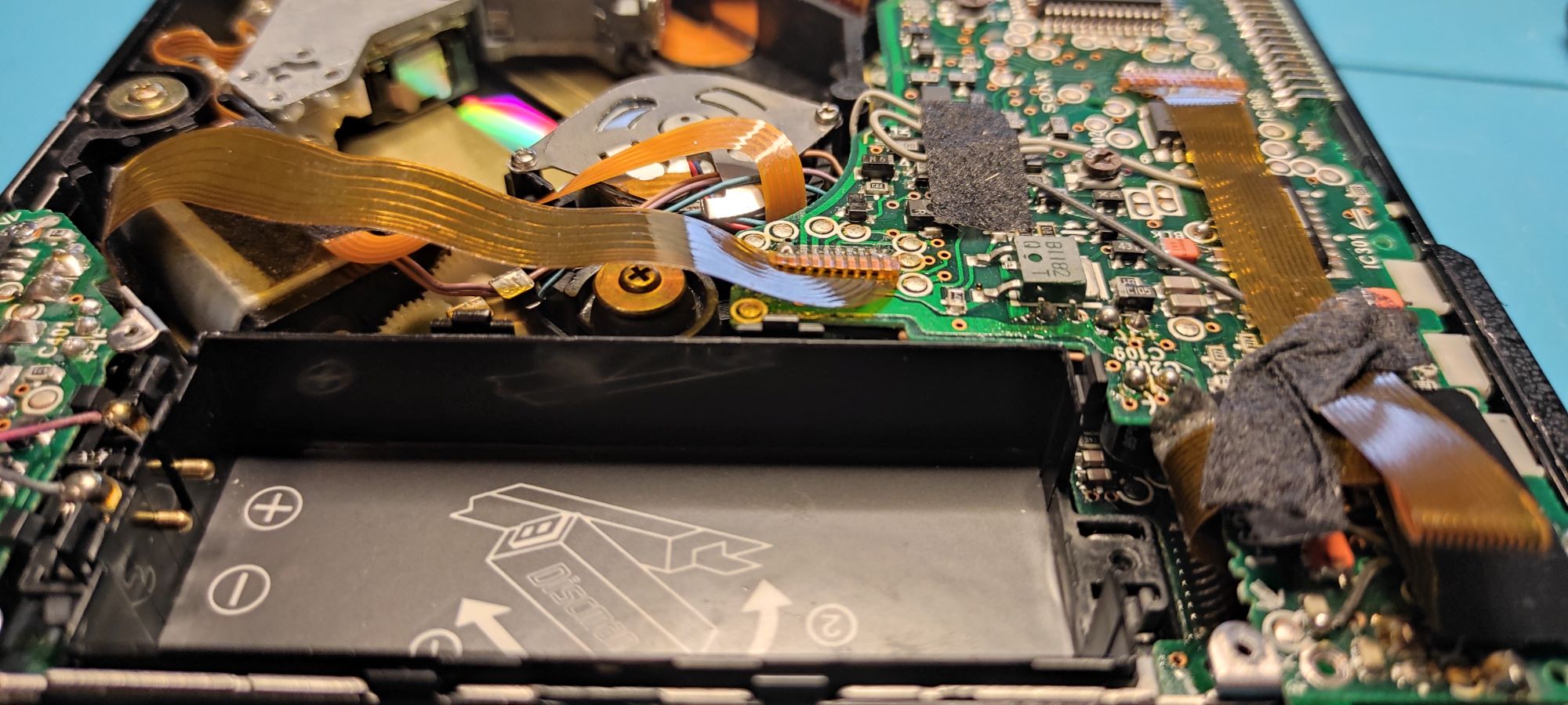

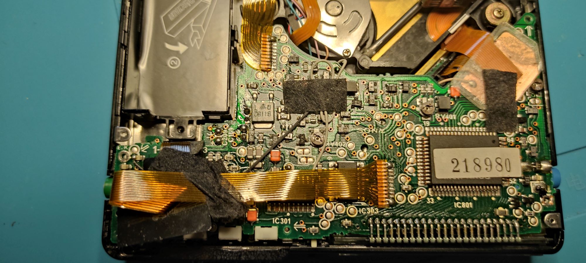

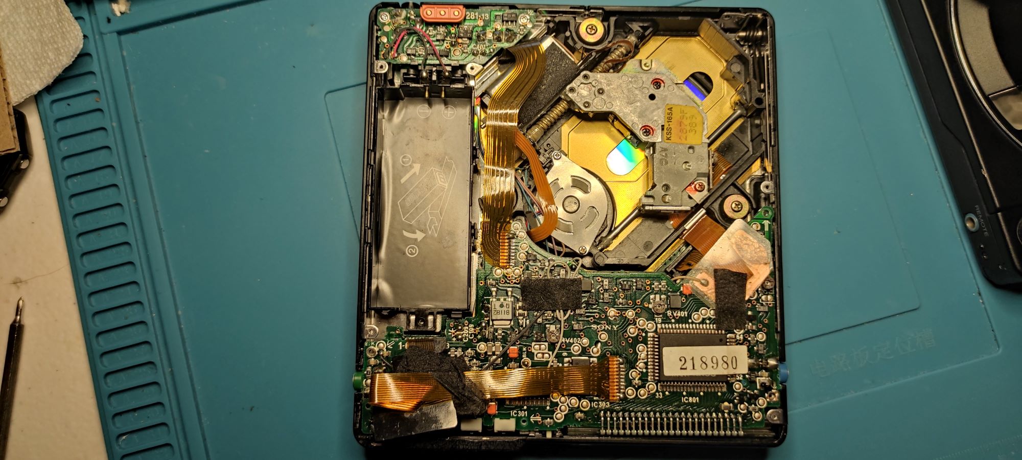

    I'm having the same problem with my D-25 unit. I cleaned and lubed the center gear and it works without problem. Only problem is that it can't read the CD. It spined and then shutoff. I managed to clean the second layer of the pcb board and got it to read and play CD. But once I put the boards together and ready to put everything back, it went back to the same problem. Just not gonna read a CD again. So I'm back to square one.
    I was wondering what else can I do?

  6. Valentin
    1,367
    If the device works when the 2 PCBs are separated you need to investigate why that happens.
    Something is either shorting from one board to another, from a damaged wire to a PCB or there's some connection that breaks open due to pressure.
    Can't point out where your problem is, you need to investigate that yourself. But start with the basics:
    1. Does the laser move to ToC position ? If no, the sled motor doesn't get power, so look in that direction.
    2. Does the laser turn on ? If no, look at the circuit powering the laser.
    3. Does the lens move up and down trying to focus ? If no, look in that area.
    4. Is the spindle motor spinning ? It should spin quite fast a couple of times. If no, look around the spindle motor drive.
    As a sidenote, you put a bit too much oil/grease on that middle gear, don't need that much.
